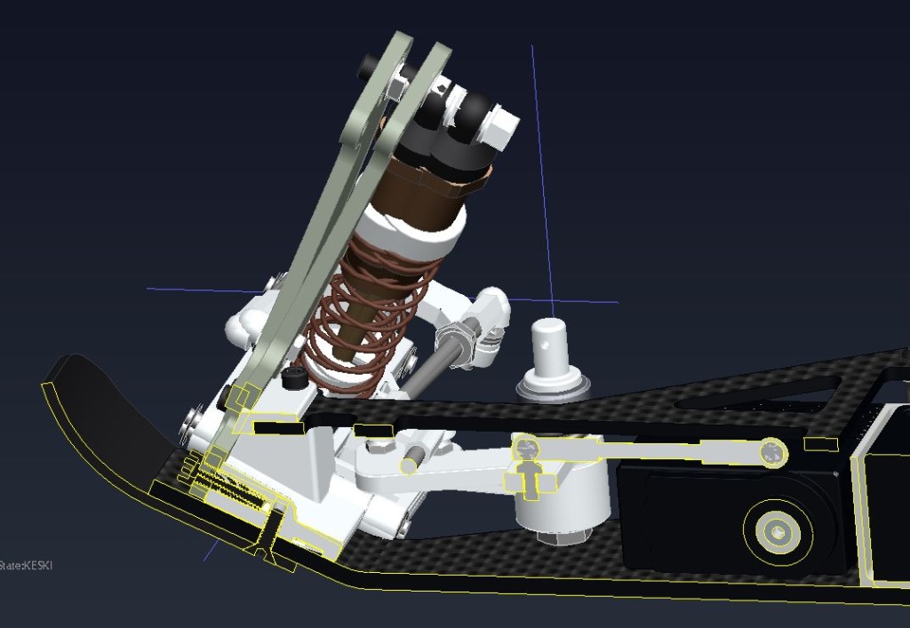

Front bulkhead difference visualized... it's 7mm in tower end.

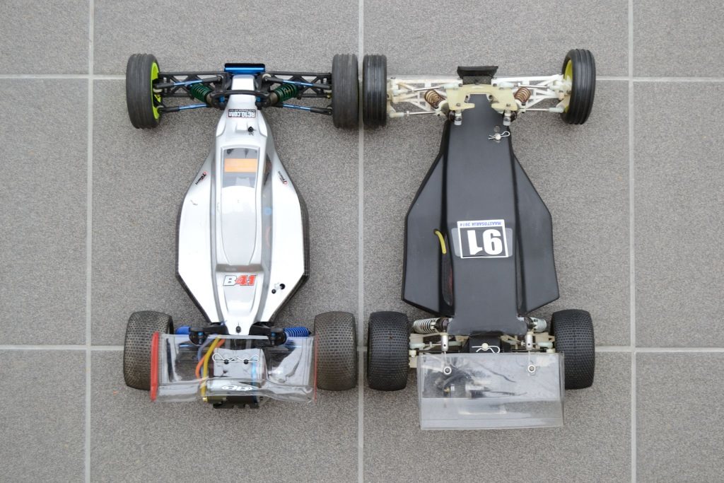

You might find these pictures interesting. B4.1WC and NIX91 side by side.
Front rims 1" wide on B4 and 3/4" on replica.
Rear toe-in 3deg/side on B4 and 1.5deg on replica. I don't have 3deg mounts yet.

In the horizon podcast from 2010 cliff said the '91 became the b4 so they should be really close. I'd expect slight variations on nose and arm width. The box description for the b4 references the '91 car. The b4 looks like a '91 with shorter shock towers/ shocks. It would be cool to create a hybrid; b4 parts on a dual deck cf chassis 8)

Look at the wheelbase and geometry... Alomost identical. Makes you wonder though why it took so long to make a production model from the '91 car.
Personally I would love to see the B4 (.1 & .2) in a double deck carbon chassis.
