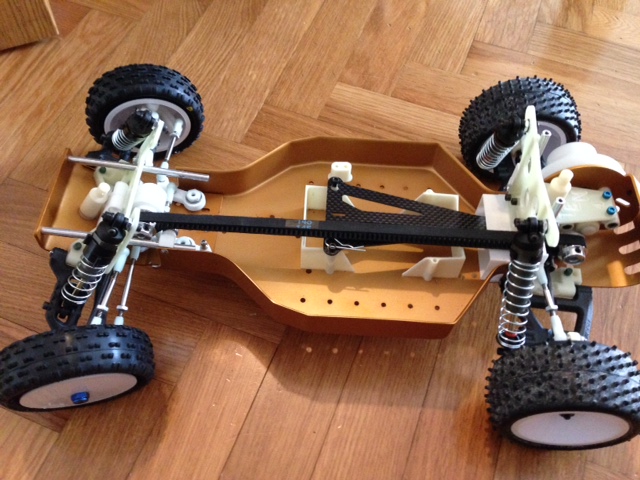

ra272 wrote:Do you think it could be harmful for the belt or The pulley ?
I may just reduce the braking power.
Do you think it is possible to make tigher 3d parts for the steering?
Sorry to hear your steering is sloppy. Unfortunately that is due to variation in Shape ways printing the parts. I can tell you that all the steering sets I have had them print have fit the bearings nice and tight.
If it becomes a consistent problem I can tweak the part model so the bearing hole is a little undersized, and then they may have to be reamed a little to get the bearings in.
Which steering set (what input) are you running?
ra272
Posts: 312
Joined: Fri Nov 17, 2006 9:32 am
Location: NANCY FRANCE
Been thanked: 7 times
Re: Ten4: the 4WD RC10 project
Post by ra272 »
Don't be sorry, your parts are fantastic. I love the integration of the front gear case.
I have found an easy fix: a thin coat of cyanoacrylate glue inside the part. It sticks and blend very well on the porous 3d nylon.
The other steering part required two thin coats. The inside is now shinny and the bearings have now a very snug fit. :P
I also used a longer ball stud, for better rigidity.
Last thing I made today is to install RPM rod ends. The slop is almost gone, I even put the ball bearings back. :P

Nice work. I should do that to my car at some point. My cranks have enough play that it could bind in places.

Nice fix!

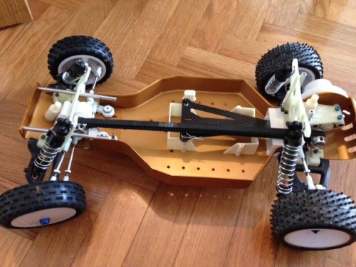

Thanks, I made a little carbon stiffener for the chassis to keep the belt in tension during hard braking. It's interlocking in a notch that I cut in the front nose tube, and at the rear its bolted between the chassis and the bulkhead.

Nice work!
