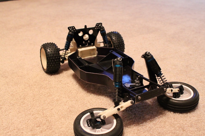

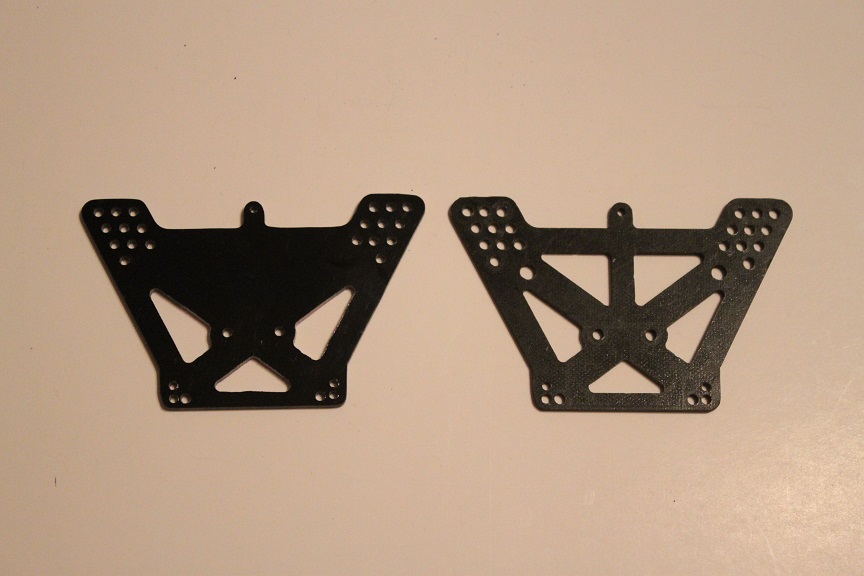

Well it's up and running. Sort of. There is some learning to do and some tweaking. The first part I tried messed up. I forgot to secure the arm from raising and the pin rose up. Needless to say that one came out a bit off! The second part was this one, a JRX-Pro rear shock tower. It isn't perfect. I may need to try a couple of different cutters since this one jumped a little bit. I also have to learn how fast to go as there were parts where I tried to go a bit too fast. The part that took the longest was drilling the holes on the drill press. I left this tower solid on the top half since I plan to drill holes for B4 rear wing mounts. Anyways, the fun has begun. Now it's time to get all the little things adjusted.

Post by fredswain »
I think the parts would come out better and wouldn't require nearly as much pressure if I cut out around the part first with a jig saw or bandsaw. When routing wood parts I always cut the piece out just outside the template line so the bit didn't have to remove very much. The cuts went far faster and were smoother. By relying on the bit to do all of the cutting, it has to cut twice as much material which requires more pressure. The bit also wears out faster. That added pressure is likely to bend the pin easier. I have an old pedestal mounted jig saw. It looks a lot like a bandsaw but it isn't handheld. I'm going to start cutting as close to the master piece that I can before using the router so the router has as little work to do as possible.
It occurred to me last night that I can really have some fun. I'm going to cut out another JRX-Pro rear shock tower but drill it for an RC10 bulkhead. RC10-Pro anyone? :mrgreen:

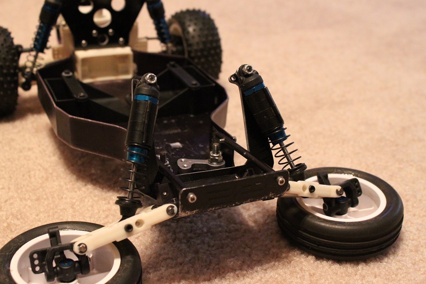

Here are my RC10 "pro" style shock towers since the rear is a hybrid of a JRX-Pro tower and an RC10 tower. I actually messed up the rear. I was going to drill holes for B4 rear wing mounts but instead did it like the stock RC10 rear tower. I'm going to use this one on a friend's RC10 anyways since he runs a wing with the stock tubes. The front tower is a world's car front tower that I made taller. Each piece gets a little nicer but I'm still not satisfied yet. I need to try some different bits.

Your getting there :D it's all practice and refining techniques. And lots of wasted g10! Lol
