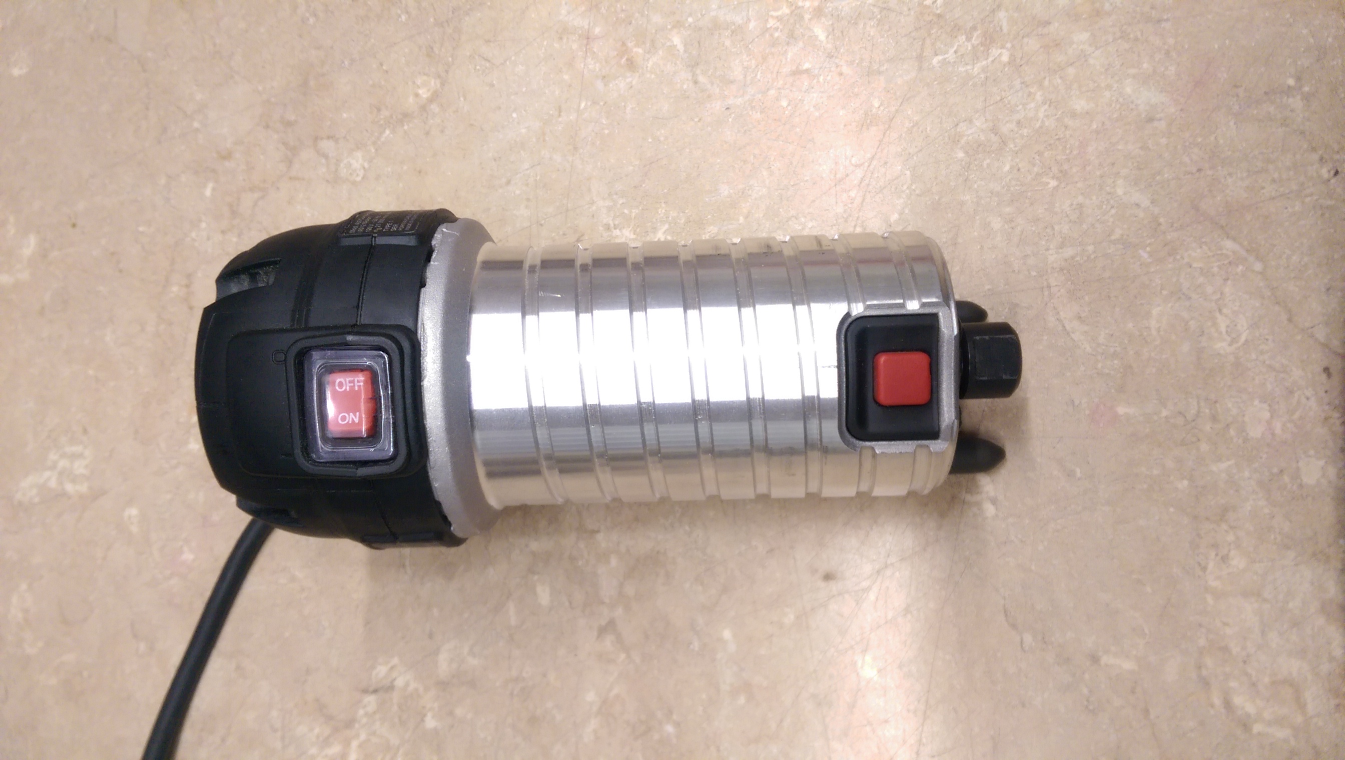

I have about a month of wait for mine to arrive so I have started rounding up the additional parts. I went with a Porter Cable 450 router. The "norm" for this build is the Dewalt version with variable speed but since I will be using a super pid it was cheaper and easier to use the porter cable unit.
And it's beautiful!

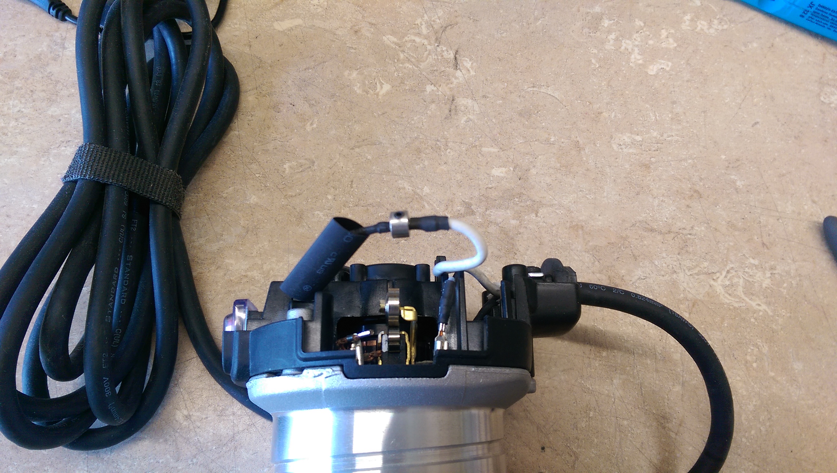

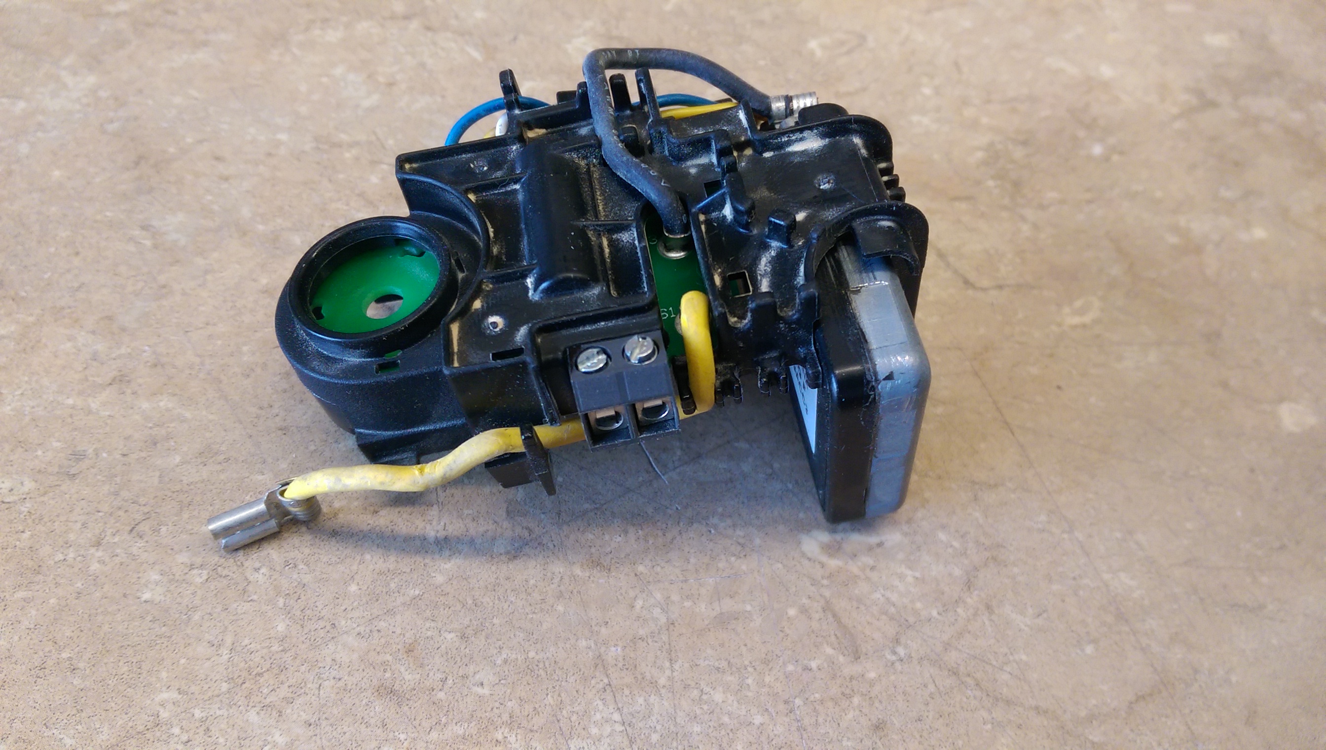

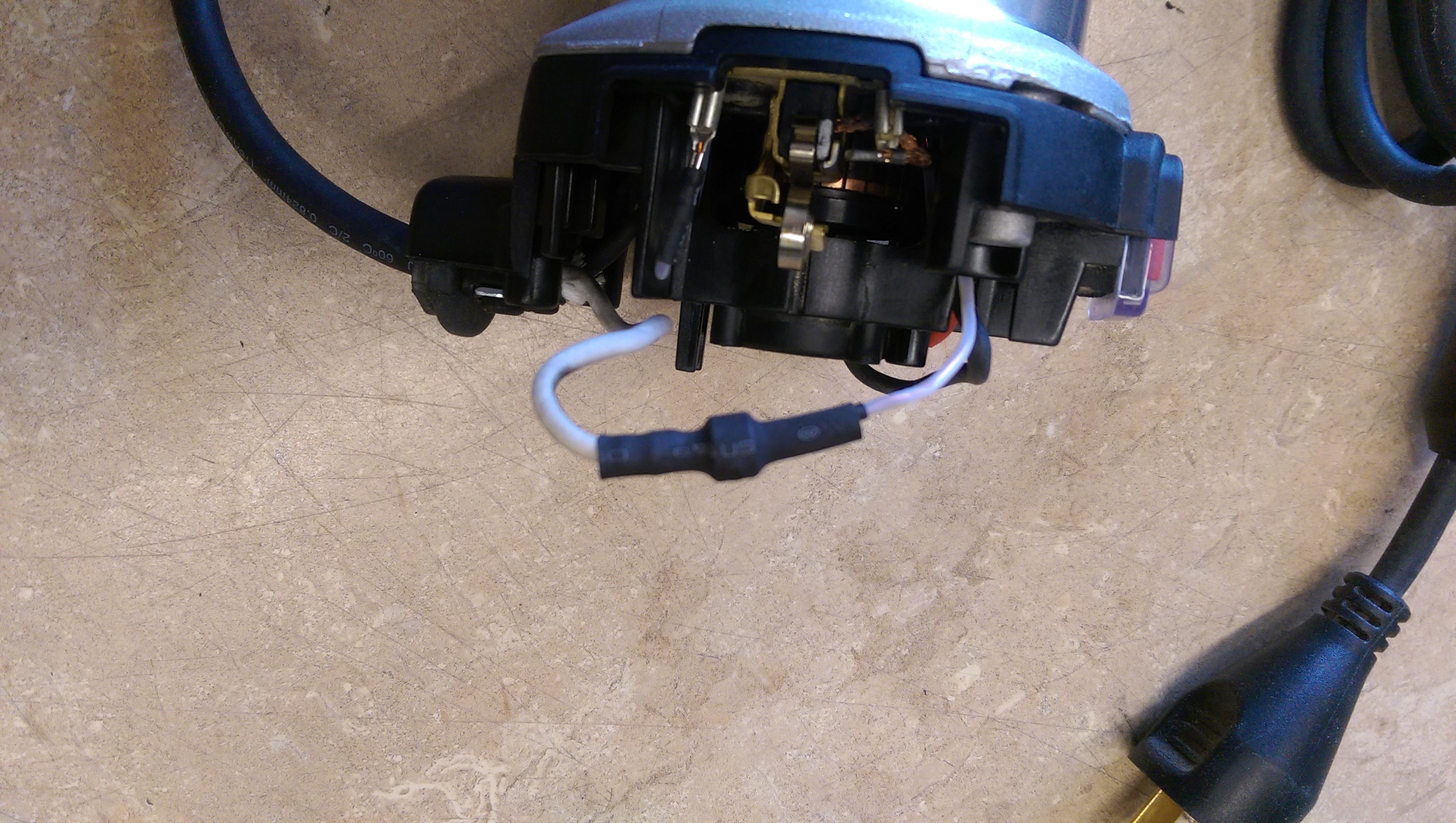

One mod was to remove the soft start. It will have a soft start thru the super pid so it's redundant and can cause odd revving.
This entire module comes out!
The wires have a crimped end, the easiest way to attach was with a dura collar!

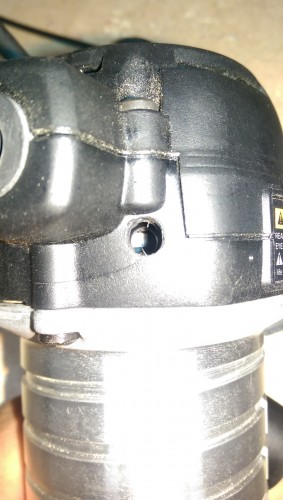

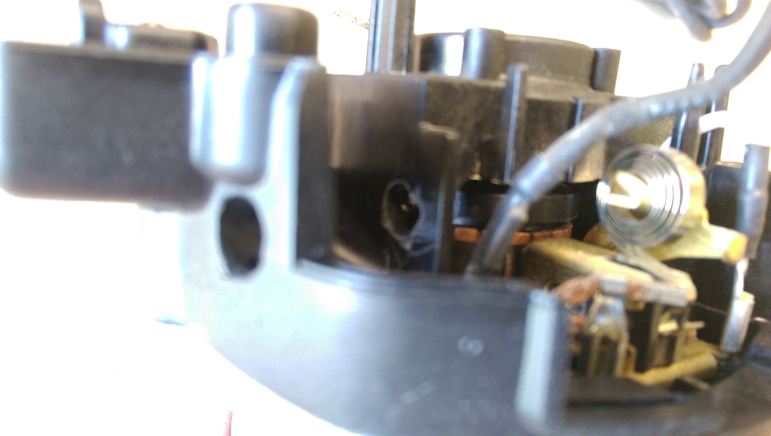

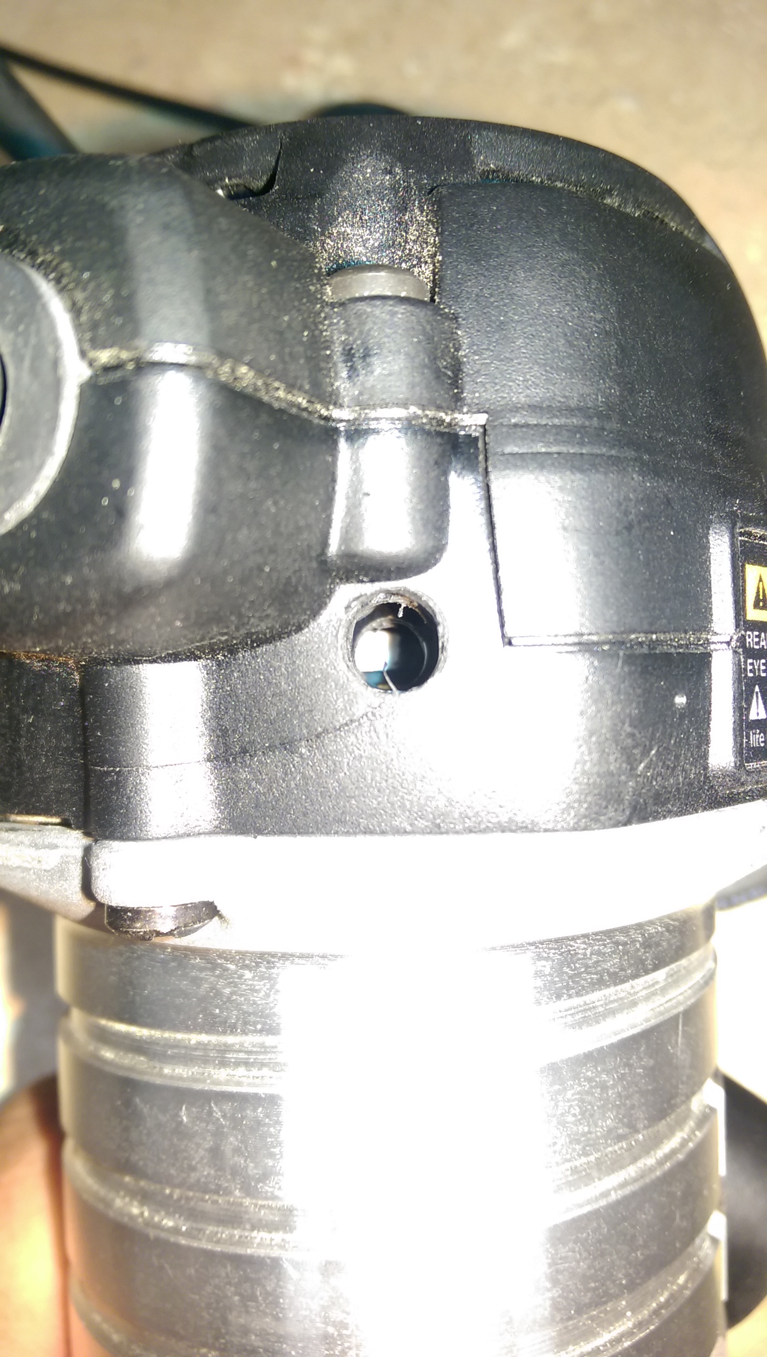

Also the super pid requires a white area on a rotating surface for closed loop speed control feedback. I used the area above the commutator and drilled the case for the tube that holds it
You can see the white spot thru the hole

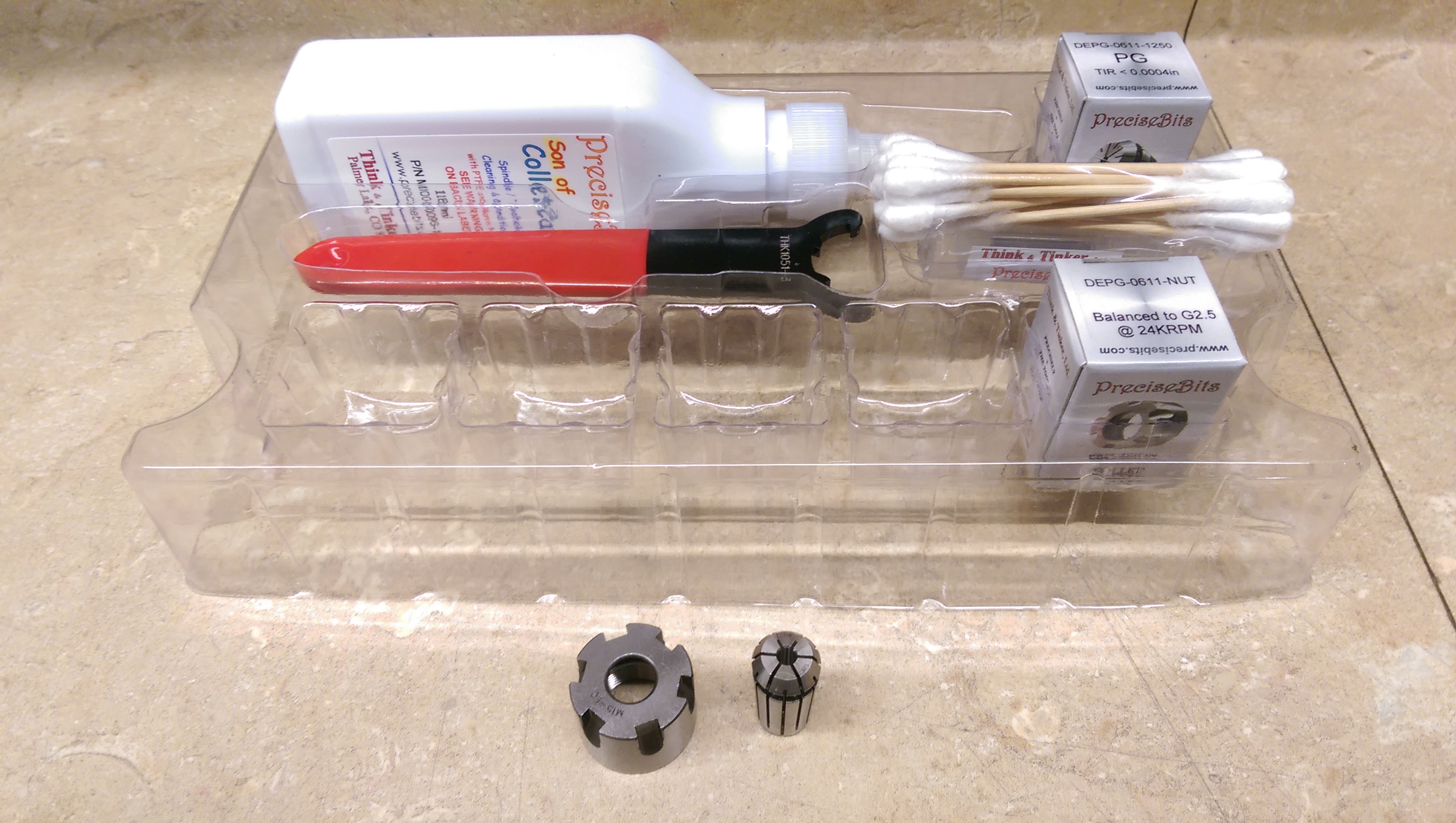

Next on the list is the precise bits collet. Sure I could run a cheap 1/8 to 1/4 adapter sleeve but these precision collets are a thing of beauty. They come in a few different tolerances, I went with the basic set. The kit comes with some collet care cleaner and conditioner. I guess we will see how dedicated I remain after its weekly cleaning.
