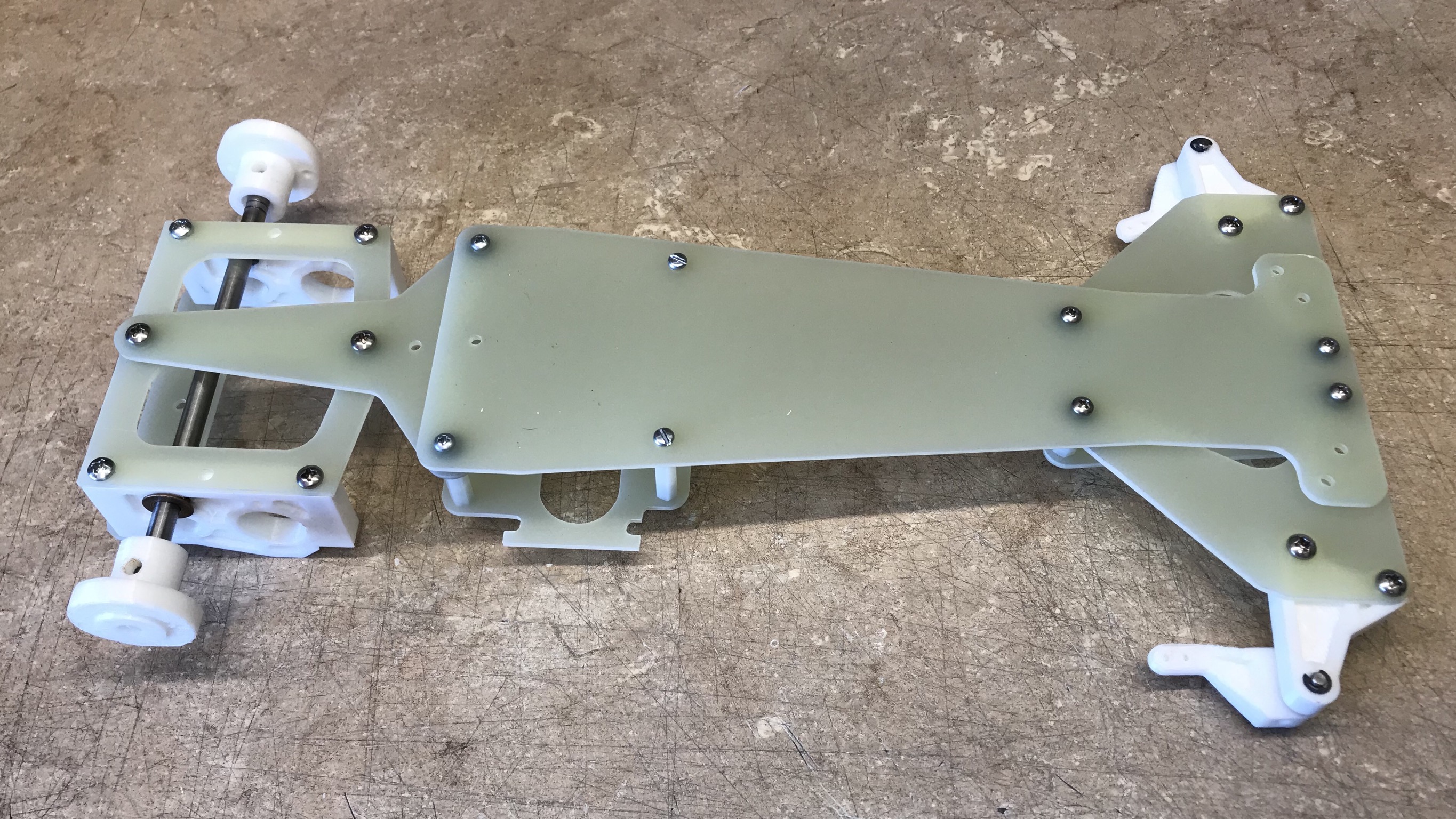

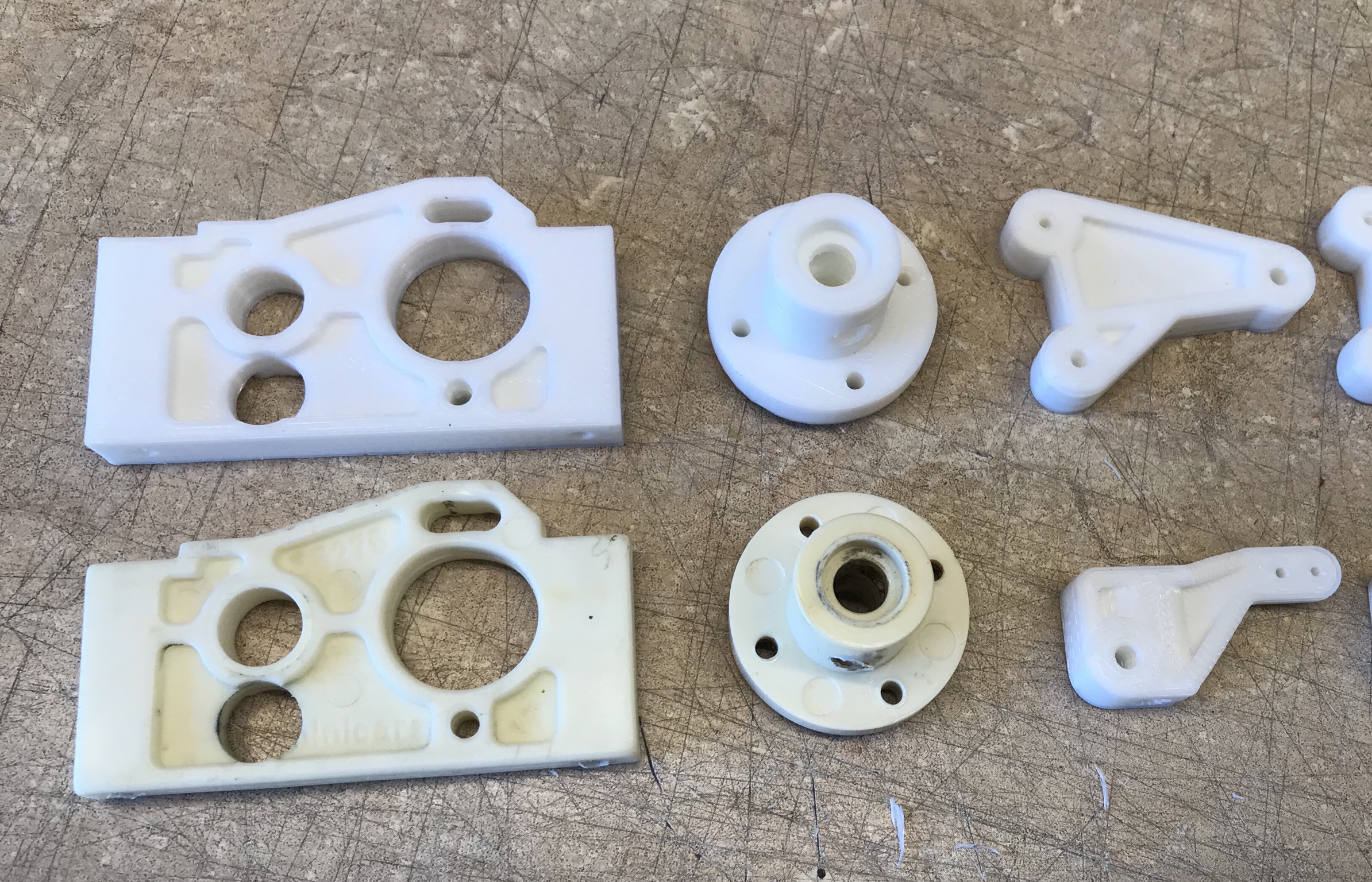

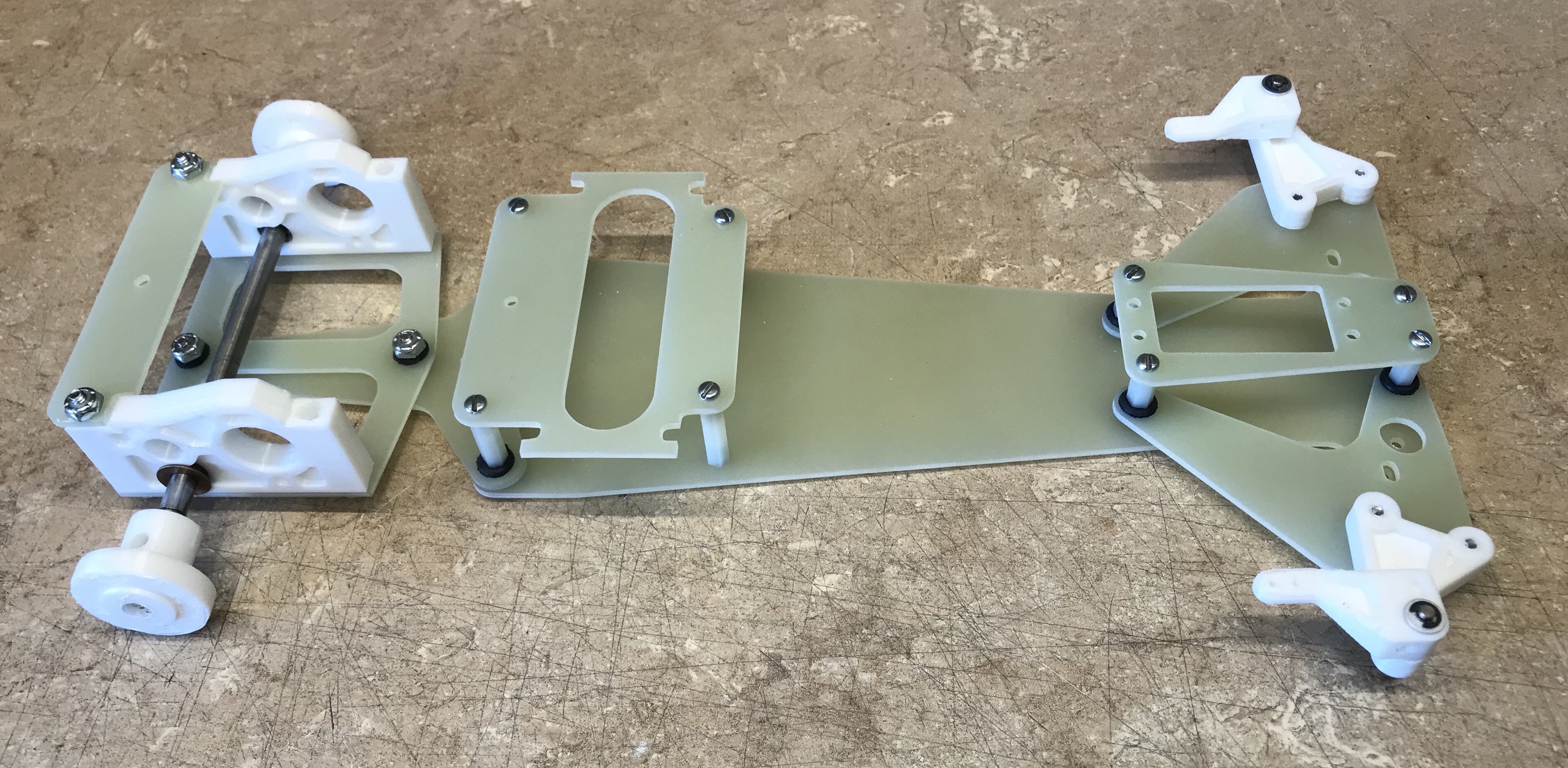

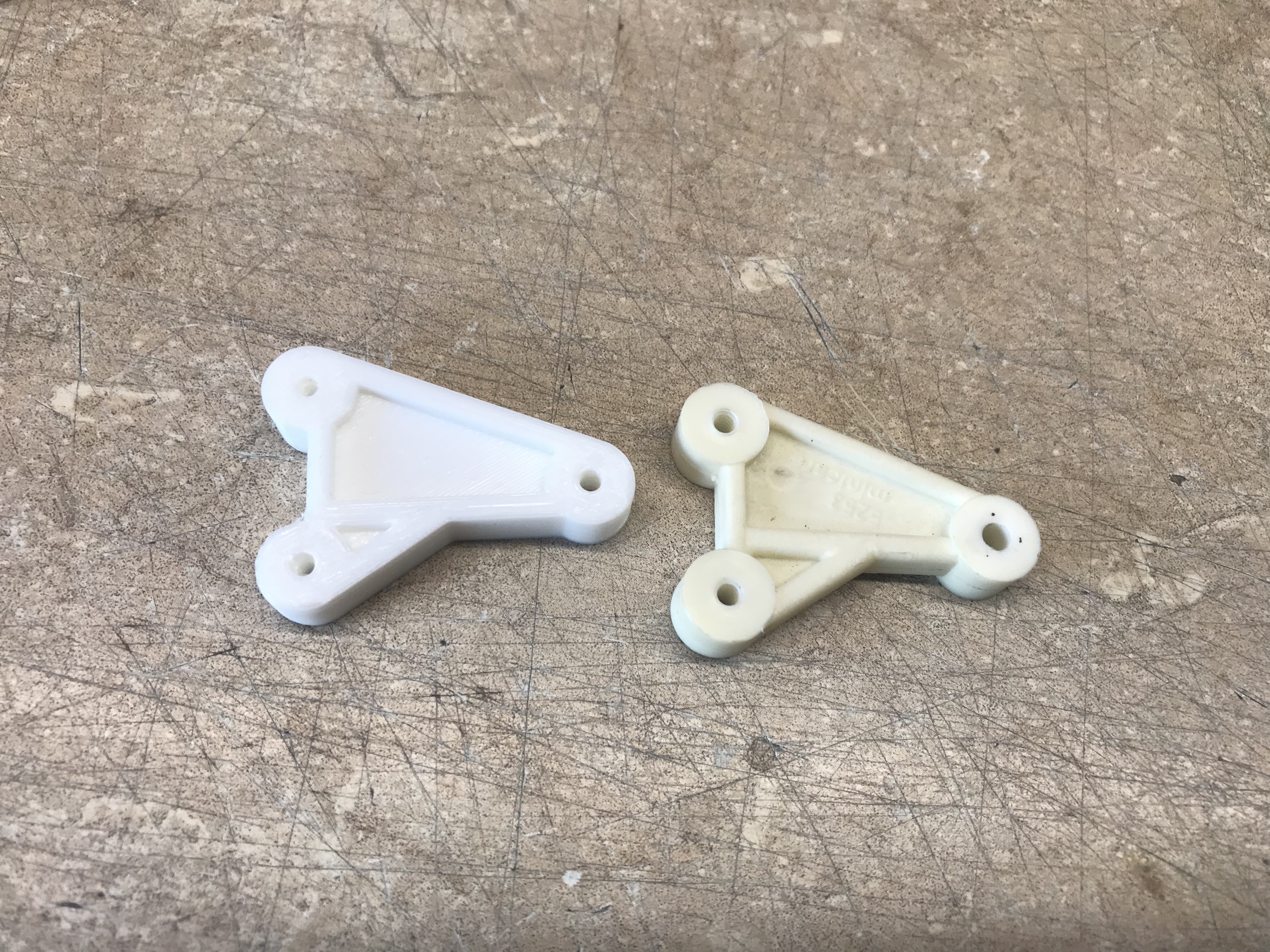

On to my first parts. I drew up some Bolink/MiniCars pieces to use on a Schumacher Digger 10 build. These are the first parts I’ve built from the ground up without help. They have been great building blocks. I haven’t printed the wheels yet- I drew them as 2.2” but in the standard Bolink styling. Anyway, here are some pics

I think a 3d printer is going to have to be my next investment , those parts look really good well done .

Wow! Those look really nice. I tend to shy away from 3d printed stuff because of the rough layered look of the parts, although shapeways puts out some nice stuff. Yours look great though! Nice clean edges and smooth contours. Those are some of the nicest parts I've seen. What material are you using? Are the parts cleaned up or is that how they came off the printer bed?

the parts came off mostly like they are shown, although I do drill them. I printed the parts with support so there is some cleanup needed. The support is a real pita to remove, so I may just try without on the next parts. These are printed at draft quality as well, so im quite happy with their appearance. They are just printed on a cheap $140 Malyan printer using Rock Space PLA from Amazon. I bought a spool of black for around $17, and they sent a coupon for a free spool just for leaving a review, so I did- and got my free white spool.

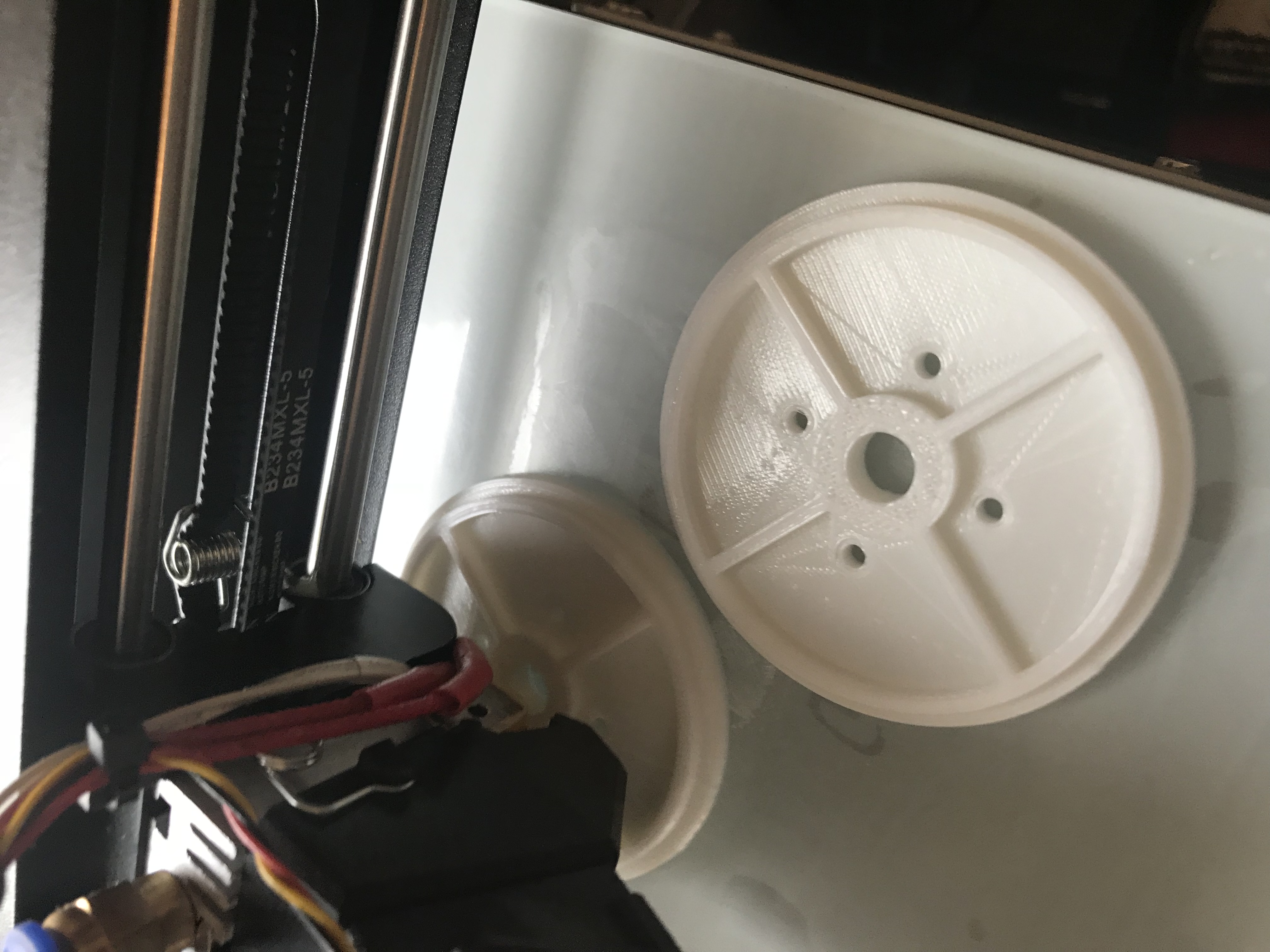

Wheels are underway. Going to be interesting with no support for the beads. Watching it to see how it goes.
