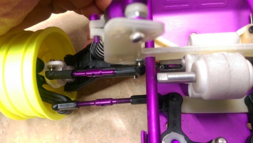

how about mounting the turn-buckle on the front, but then there's no room for the shock
unless the shock tower was wideee...... :(

I tried that already and Jeff quickly reminded me about the shocks :P :lol:

Caster blocks with offset ball stud mounting. This should solve the steering interference

That would be the left side, right ?

SnoopMaxx wrote:That would be the left side, right ?
Yup! 8)
