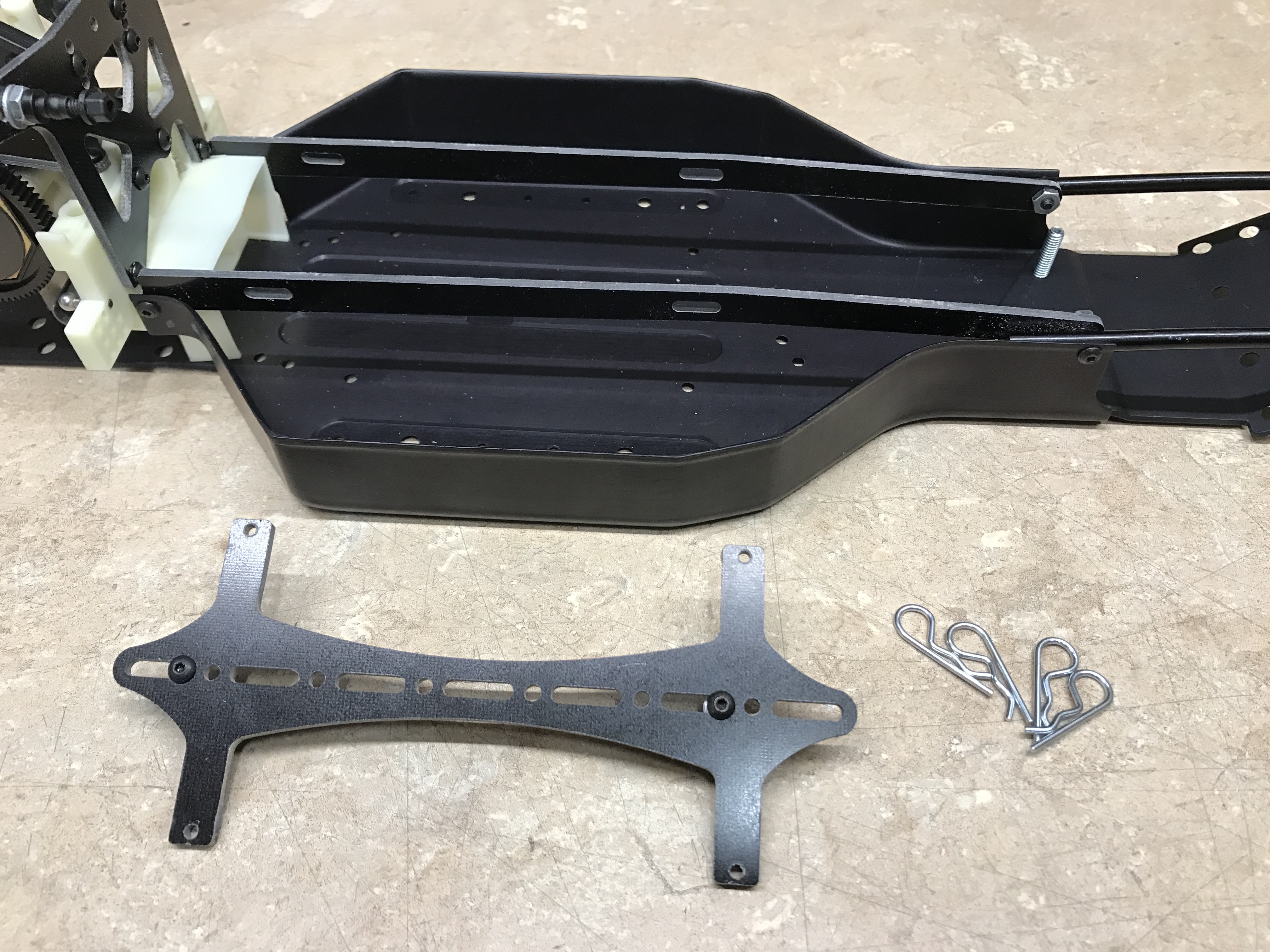

There are a lot of other options for securing the packs. I make a few different setups for them, for example this one that is a chassis brace and battery holder combo. No drilling but you do have to trim the bulkhead slightly. Much better fit for lipo

The area that bolts to the sides of the chassis, just trimmed back so the braces will slide between them

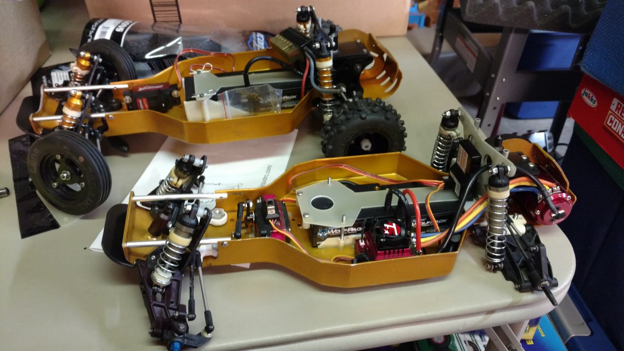

I used something a little different for a stick pack. I had a beaten up battery cup so I trimmed it down to just a base part. you could easily just trim the front out of a good battery cup. Then made a top plate that has some standoffs attached to stop the pack at the top. Using two, this will work for a lipo pack that has front exiting wires. if they are top exit wires, the top plate can be modified to avoid the wires.
worked beautifully at VONATS and there were some spectacular barrel rolls and crashes on my part due to lack of driving skills.
the front car has the brace I am talking about. the battery box holes are original. The rear car had the battery box moved forward about 1/4"(new holes)
