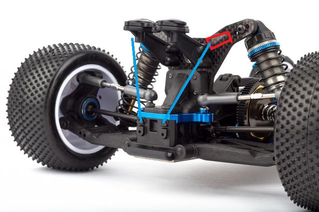

I found the dreaded weak spot of the B6 last night :shock: :roll: . Yes, that is my transmission case and no, I didn't really "wreck". I came off one of the table tops a little off to one side and one tire landed on one of the pvc pipes that go around the track. Theoretically, this kind of damage shouldn't happen since the car will bottom out before it puts this much stress on the cases. But if you only put the pressure on one tire, like landing hard on either rear wheel, it literally explodes the trans cases. Not breaks----explodes! My cases ended up in the five pieces you see here plus at least two more pieces that are still on the track somewhere. Now, this sucks, but s#!t happens and a set of trans cases are around $9, so no big deal right? Except they are backordered everywhere! A fellow racer, who happens to be the fastest guy out there, took pity on me and stripped down his spare car on the spot and gave me the cases out of it. Estimated time until more cases come in, is wednesday and the race is on sunday. Only 2 cases are on their way and another guy did the same thing as me last night. Associated needs to pick up the pace. A commonly broken part on the current most popular race buggy should not be in constant backorder.

jwscab
Posts: 6580
Location: Chalfont, PA
Been thanked: 505 times
Re: Tomorrow I Race Again
Post by jwscab »
OK, I have an idea for you to help reinforce that area. Grab some rod ends that can have a screw pass through, 4 of them. You will also need some spacers, maybe half inch long? and some tie rods/turnbuckles, make up some links with the rod ends.
use an unused hole position for the rear shock, and add a long screw, the spacer, and a rod end through. Tie this to the open hole where the sway bar mount is. you will have to juggle the spacer and rod length to make sure it all fits.
if there isn't enough room using an unused shock hole, drill another in the tower somewhere. This will help tie in the shock tower to the chassis.
the design sucks to have the tower mount integral to the gear box without some more reinforcement, the gear case is pretty darn thin. remember you saw this mod here first.
a link to 11mm spacers, you will have to find what works best, but for an idea of what I am talking about:
https://www.amainhobbies.com/synergy-3x5x11.6mm-spacers-2-syn-109-311/p707364
Basher67
Posts: 1056
Location: Medford, Or
Has thanked: 44 times
Been thanked: 160 times
Post by Basher67 »
I like the idea. My only issue would be the added weight. The weight would be high and to the rear----exactly the opposite of what is gained by going to a mid motor car with a laydown trans. I'm sure I have everything I need to try it out. When I get some time later today I'll put something together, and see what the added parts would weigh. Thanks for the tip! :D
jwscab
Posts: 6580
Post by jwscab »
doesn't have to be brass. a couple of grams vs broken parts and DNF? I think I'd take it.
And hey, if it works, and other guys pick it up....call it the 'Joe mod' :D :mrgreen:

Basher67
Posts: 1056
Post by Basher67 »
I would be thinking the same thing about over tightening the case screws and causing unnecessary stress if I hadn't built it myself. I'm confident that wasn't the case. I know exactly why it failed. After fixing it, I looked over the car to see what force caused the damage. Our track has pvc pipe ( I believe 6") around the edges of the track. When I landed coming off one of the big jumps, one rear tire was above that pipe and all the force on one side of the shock tower, broke it off sideways. This is not necessarily common to the B6, but it is common to B6's on the track where I race. Normally under a hard landing, the chassis will bottom out before the shocks do, so this damage would never occur, but A big enough hit on only one rear tire turns the shock tower into a big lever which snaps off the top of the trans case. Even though the cases aren't that thick, they have a decent amount of bracing front to rear, just not enough on the sides to withstand that kind of pressure. The real fix here, is for me to keep it inside the track where it belongs! :roll: :lol: Crappy driving will test the durability of the strongest of parts. :lol:
