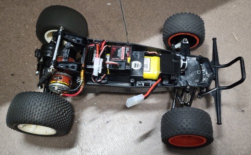

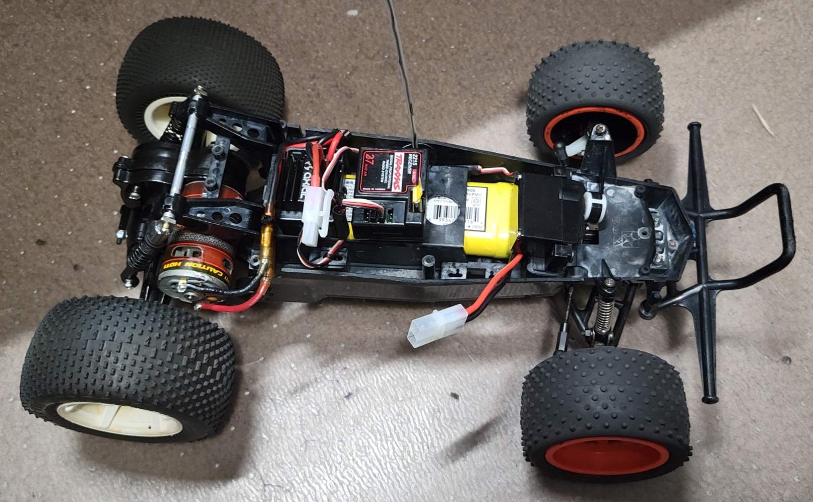

Well, it's a runner now.
Went by the LHS for some paint and they had a pinion. So I put the esc and receiver in and turned the motor leads 90°.
After charging a battery, I made a few laps through the house and around the living room.

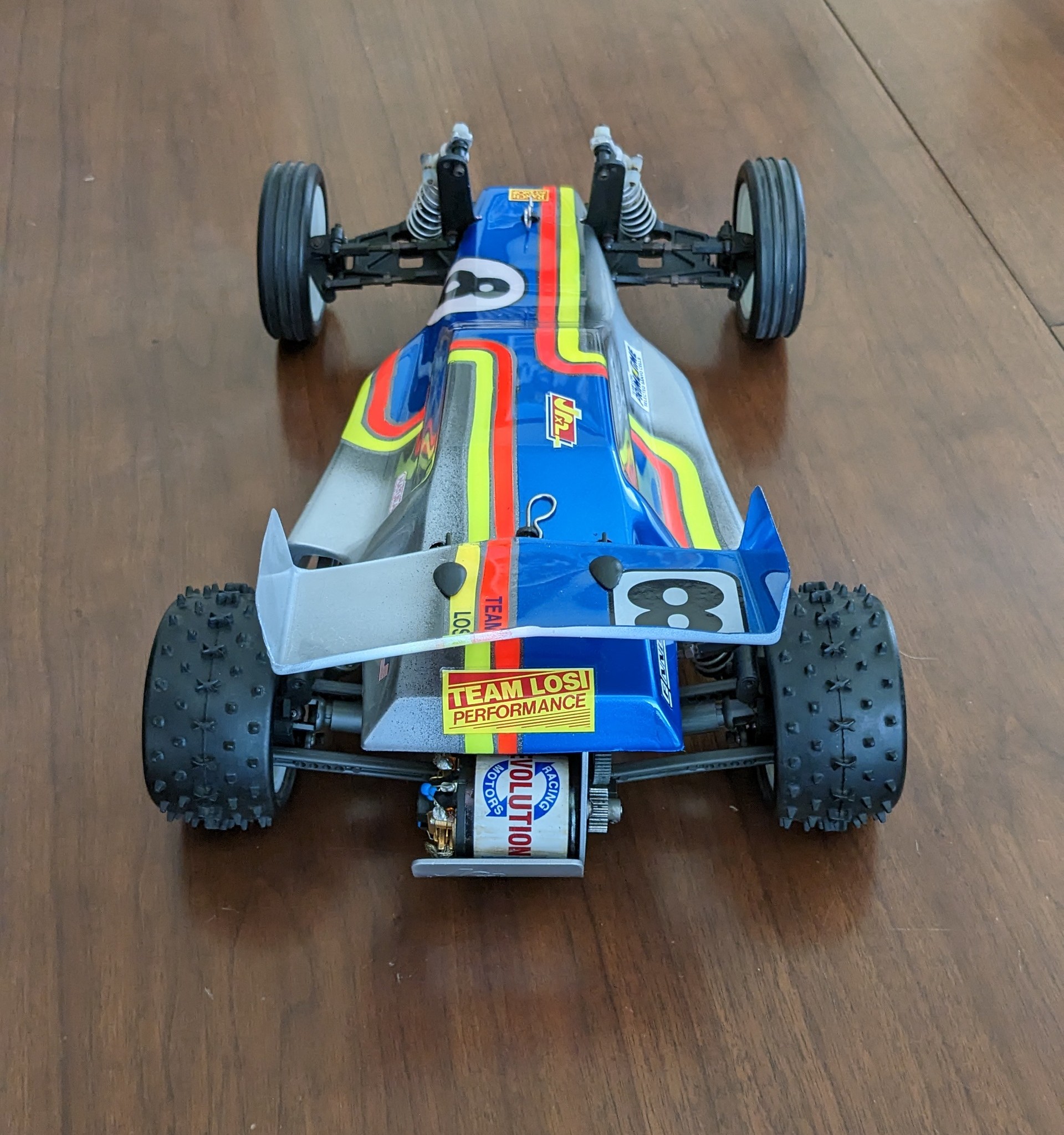

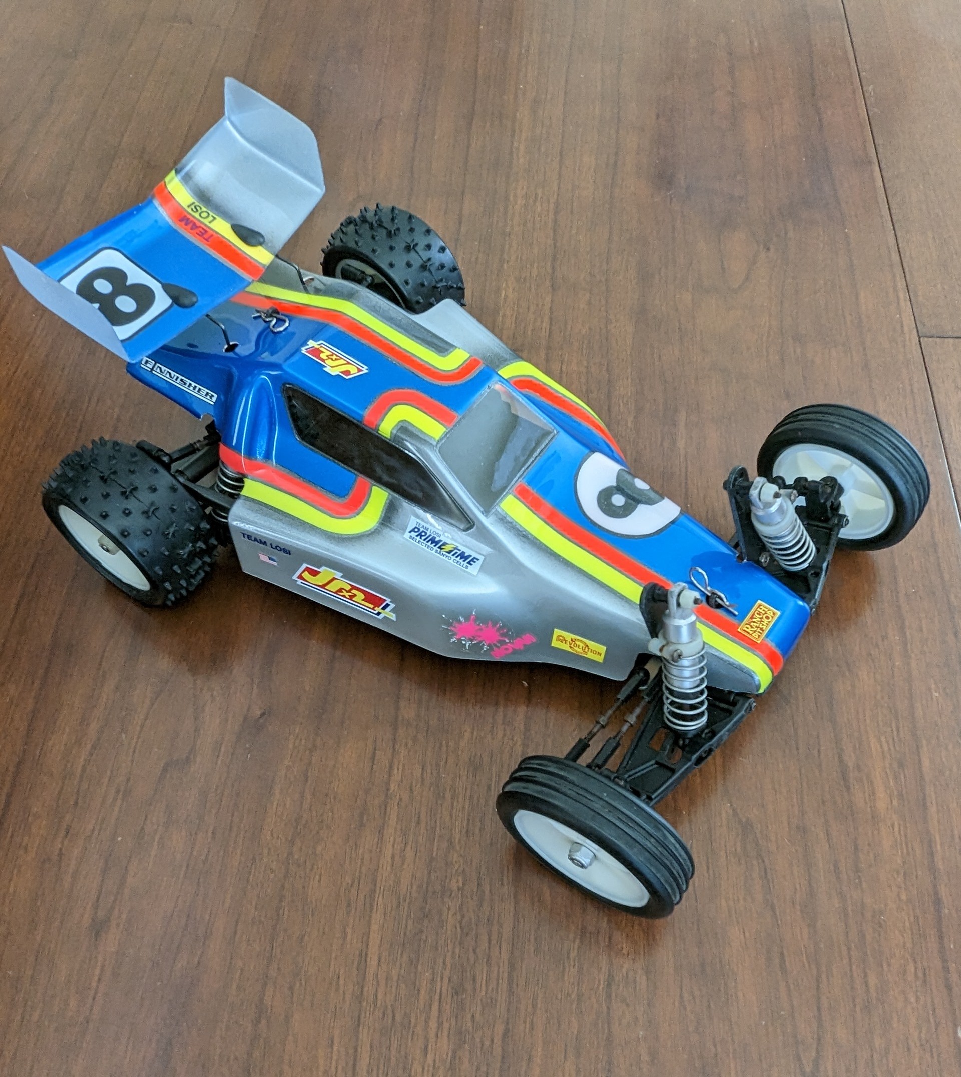

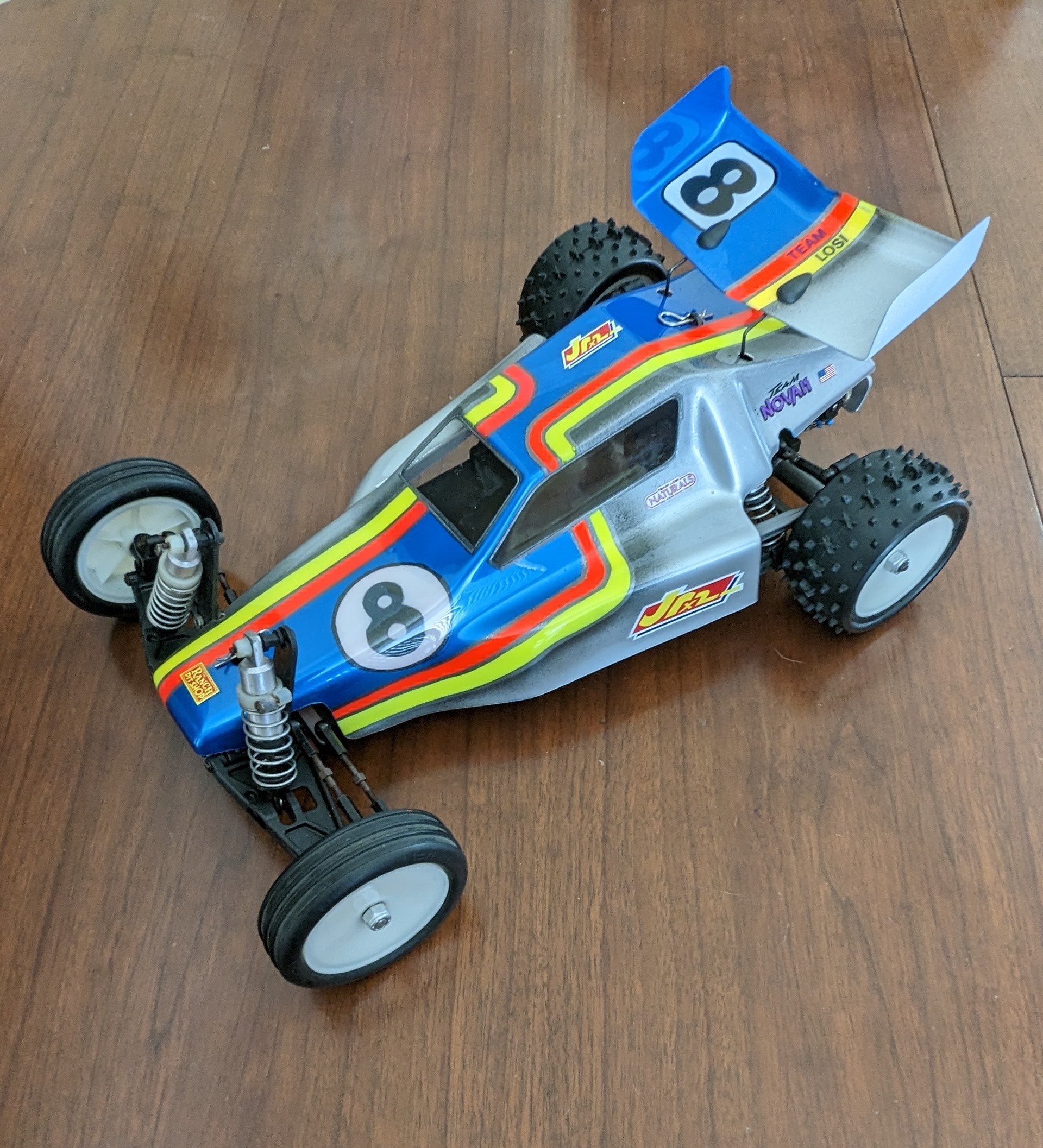

I got in some nice repro JRX2 decals. I stickered up and dropped a motor in the JRX2 that's in my "No Losi buggies" collection.

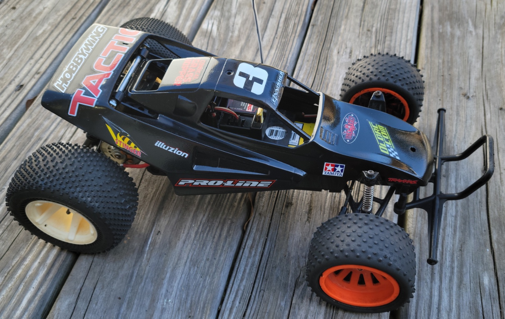

A 5 minute Krylon paint job and a few decals, and it almost looks respectable. Almost.

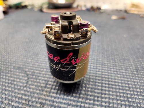

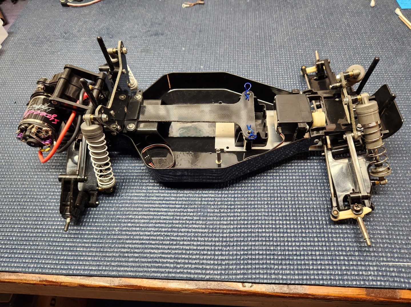

Little more progress on the two Futaba FXT's. Also freshened up a Speedworks Tony Neisinger 14T quad motor with a new MCI decal (turned 29,830 rpm at 7.2V and 2.8 amps, with 12 deg. timing) and slapped it in one of the FXT's with a 20 tooth pinion. The other one has the same amount of progress except the motor isn't ready yet. Next, gotta dig through and sort out all my wheels. The one pictured will be getting stock wheels, and the other HPI Super Stars.

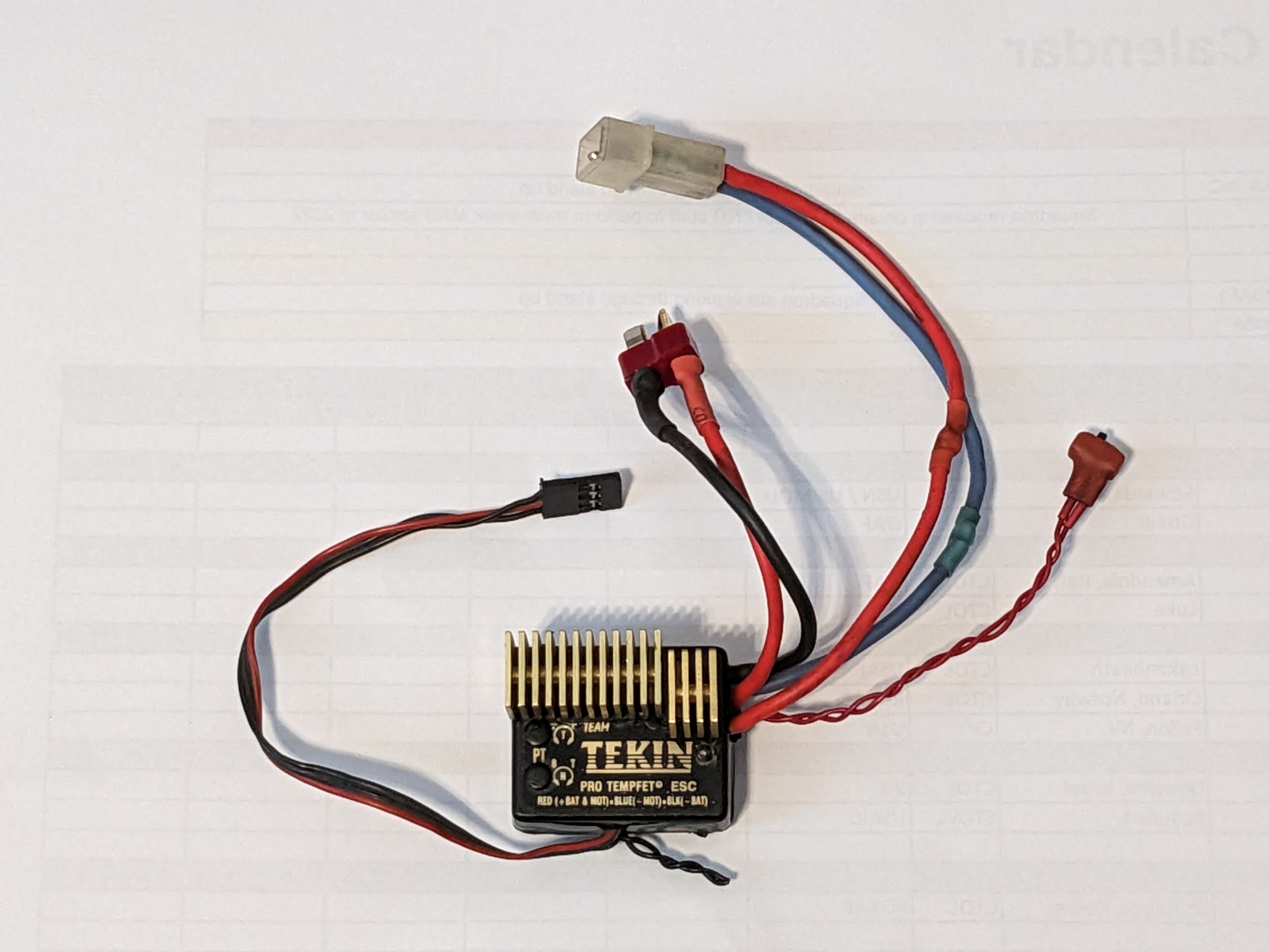

Checked out a couple of Tekins from 'the heap' of unknowns. The TSC 410S is completely dead but a little Pro Tempfet unit is a good one. Cleaned it up a bit, added a power switch, Futaba'd the receiver plug wire pattern, and it's ready to use.

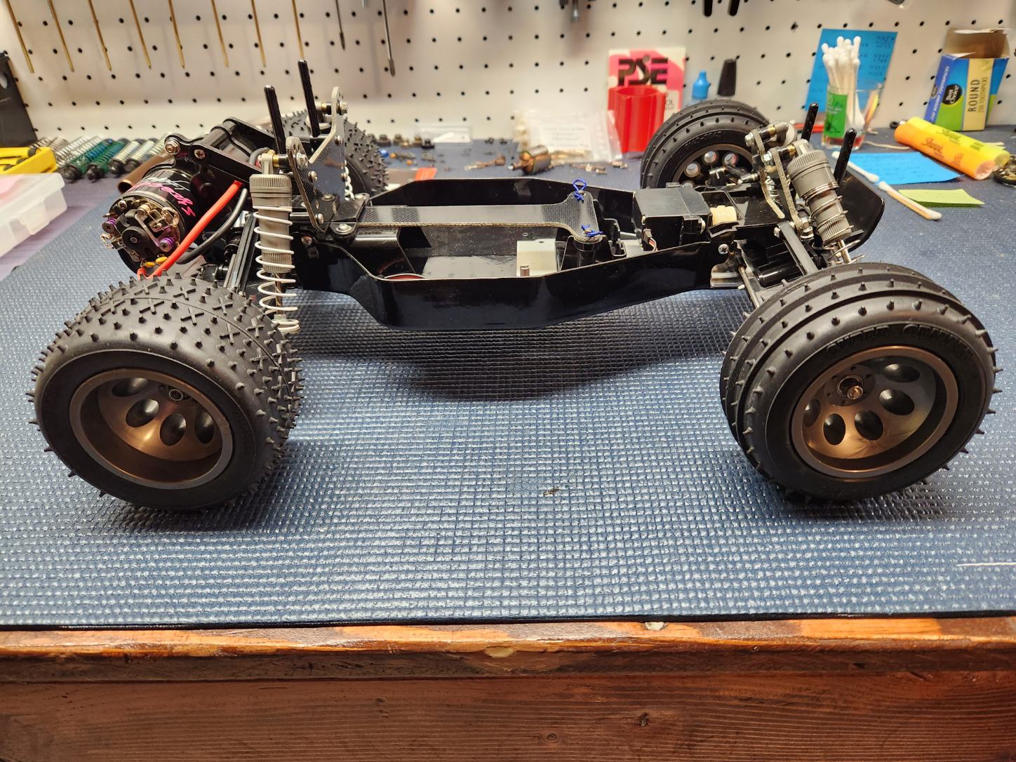

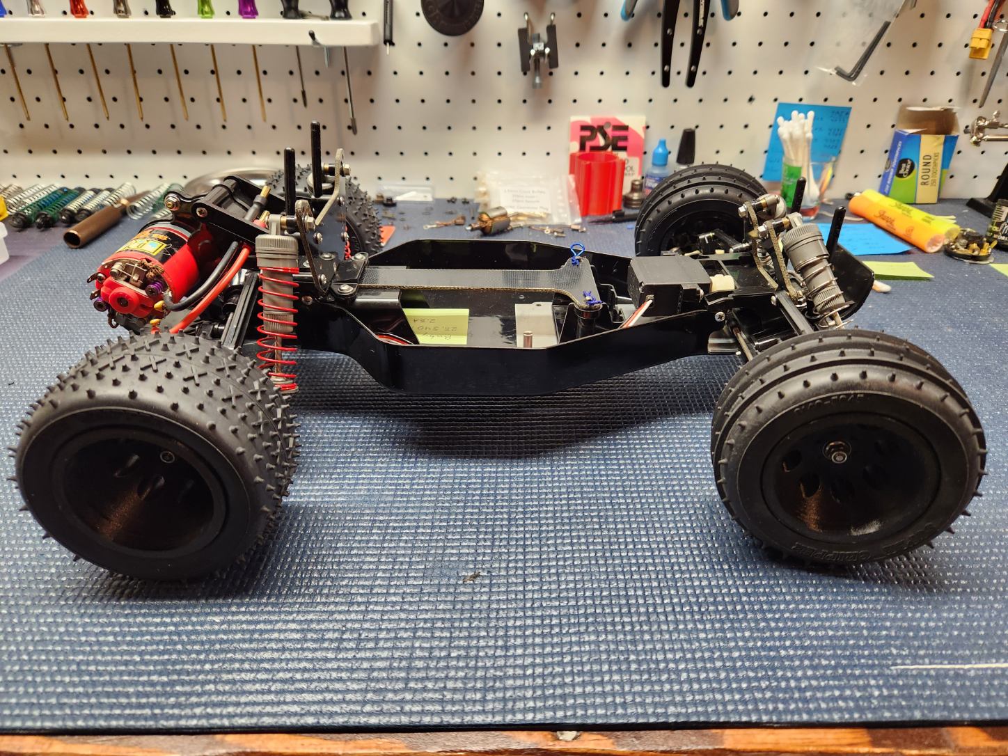

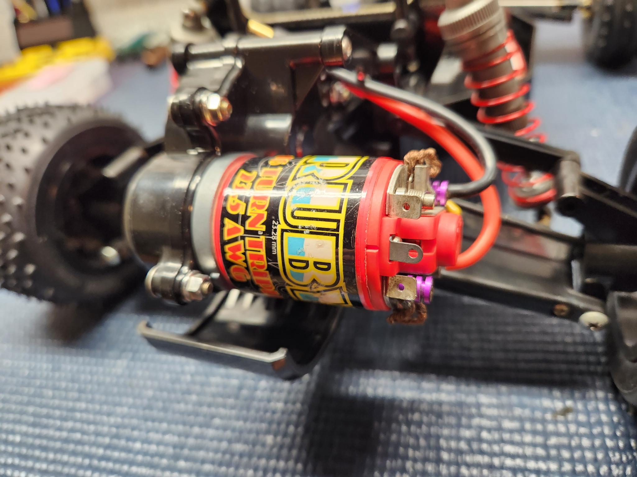

Refreshed a Speed Gems Ruby 16T triple for the runner FXT. I had this motor in my first FXT circa 1994-1995. Original decal is in decent condition but is coming apart, so I trimmed and placed a piece of clear tape slightly larger than the original decal to preserve it. Motor ran great using new light springs, turned 28,540 rpm at 7.2V and 2.6 amps with 0 degrees timing. Spun another 1,000 rpm at 10 degree timing but I'm going to keep it at zero.
Test fitted wheels and tires. Had some Losi 5.7mm wide 12mm aluminum wheel hexes that are a perfect replacement for the original plastic hexes. The black wheels on the runner truck are reproductions of the originals our resident Frankentruck 3D printed for me. Which fit perfectly, might I add.

Did you have to trim the back of the fronts?
The fronts that he made me hit the hinge pins before full lock. I'm thinking of getting a router attachment for my Dremel and using a 1/8" end mill bit.

Those are good looking trucks, and having a motor you've owned since back in the day that's still in that good of condition is excellent!

Got a picture? It's the same model used for both your sets. I wonder if I missed adding a chamfer from the originals.juicedcoupe wrote: ↑Tue Feb 07, 2023 10:36 pm Did you have to trim the back of the fronts?
