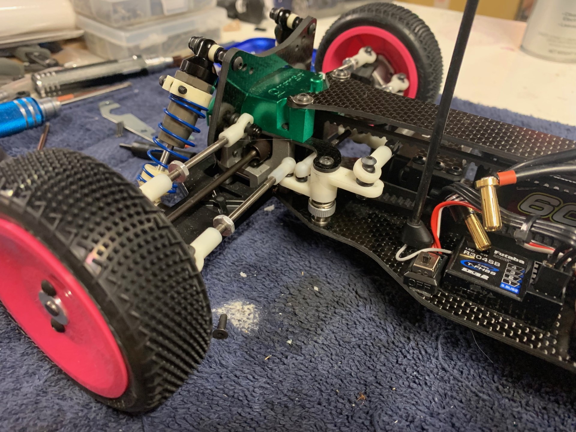

Post by JohnE »
Chipping away at mine
I have a 89 worlds conversion kit that I got from Fan RC that I am using on it, most of it fits after I re-drilled the chassis using the new one as a template. if you go this route make sure you have a dremel tool! it isn't pretty but who cares since this car has undertray
the dogbone length is funky, normally the kit uses the 422 length which is too long for the re-re diffs so I ordered a set of 421s.

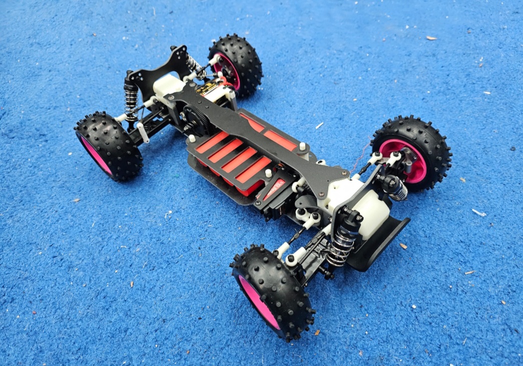

Posts: 12335
Been thanked: 3917 times
Re: 870c ReRe?
Here is mine with our 89 Masami conversion added. Not a lot of room with old school cells for sure. Tried adding the lipo to the other side but just not enough room even with the shorty servo. Ended up leaving it in the stock rere location.
mikea96
Posts: 3599
Location: Puyallup, WA
Has thanked: 659 times
Been thanked: 878 times
Re: 870c ReRe?
Post by mikea96 »
Looks good Jeff! Now where is the dukomo version 8)
JohnE
Posts: 75
Joined: Tue Mar 16, 2021 5:35 pm
Has thanked: 17 times
Been thanked: 68 times
Re: 870c ReRe?
Post by JohnE »
Mine is almost done, just have to finish the body.

Post by mikea96 »
That is looking really good 8) Are those lunsford turnbuckles? Are those the Fan Rc shocks as well and if so how do they feel?
JohnE
Posts: 75
Re: 870c ReRe?
Post by JohnE »
The turnbuckles are copies for an RC10 that I found on Ebay.
Shocks are from Fan RC. They are really nice, they come with seals, all the hardware and springs but you can use any associated sized spring. Same with the pistons
