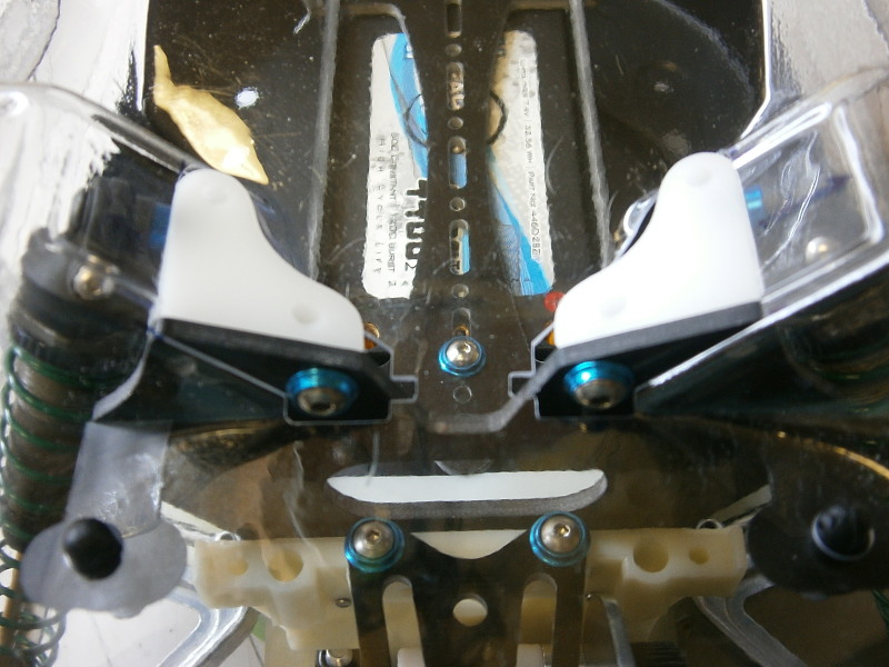

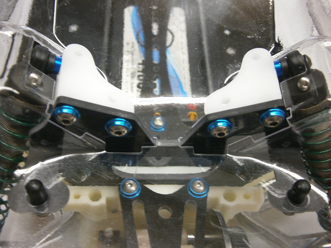

GoMachV wrote: Thu Feb 08, 2018 11:00 am Back in the day we would have cut the area out that was interfering. A lexan cover could be precision cut and bent to bridge the area over the tower between the two existing humps. Use a couple small BRP plastic rivets to hold it. Just my .02
Your .02 is worth gold, my friend! Now where in the heck am I going to find BRP plastic rivets :!:

I've been cutting/filing/sanding for the past couple of nights and getting so close! I've probably dropped the back 6mm so far, about two more to go. 8)

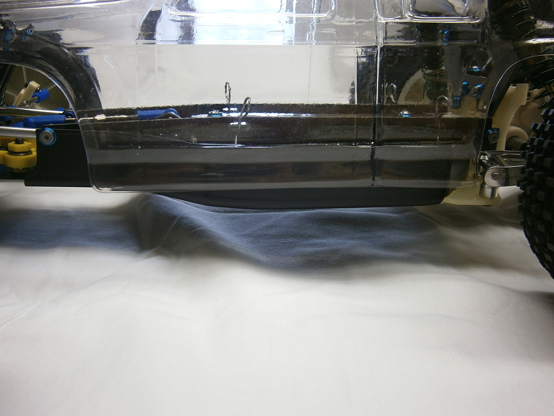

NomadRacer wrote: Tue Feb 13, 2018 2:21 pm I've been cutting/filing/sanding for the past couple of nights and getting so close! I've probably dropped the back 6mm so far, about two more to go. 8)
very nice - side pic so we can see the lowered rake, and posibly slammed look?!? :)

Lonestar wrote: Wed Feb 14, 2018 7:16 am
I performed a couple of more cuts last night and I'm about 3mm or less from resting on the rear body mount pads. It's touching the tops of the shocks now, which will be and easy cut! After that, it's only some fine work to go for a bit of symmetry. I'll bring you the next pic of it done. :wink:

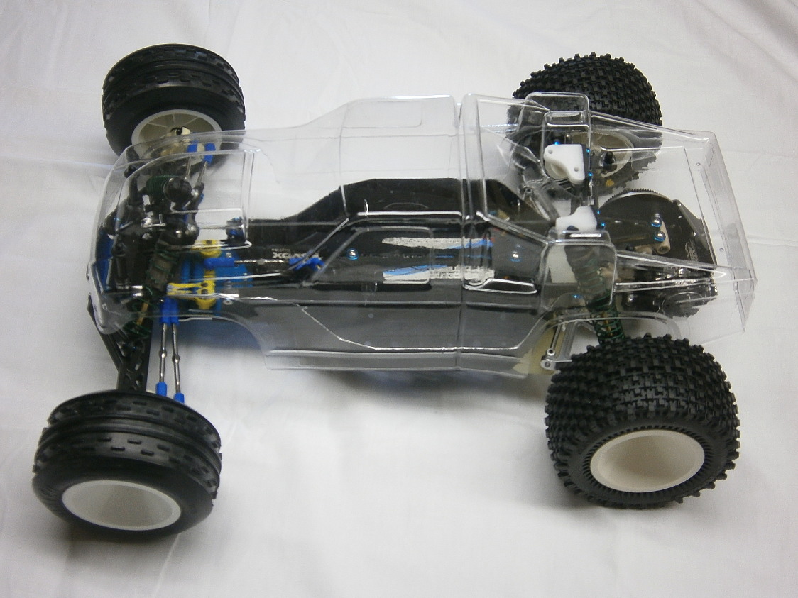

NomadRacer
Posts: 1467
Has thanked: 81 times
Been thanked: 79 times
Re: NomadRacer's RC10 Trailing Arm Truck
Post by NomadRacer »
@Lonestar
Here's what ended up with...
I dropped the rear as much as the body mount and trailing arm hardware would allow. It's pretty close to even now. :D All's left is to do some fine work of the edges and round some corners off. The body lifts off with ease so I'm quite pleased with my work.

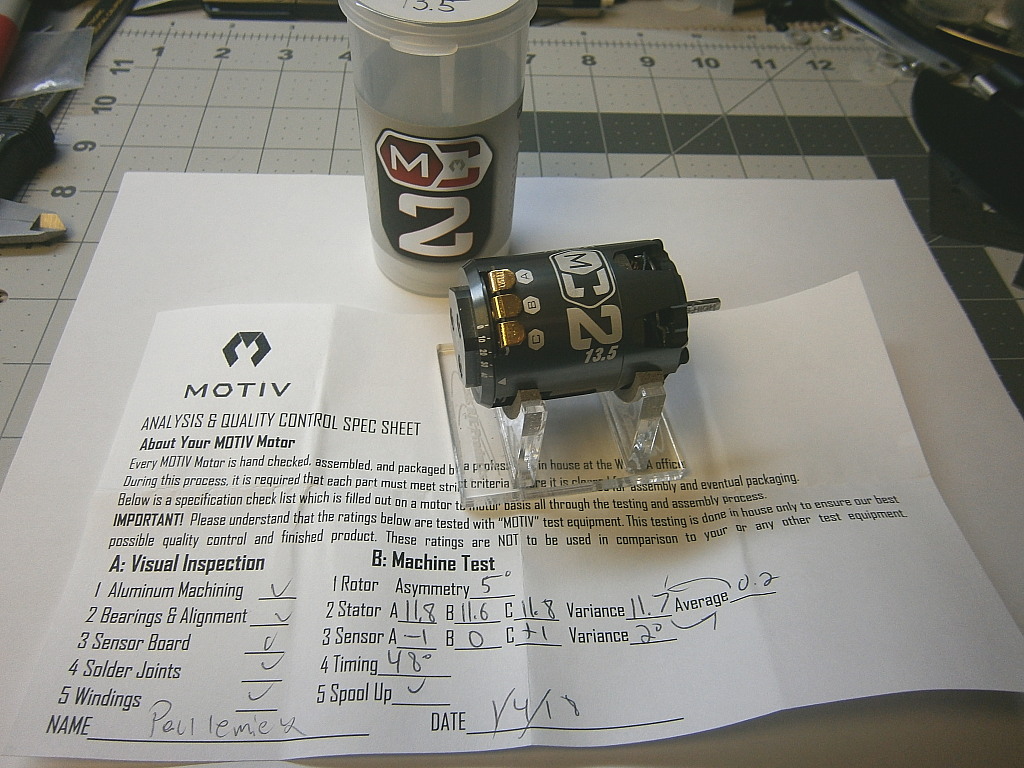

I got the motor I wanted in today's mail...
MOTIV MC2 13.5 Brushless
