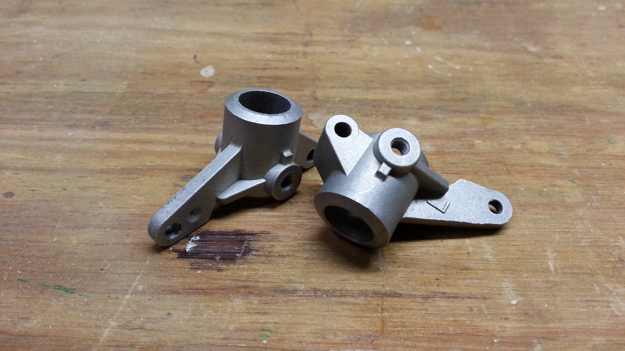

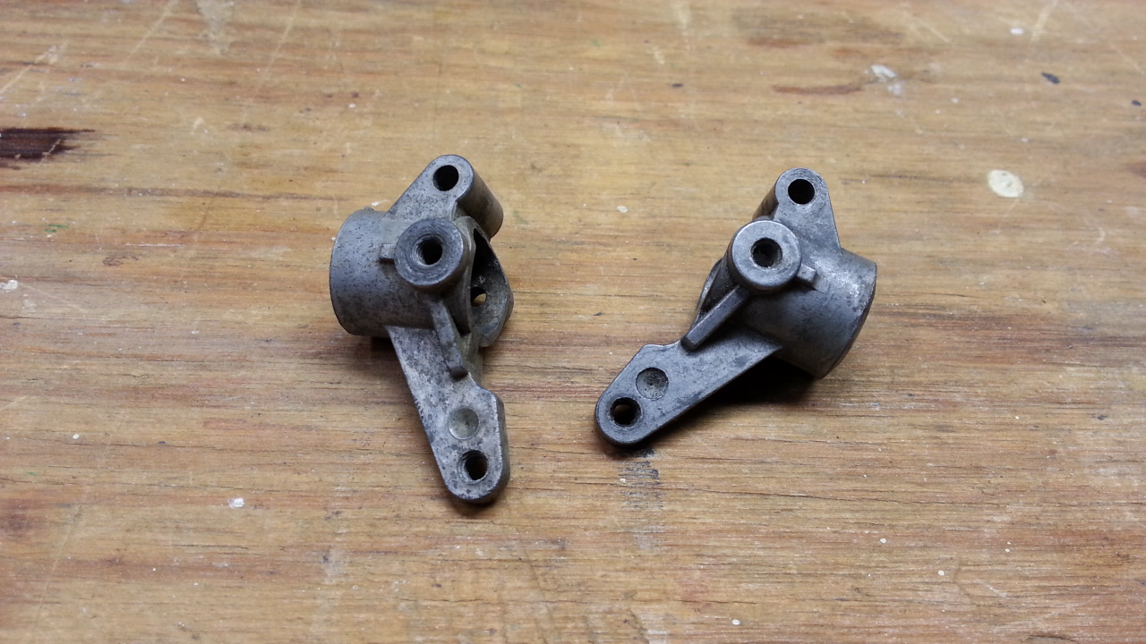

Nothing really new on this. But, Brian hooked me up with a pair of yoke hubs. I only had one extra and it was cracked at the camber link hole. I gave them a quick glass beading.
Before
After
Before
After

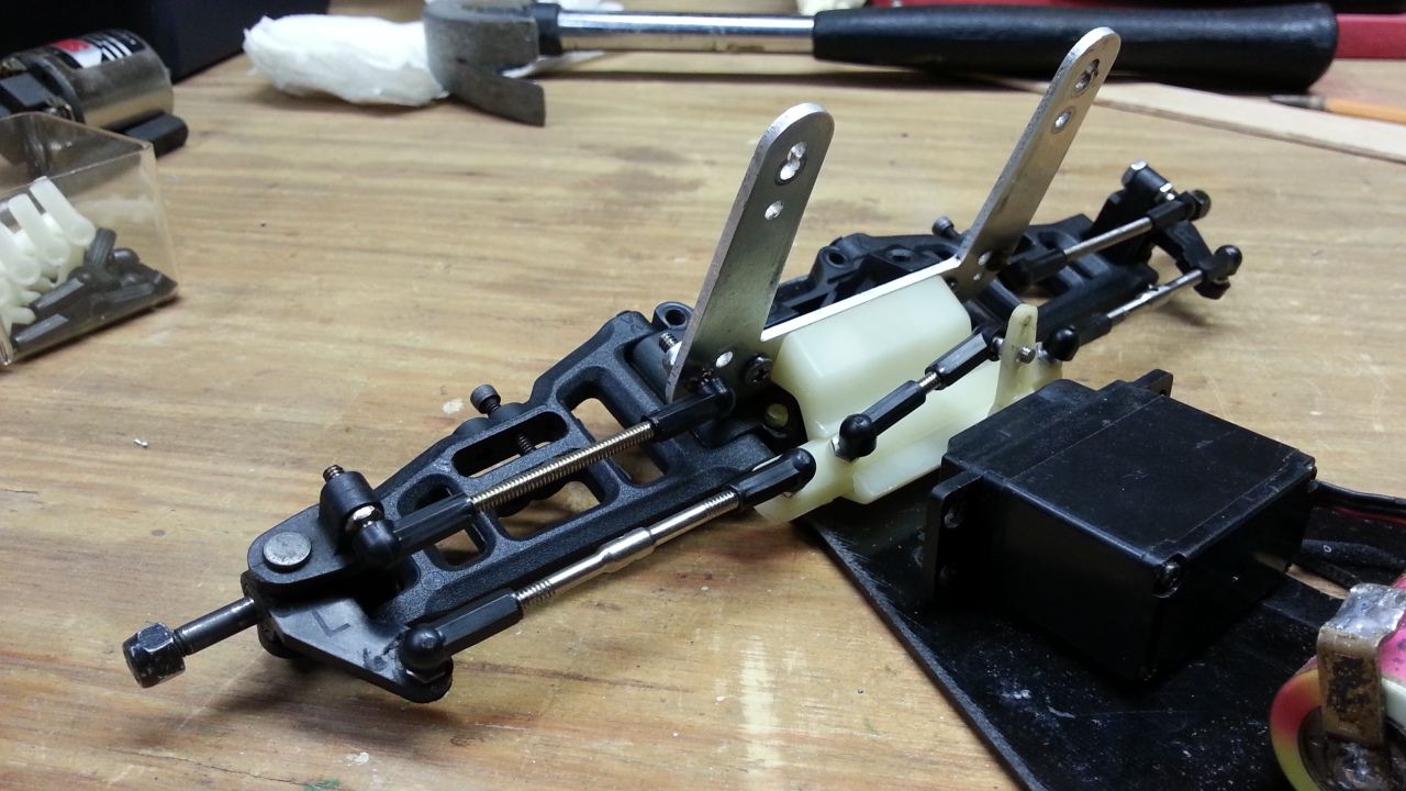

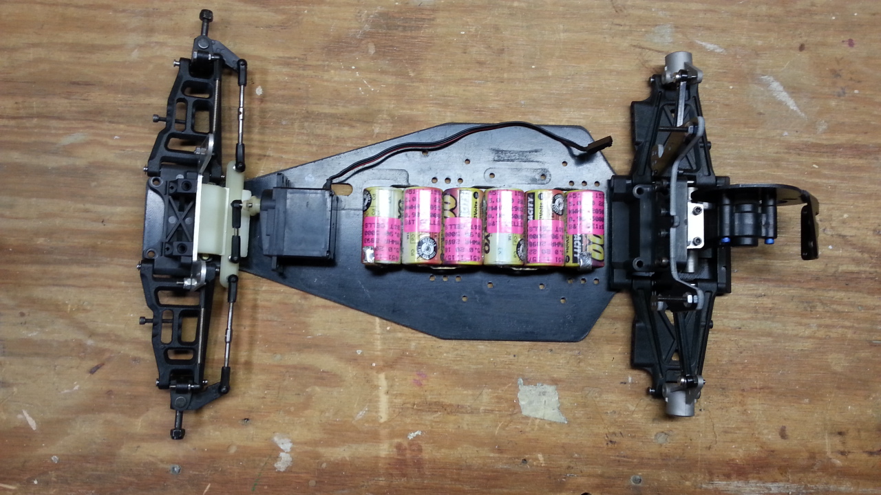

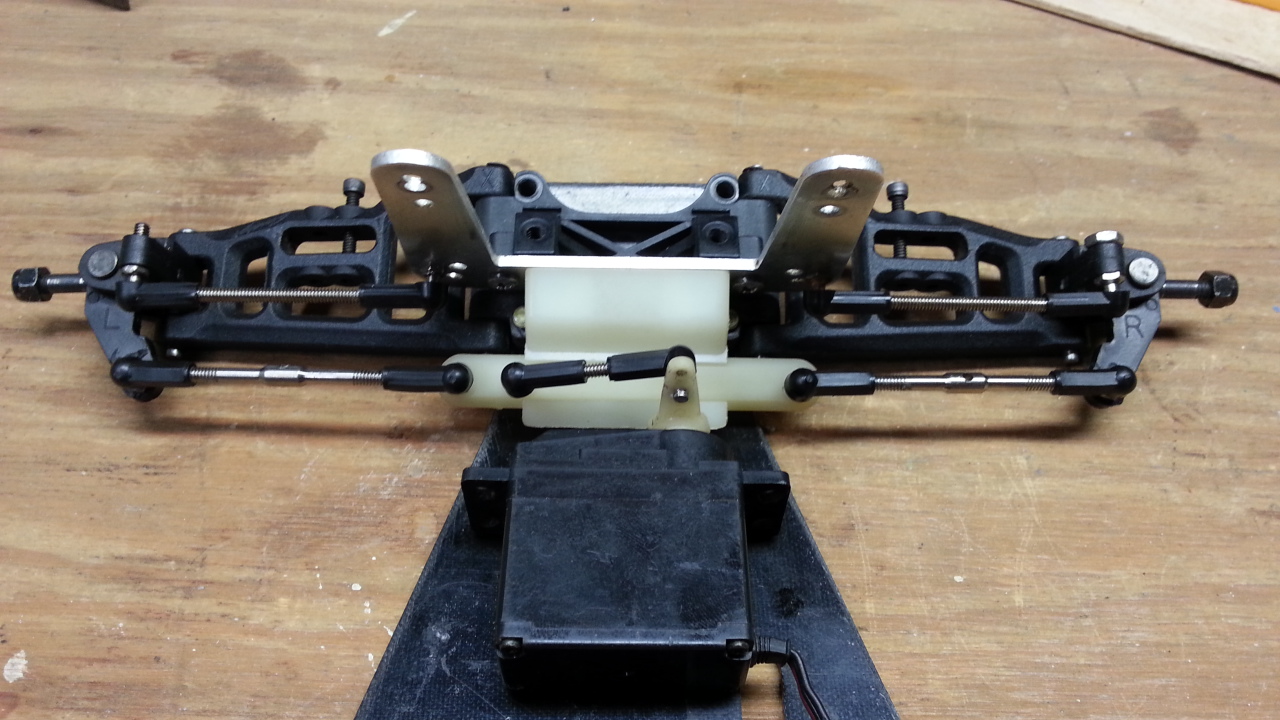

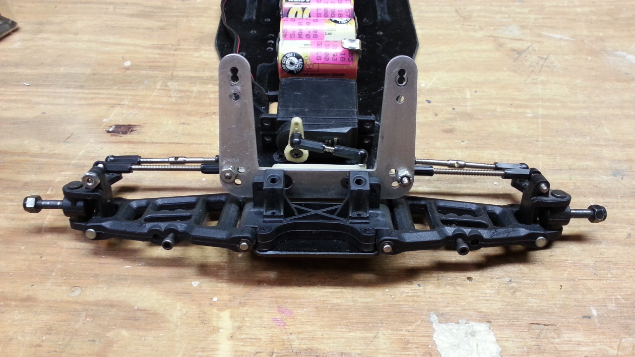

so i had been debating what i wanted to do about a steering bellcrank. servo placement was going to be an issue if i wanted to have the battery inline. well i did a little brain storming this morning, and decided to try a custom works slider setup that's been laying in a drawer for years. i think it's going to work pretty good too.

Wow, this build is going way to fast
That steering set-up suits it

Nice work. I did the same type of steering mod when I built my woin ultima. I used laser and triumph parts...and possibly some tower hobbies parts. Made a huge difference for laying the battery down the center.

I love those racks, I wonder how they will hold up in the off road scene?

Agreed, intriguing steering setup...how do you keep dirt from contaminating it, though? I assume it's nylon-on-nylon?

its basically a nylon on nylon dovetail style slider. Awesome on dirt oval...

Someone posted a link to your build a few pages back, I never saw it before that. I was already into the trans swap and knew I would be running an inline battery. I really didn't study your car, so the steering is honestly just a coincidence. I was thinking about trying some b2/b3 bellcranks, but I already had the custom works slider.
It works though.

The sliding rac does work, but it gives you almost too much steering. You might want to dial out some on your radio.
I did run the car for a long time in this configuration, but after the stealth started wearing out, and the moterplate got bent up. I went and built somewhat of a twin-brother with an A&L LW2 transmission.
I'm not using a sliding rack on that one anymore but went for a dual belcrank instead. With the low-profile further to the back and the receiver across off it, saddle packs side-by-side in the center and the ESC tucked right behind them, the weight is less centered sideways now. But it better centered in the length, and immediately felt that does work better for my driving capacity.
