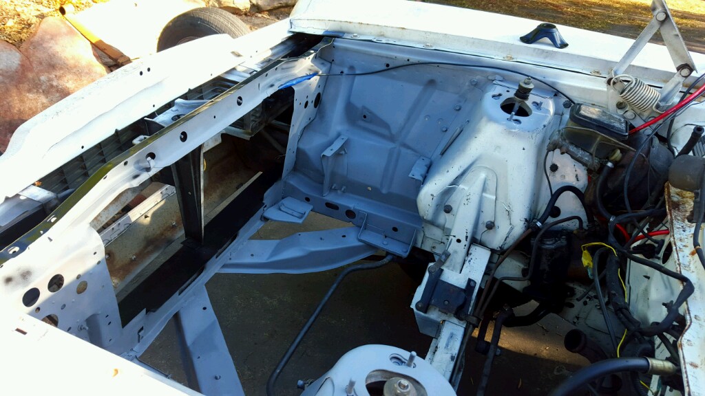

Again not much to update. I was hoping to get the steering box out today but didn't have time. I'm dreading its removal but need to tackle it next. I did however get the wiring harness out and removed the LPG converter.
I managed to flatten out the radiator support as it was pretty bent up in a few spots. I got the front half sanded, rusted areas around the battery treated, primed the front half and painted the black bits. I would have liked to spray the entire engine bay in one hit but the rust converter needed to be covered in 3 hours.
Hopefully next week the engine bay will be painted and then only assembly will be required to finish the car. I'm debating if I just go the whole hog and replace the power booster and master cylinder, then mechanically the car would be solid as a rock. I was going to replace the pressure line on the power steering but the hose that's on it doesn't look too old, it still has it's zinc plating.

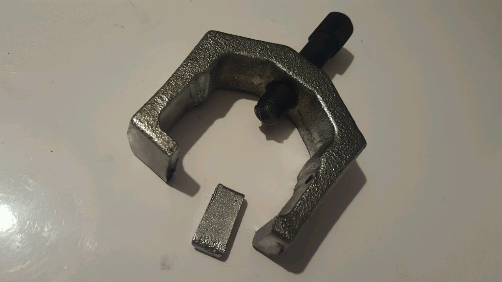

This damn pitman arm is starting to piss me off....
I need a bigger hammer, and just belt the crap out of it till it falls off

Looks like a Made-In-China puller there. Is that pot-metal? :P Seriously though, when my buddy and I did some front end repairs on my Charger back in the 90's, my Pitman arm was also a pain to remove...we heated it up with a blowtorch for a bit and that helped it break loose.

They are cheap but not cheap at the same time. I bought a new pitman arm so it doesn't matter if I cut it off.

Something like that I would load up with the puller, then apply some heat with a torch until you hear the POP. Then she should slide off pretty easy.

After it wouldn't pull off I loaded it up again then smacked the pitman with a hammer, nothing. Heat is the next thing followed by cutting it off

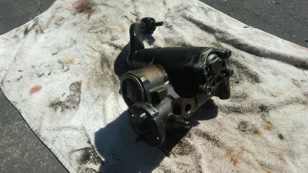

Not sure it would help on a pitman arm but have you tried some penetrating fluid. Over here we have PB blaster/fabulous blaster. Stuff works wonders sometimes.

I'm not sure how well it would work on a Pitman arm, though...but it can't hurt. Definitely hit it up with a torch before trying to cut it off. You might damage the Pitman shaft seals or splines if you go that route.

I bought a bigger hammer, one way or another it's coming off.

That's it, when in doubt buy a bigger hammer!
I remember watching a guy remove the pitman arm on my 68 Chrysler, I thought he was going to break
the steering box he was hitting it so hard.
He did use some heat though.

Man I'm glad that's over, my bigger hammer worked. I ended up seperating the pitman from the drag link. I banged up the end of the drag link a bit more then I'd like but at least it's out, it too was fairly stuck. You don't see the drag link so a bit of paint should make it look better.

Another unknown thought, how about lightly coating the mating surfaces with anti seize to prevent stuck parts for future repairs? I use it on FWD CV splines on the hub side if I ever change them. It makes a noticeable difference there. Never tried it on a pitman arm as I've only change one steering box in my time.
