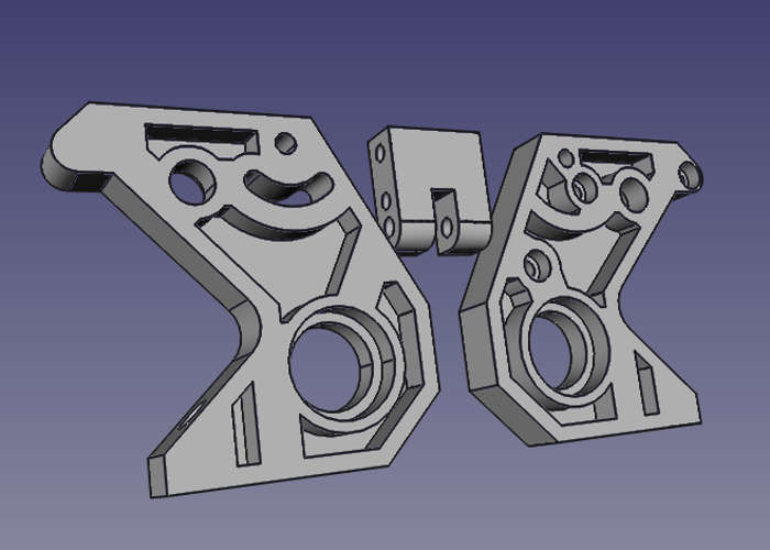

4 gear stealth is coming along 8)
Like the 3-gear mid-motor Stealth I'm working on, this one would use existing chassis holes for mounting. No drilling needed in the chassis.

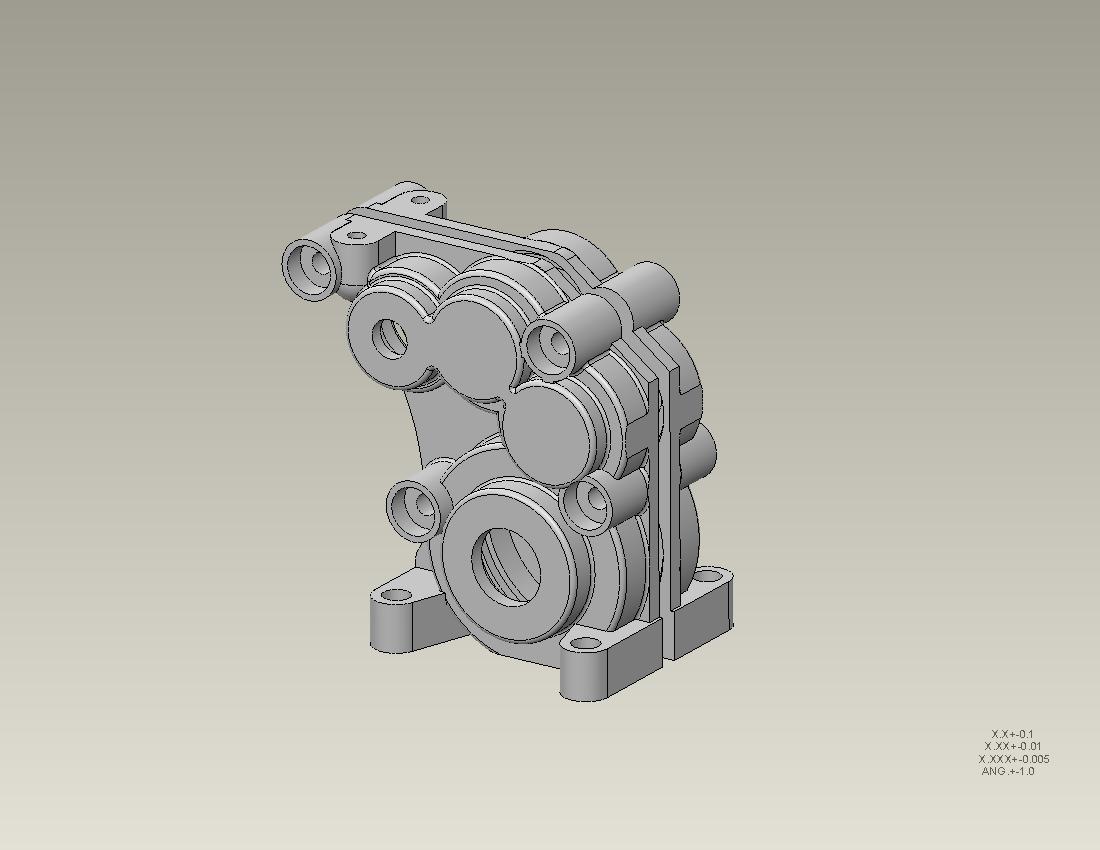

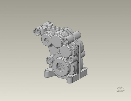

Worked up a Team Pit Stop Transmission case. Might take a stab at the MIP SP-1 next.

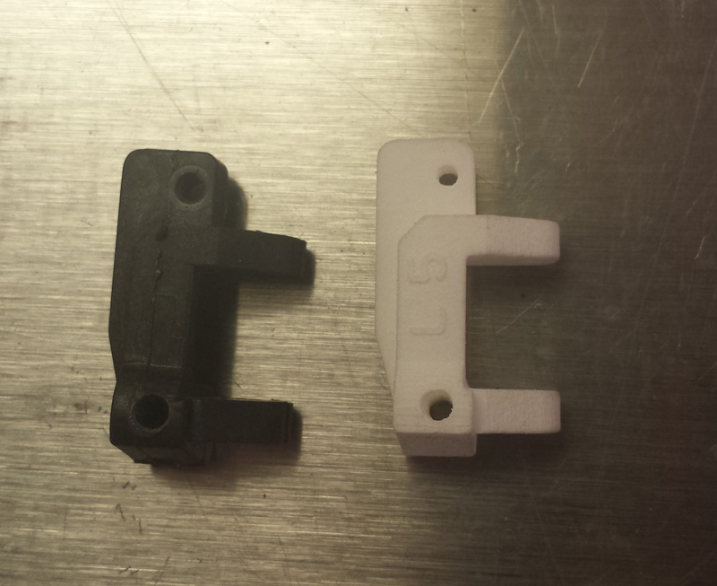

My first parts came in, these are the replicas of the 25-degree castor blocks. Just need to iron out a couple small things and they'll be ready to go. I need to place a order for some of the other items I've designed, including the transmission cases.

Very nice work 8)

Post by mk-Zero »
Yeah, I wouldn't expect to sell many of these, since they are a replica of an existing part that has decent avalability. Although white ones may be hard to find sp maybe some people will want them... Mainly though I copied it so I could modify it to other angles. I think my +5 ones will work nice with my -5 arm mounts to give 25 deg of kickup and 30 degrees of caster.

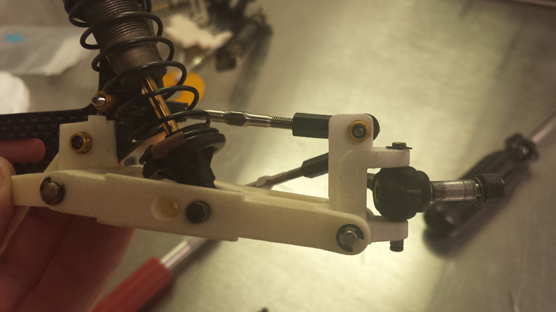

I got my McAllister lowering kit 3D print in. It works perfectly so they'll go public tomorrow. Now if I could just get the wide rear arms in.
