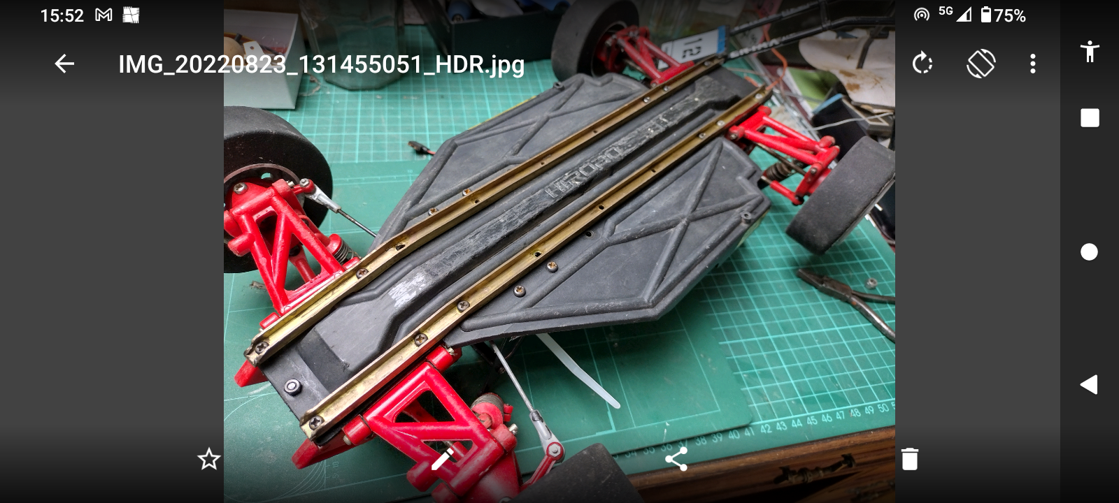

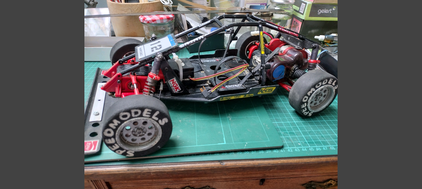

Zerda wreck II
from Switzerland to the UK.
set up as a drift I guess with support/chassis protection strips.
Steering servo with a plug I hadn't seen before.

That's interesting , I'd say the added rails are intended to compensate for the loss of the top deck , the foam tires might mean indoor or carpet track ? The servo plug looks like the early Futaba plug .

Got it mostly dismantled with very few nasty surprises. Mostly missing or wrong size screws. Primary drive belt cover had perished rubber boot but I have a spare if I decide to fit it. Drive belt was over tensioner instead of under it. some old glue to remove. Dadio's 3d printed cage rear fender spare (thankyou) will replace missing part but the rest of the cage is ok if a bit scratched. Wheels of unknown parentage, they'll be replaced with something more suitable. Mabuchi motor may be the bog standard that came with the kit. I've got an alien mid deck which has the same outline as zerda but different cut outs. Diffs look good as new but dry so all in all compared to the sum of cost of it as spare parts not too bad. Waiting for drive shaft cups which I hope will fit (non hirobo) and hope dog bones I have as spares are the right length as it was 2wd which is pointless on a zerda unless you do away with the long drive belt somehow. Saving inspection of shocks for another day
