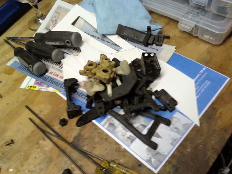

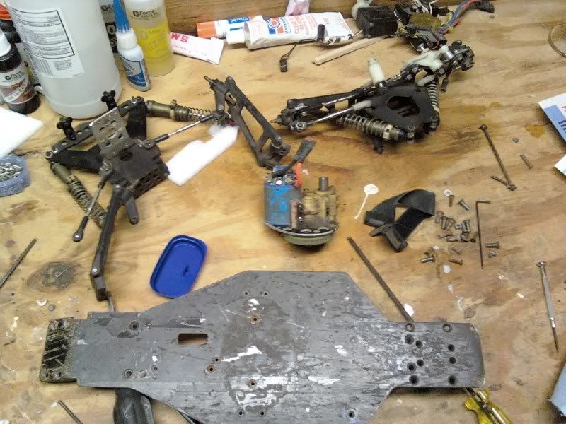

Step 1: Tear-down

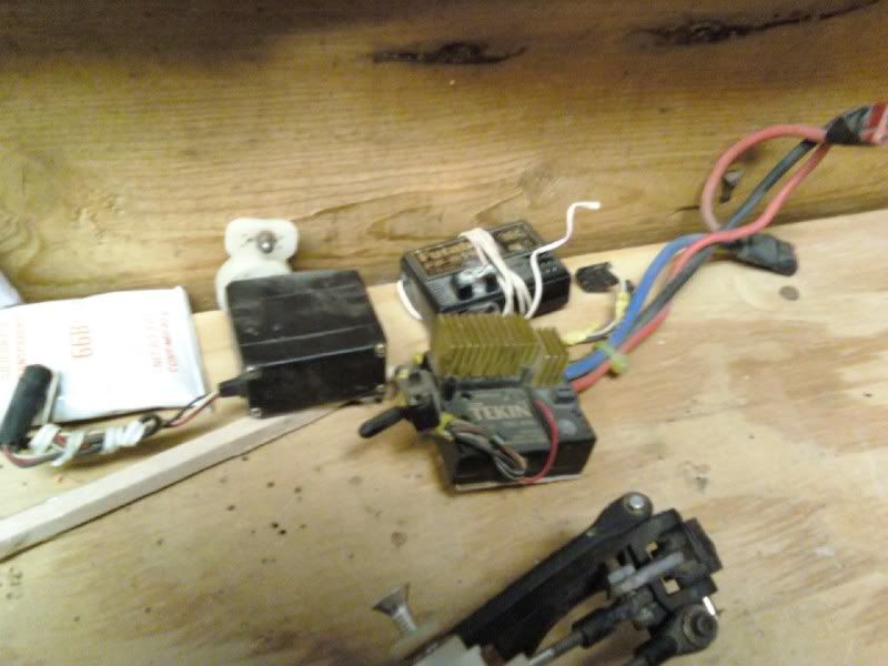

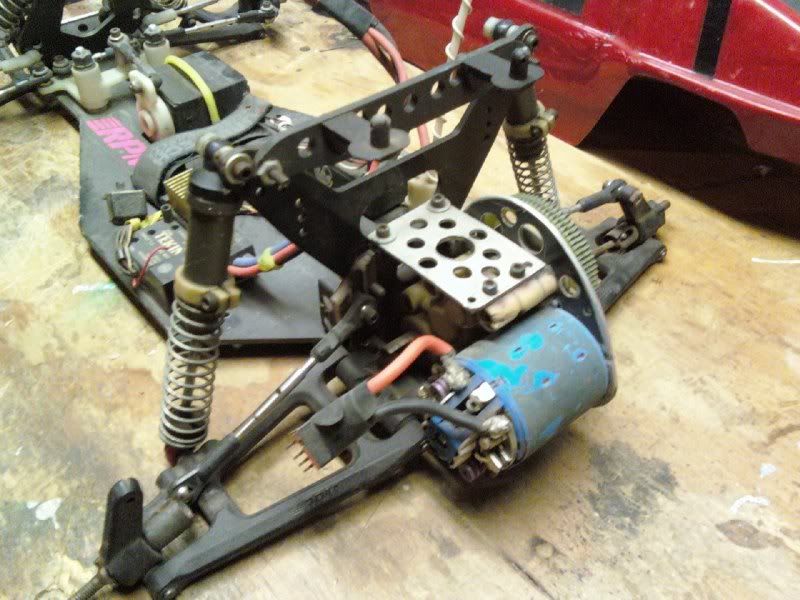

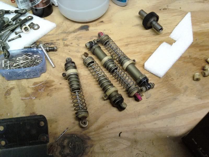

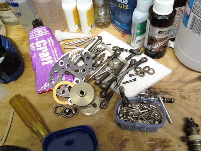

My Futaba Magnum Jr. radio is long gone, as are my battery packs. One dogbone is missing... but may be around somewhere. Everything else is accounted for.
I got the whole truck disassembled in a single night.

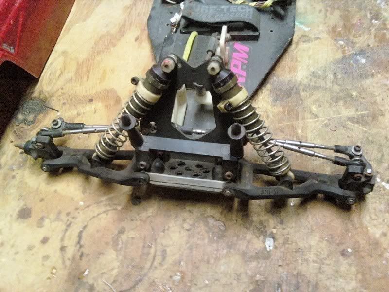

The wheel bearings are shot... totally destroyed by rust and grime. The bearings in the transmission, however, are in very nice shape.
Most of the hardware is ok. A few bolts are bent, and one or two are stripped. Those will be replaced.
Don't worry, I know how it all goes back together!

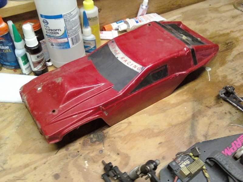

nice truck a good stip down and clean keep the body and you got a nice ride i have a few odd dog bones you can have but i would put CVDS it would do that nice T justice

Cool, but I say, clean it up fix what's broken and keep the original body on it! It's your car you ran as a kid, be proud of that body! I love it! I wish I still had some of the things I had as a kid! Hurricanes suck for that! :cry:

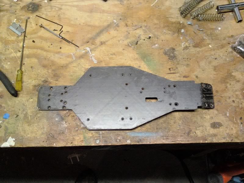

And before you paint that puppy, Unidirectional carbon takes very well to wet sanding to feather out imperfections, now that chassis is less than perfect-but wet sanding starting at 600 and finishing with 1000 to 2500 grit will make it shine
what about CF with weave will that sand the same Reg?
Posts: 9220
Has thanked: 280 times
Been thanked: 379 times
Re: Yet another RC10T Resurrection...
No, the resin pools in between the high and low points of the woven fabric, so when you sand you get very shiny parts ( the high spots in the fabric) and duller spots in the low points ( just resin)
where the uni has all the fibers tightly packed together and oriented in the same direction, so when you sand you are sanding into the fibers.

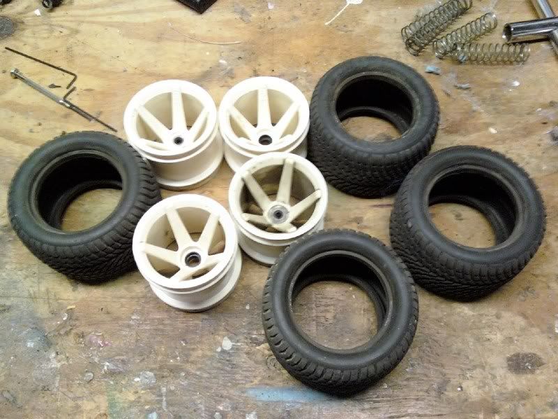

as far as a motor with a bit more zip without the trouble of a big motor (more diff servicing, parts wear, etc.) I would suggest a 19T, the trinity komodo dragon is probably the best one out there in my opionion. I would put some cvd's in it and lose the bones. I wouldn't feel too bad about that move either as far as changing it from how it was back in the day. With CVD's you can get the ones made for the associated GT which will have the 3/16" axles which will allow you to run all the modern wheels. You'll also have to change the rear bearings to a 3/8" x 3/16" (same as the front wheels)

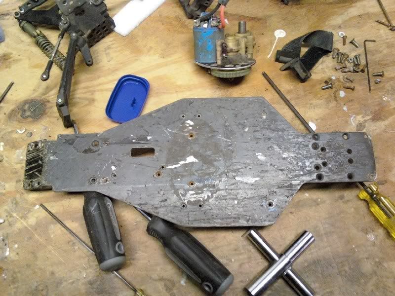

Chassis Plate Refinishing
Post by SixDeuces »

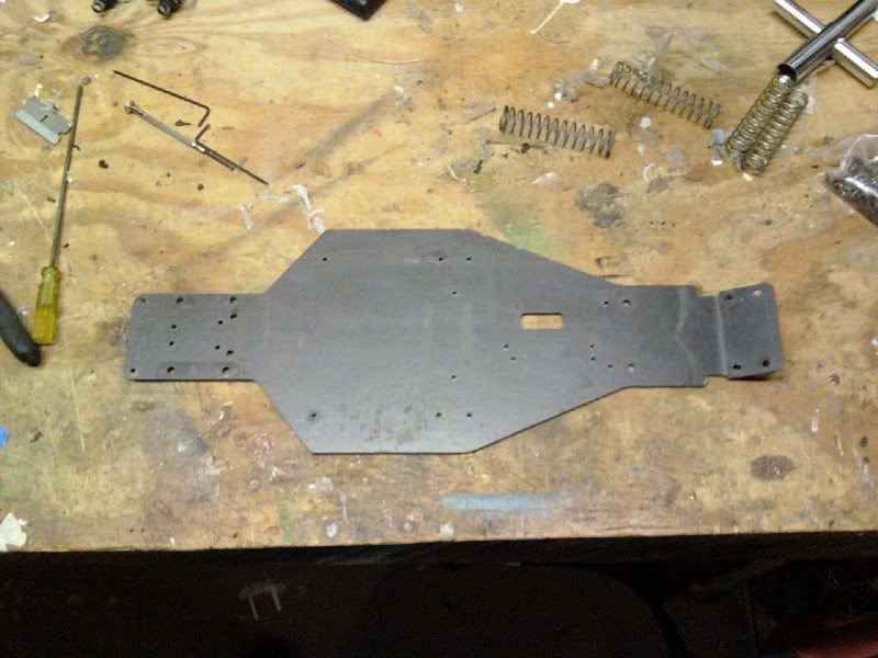

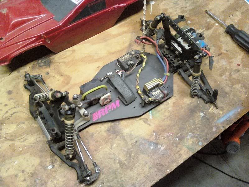

As I kid I actually had the foresight to know my chassis plate would get hammered. I had covered the bottom surface with what appears to be clear packing tape. By now it was a total mess, so I scraped the remnants off with a razor blade. I then removed the remaining residue from both sides with carburetor cleaner. The result is a surprisingly clean chassis. Compare to the "barn fresh" photos above.
I'm debating on hitting the bottom with some filler and matte black paint to make it more aesthetically pleasing. We'll see.
