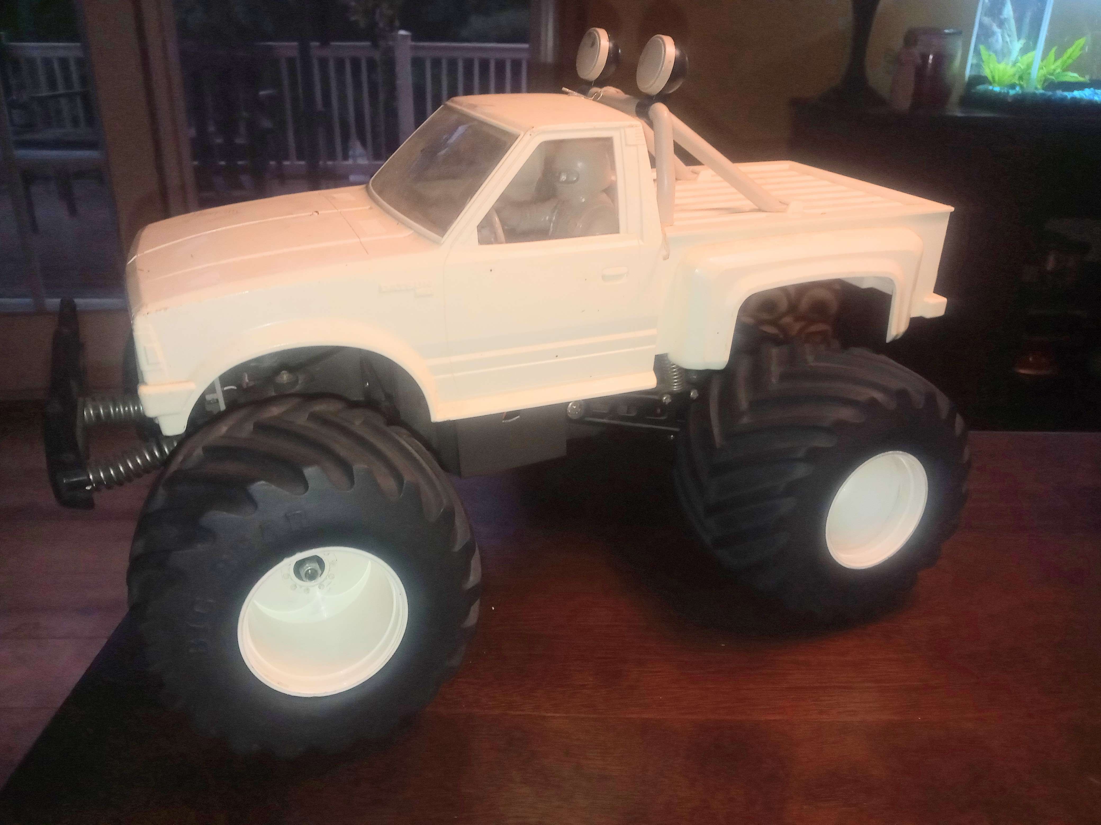

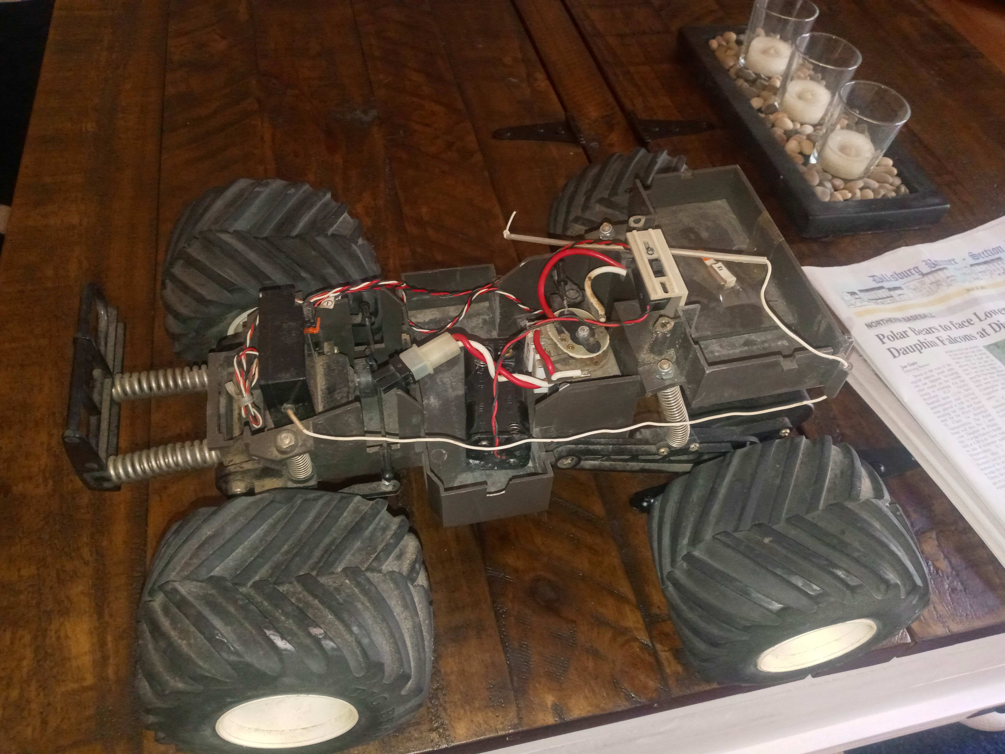

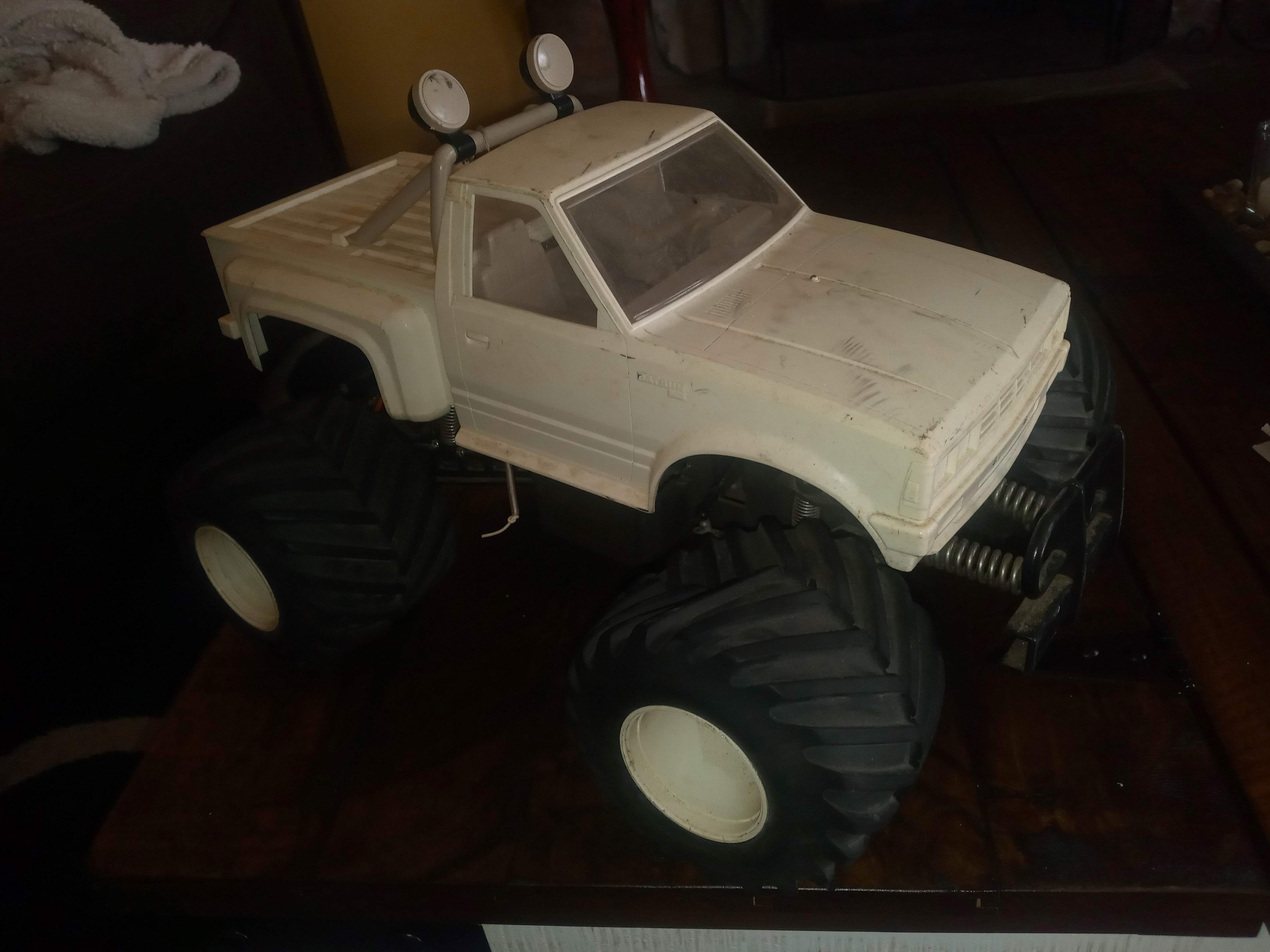

So, with the RC10 Graphite done, I figured I'd try to get somewhere on the Big Bear that I scooped up with that giant pile of free gold. It really doesn't look like it's been run much at all. The electronics are a mess and I'm not sure what direction I'll be going with that, keep it stock with the MSC or possibly something else, don't know yet. Mechanically it rolls nice, haven't identified any silliness in the transmission or diff, all smooth. The body is freakin fantastic with only a tiny bit of rash here and there, never been painted or stickered. Front bumper is broken and wonky. The rear body mount posts are broken off but I think I'll be able to make a decent repair with what's left. The tires are still nice and pliable and soft but severely flat spotted and the wheels are darn near flawless too.
I'm thinking clean up and paint the body and use decals from MCI to as box art as my abilities will allow. New re-pop from bumper from Shapeways. Tire foams to get them fluffy again. Then put it on a shelf and stare at it.

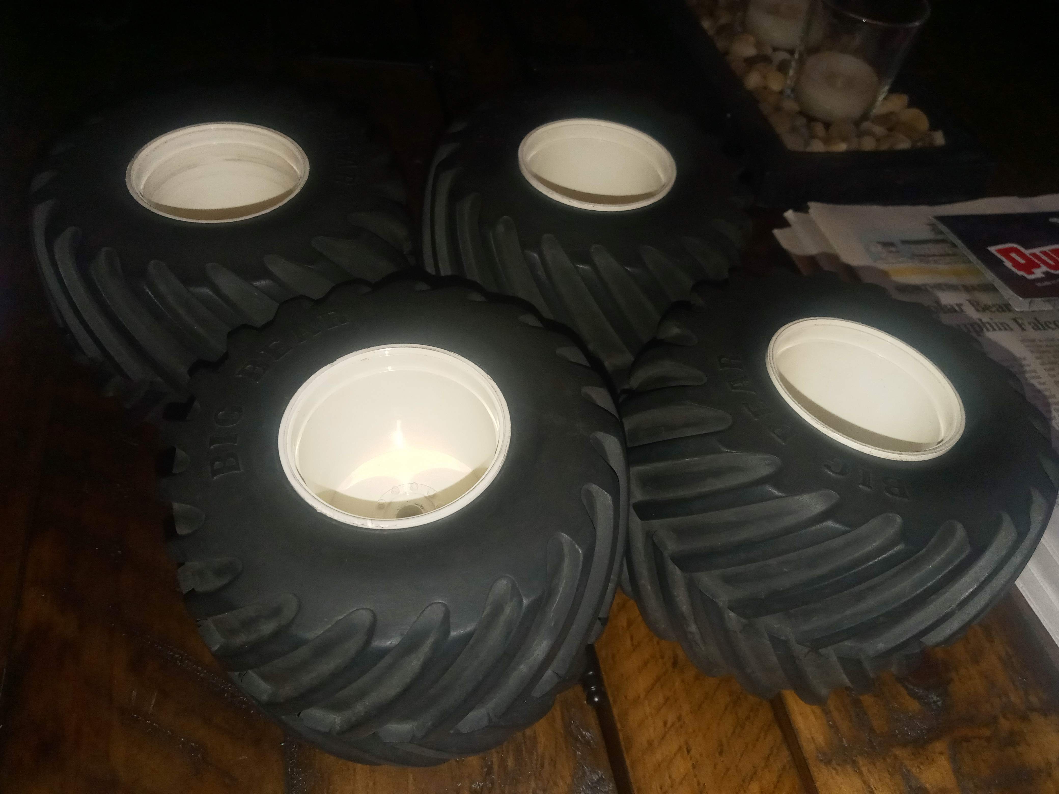

So, I got the wheels and tires disassembled, washed, mold flash trimmed from the rims, tire foams installed and all put back together. No gluing necessary, they didn't put up much of a fight. Not a fan of 3-peice rims I will say. The foams do fit and got the flattened tires sorted out nicely. A tiny bit too big possibly but, hey, it's a Big Bear, not exactly known for it's handling.
If anyone is trying to do similar, I think foams that fit 1.9 crawler tires should fit a pair in each tire and that'll give lots of options. Maybe consider the star cut ones for a little more give in the tires.

Looks like the foams fixed the flat spots issue very well

The foams did their job for sure. There's a few wavy spots in the tire sidewalls yet but I imagine they'll relax and flatten with time too. Next step will be to blow the whole thing up, clean it up and put it back together.
