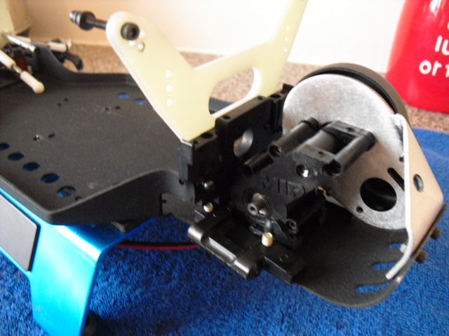

does any one no much about these mip trannys ive rebuilt this one and the diff has no thrust plates is this the way they are and also what slipper do i use.

thrust plates? do you mean outdrives?
they don't have slippers. well....... some of them had a torque control topshaft. but not yours.

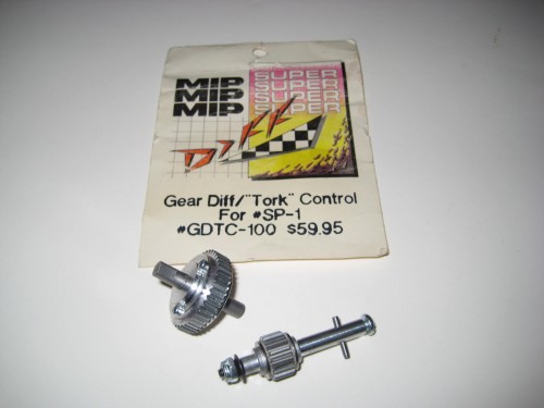

MIP made a slipper topshaft. In addition to ball diffs they also made gear diffs for this gearbox

Just assembled this pair yesterday, just love MIP stuff, great craftsmanship and quality.shodog wrote:MIP made a slipper topshaft. In addition to ball diffs they also made gear diffs for this gearbox

Those are exactly the parts I was speaking of.a01butal wrote: Just assembled this pair yesterday, just love MIP stuff, great craftsmanship and quality.

that is the slipper top shaft. you adjust it with the nut on the side, the gear itself slips on the 2 side plates and the nut and spring provide tension.
You could probably retrofit an associated or losi slipper to the top shaft of an MIP trans, just need to bore out the slipper plate to 5mm, then use a stud and nut arrangement with the appropriate thrust bearing/washer/spring, etc. I don't know where the gear would end up, it might end up too far out on the shaft.
