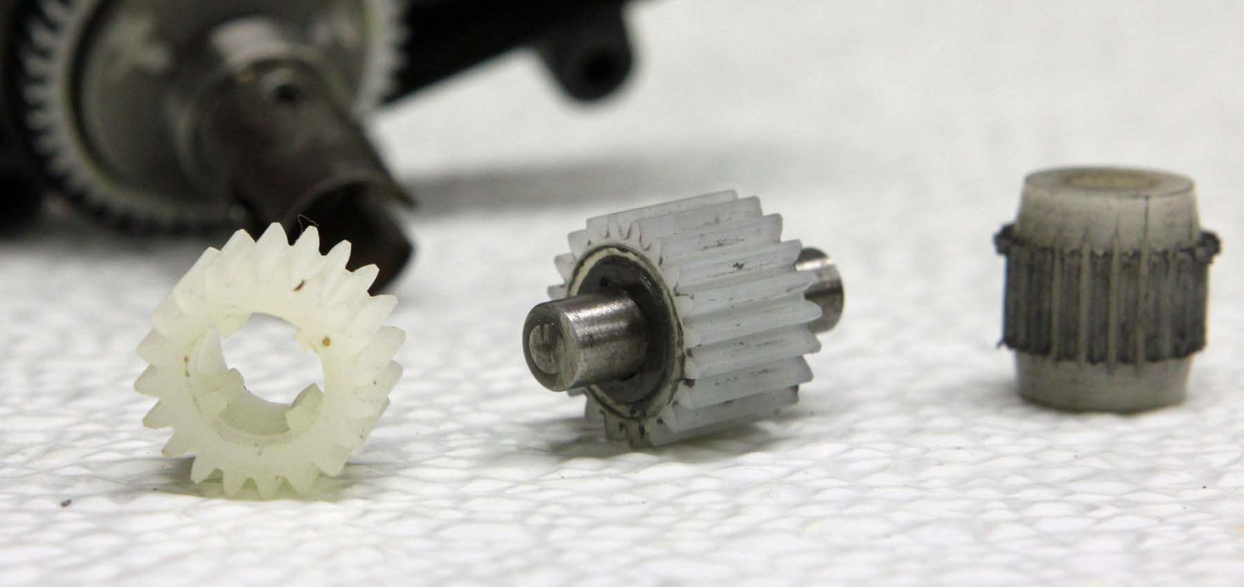

Those little gears that come in the Lunchbox gear bag, but do not actually get used in the lunchbox. If you've ever had a lb/mp you know the one.
I think it is for the wild willys 1, not sure why they still include them in the lb gear bag, but I had a few to try.
It turns out that the gear is the same tooth count and pitch as the gears in the mip trans. :D
The inside of the gear has 4 ribs that slide over the 5mm shaft loosely, but with minimal play. It probably wouldn't last long riding on just the ribs.

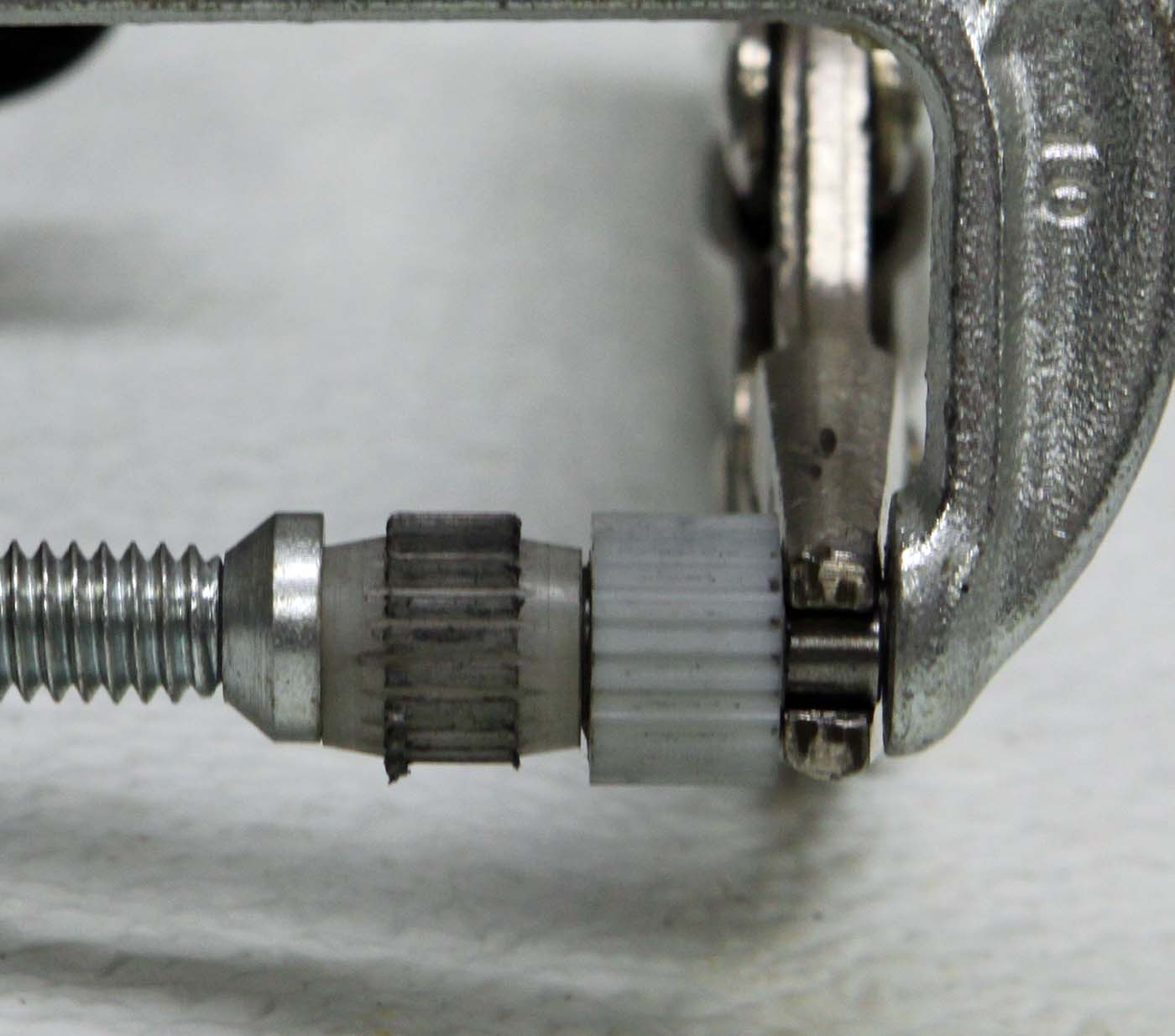

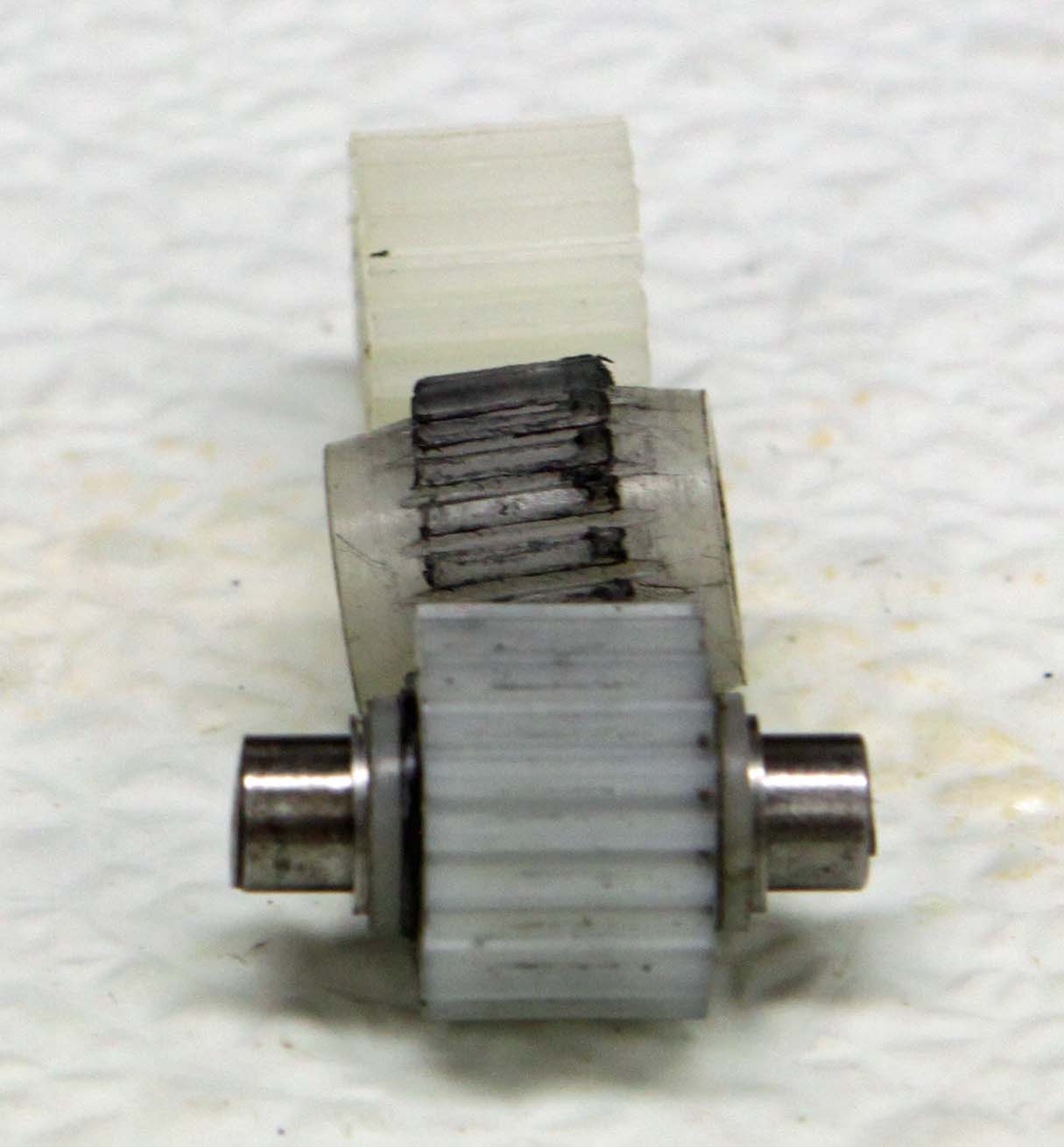

I clamped the stock mip shaft in a pair of vice-grips such that the gear was centerd on the shaft. I put a large outer diameter 5mm shim on the shaft followed by the gear, then filled the cavity around the ribs with jb-weld. I put another shim on the top, and used the stock gear as a spacer and clamped the whole thing up to set. I got a little of the epoxy on the corners of the teeth, but that wont matter as the teeth on the tamiya gear are much wider than the ones on the diff and top shaft.
After it was all cured I used some shims to get the overall width matched up with the stock gear.
The trans spins nicely.

left to right: stock tamiya gear, modded tamiya gear with mip shaft, and stripped delrin mip Idler gear
