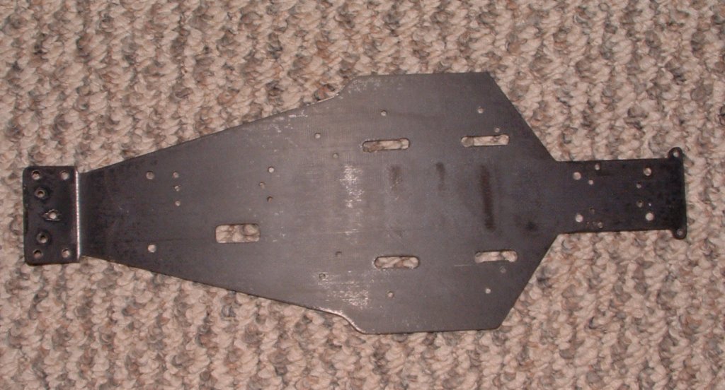

Graphite chassis repair?

depends on what you want do do with the finished product. If it is going to be a display piece you can fill the holes with epoxy or jb weld and then sand and paint the chassis.
I did something similar here:
http://www.rc10talk.com/viewtopic.php?f=27&t=13270
if you plan on running it after it is finished I would think that paint would not hold up to well and you would be best off finding a filler that matches the color well. I think Scr8p had mentioned some auto bonding adhesive stuff that was a decent color match to graphite chassis, but I cant find the thread.
I suppose the last option would be to fill the holes with some pure-tech velcro straps to hold the battery in place

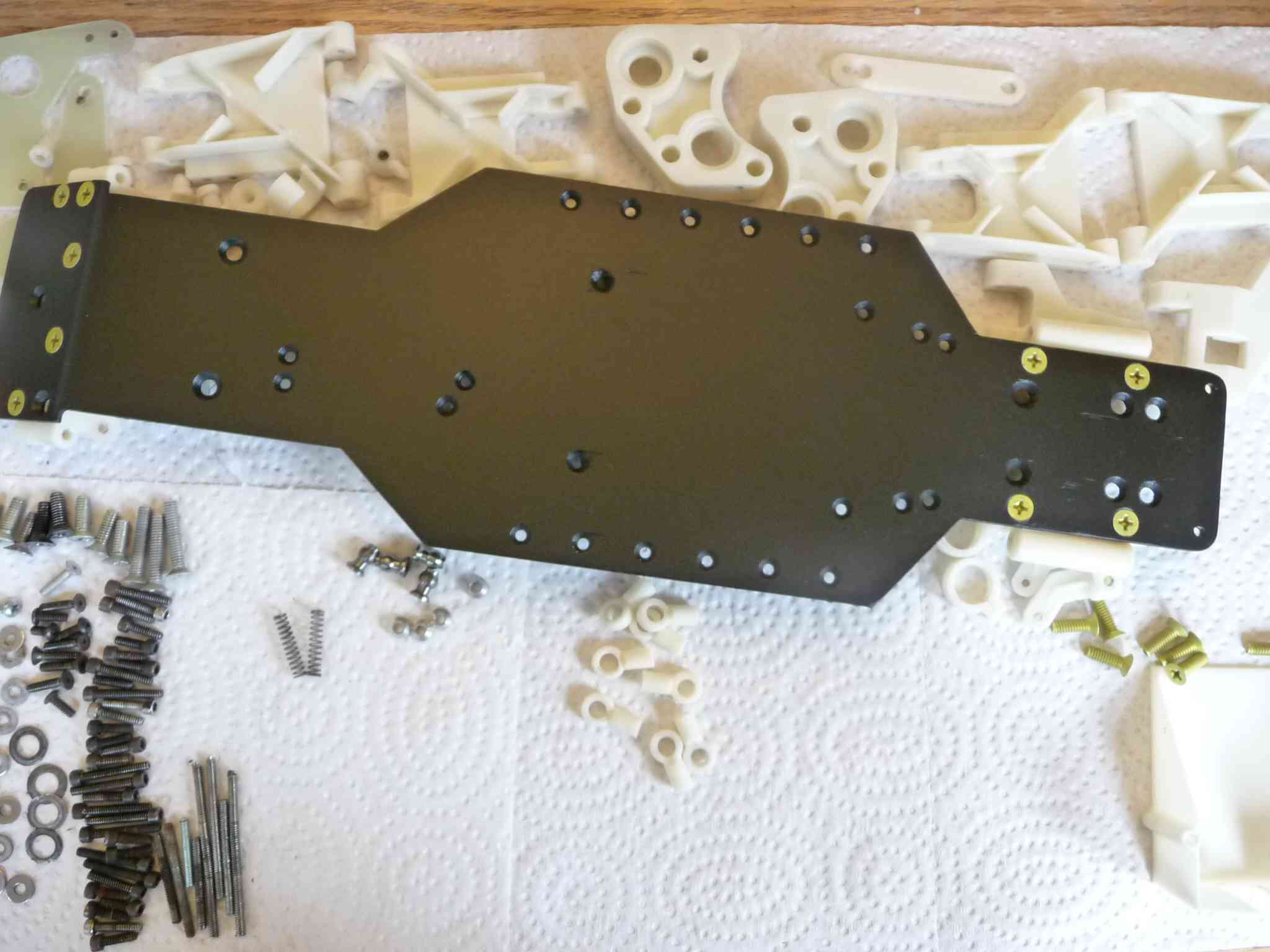

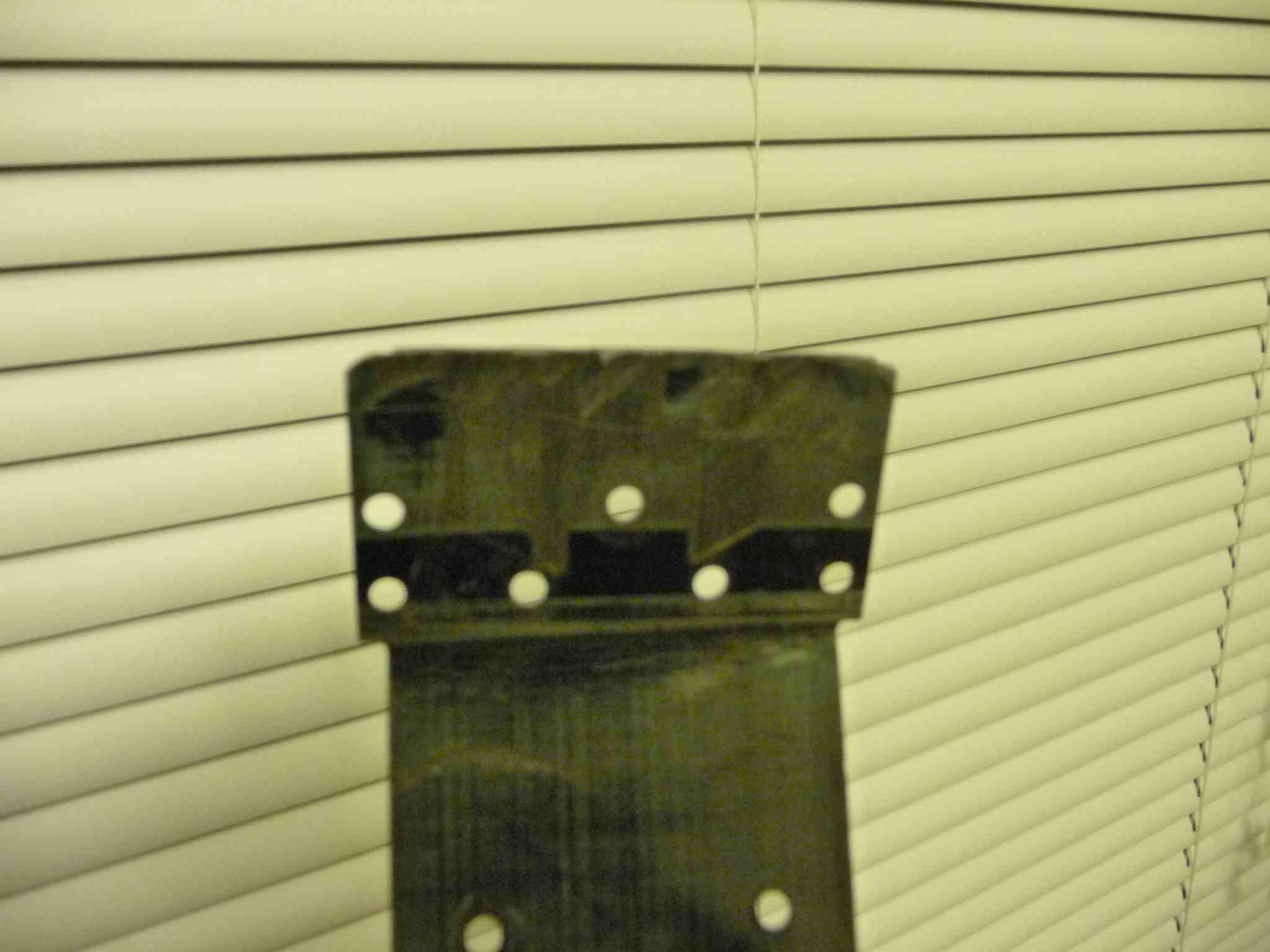

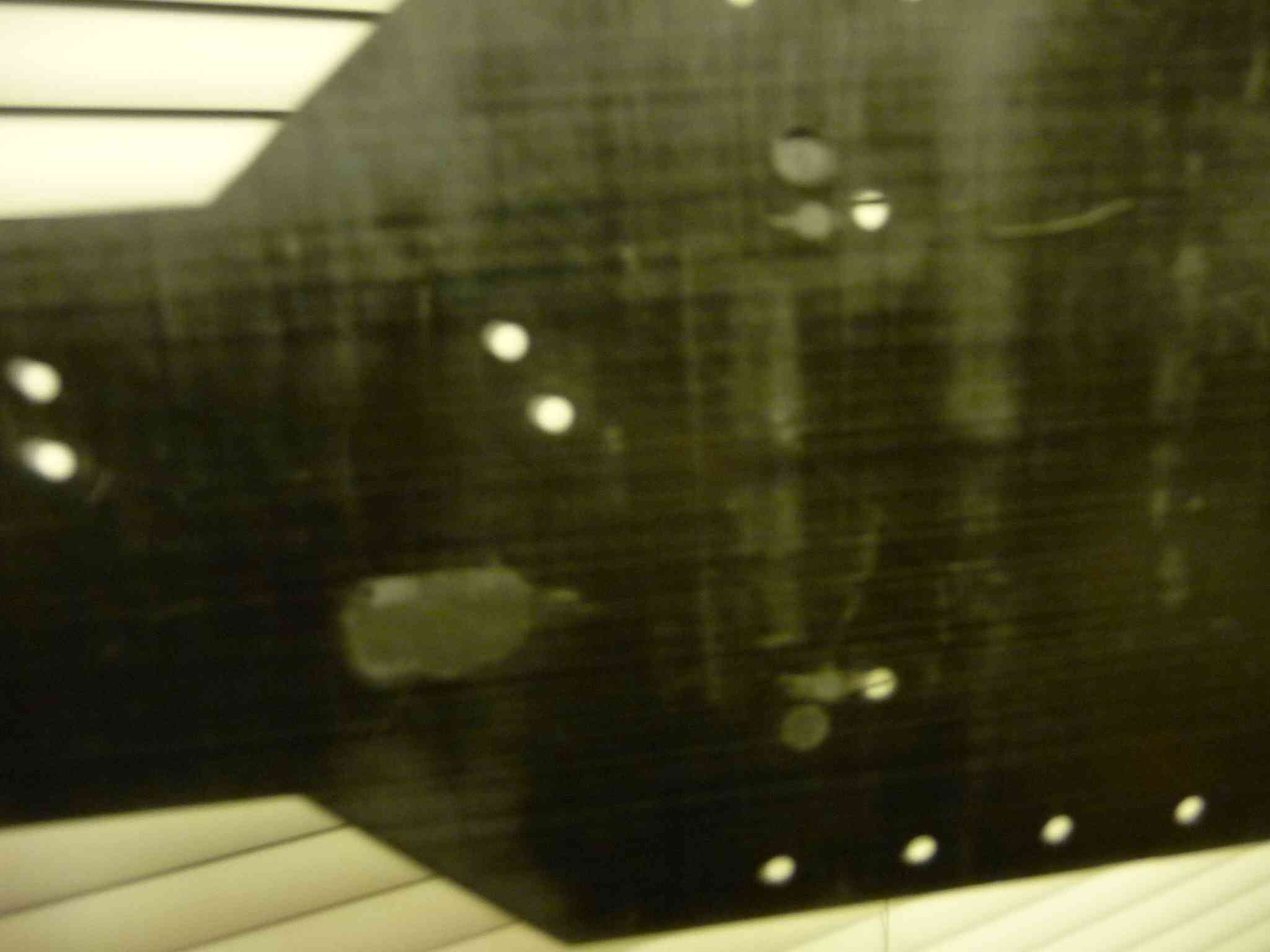

JB Weld is good stuff but has to be painted as ancansola said unless you don't care about the appearance. I just repaired this TQ10 chassis that was suffering from a lot of extra holes including a gaping wound hacked out for a servo saver. It fixed up my delamination problems too!
Gary
