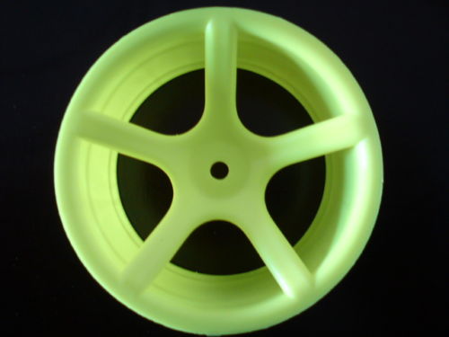

Re: Will these wheels work on a Vintage RC10
there's a guy from the uk selling 5 spoke wheels on ebay that will fit directly on your rc10. jcracing or something like that, jc-rc maybe......
I have some on the way, in black. The seller is jcracingproducts1989scr8p wrote:there's a guy from the uk selling 5 spoke wheels on ebay that will fit directly on your rc10. jcracing or something like that, jc-rc maybe......
$12.19 total for a set of fronts and rears.
I have a number of sets of those JC Racing ones... Very pleased with them.
You can see the white ones on my buggy here: http://www.rc10talk.com/viewtopic.php?f=35&t=17100

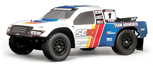

They are sweet wheels-but what I'm trying to do is have the same size wheels and tires front and rear like a 4X4 would like to make a short track truck like this, Thanks
Those rims will work for the rears but only with 3/16 axles .you will need these for the front
http://www3.towerhobbies.com/cgi-bin/wti0001p?&I=LXM871&P=M
and this.
http://www.teamcrp.net
plus 5x11 bearings
and this.
plus 5x11 bearings
those are truck wheels: way wider than the sc wheels.
But anyway an interesting link
http://cgi.ebay.com/Vintage-CRP-Frt-Stub-Axles-RC10-mountsTamiya-Wheel-NOS-/370379825638?pt=Radio_Control_Vehicles
http://cgi.ebay.com/FRONT-TRUCK-WHEEL-AXLES-Blackfoot-RC10-RC-CRP-1559-/230500585212?pt=Radio_Control_Parts_Accessories
which of those do you think is required to work with those front wheels?
I think he will need to replace the c-carrier and steeringknuckles with some SC10 parts for this conversion
HPI is not interested in making front bearing'd wheels to match these wheels unfortunately. I have sent them some emails requesting wheels that would match. you guys should all do the same thing. it's a shame, those super stars are still some of the best looking wheels period....with enough interest, maybe they would tool them, I dunno.
those wheels you showed in the first link use hex drives, and are intended for a 4wd touring car.
you can use them all around if you do the following:
in the rear, you need those hpi adapters you posted a link to. I think you need to trim the hex version slightly and it will go on a 3/16" axle. otherwise, you need to slightly drill out the hex so it will fit over a 1/4" taper axle.
up front, you would need to use a hub assemblies from either:
traxxas bandit
kyosho rb5
losi XXX? not sure exactly, but I know one of the losi versions use the right thing.
the point is, all these setups use a captured axle that is bearing supported in the hub. the axle can then be solidy mounted to the wheel and it will still spin. use whatever hex is used for the assembly you chose (ie, traxxas is a plastic hex and pin, losi and kyosho use a hex sleeve/screw arrangement.)
otherwise, you can do as suggested, and use the actual truck wheel versions, but they will have a wider profile and need truck specific tires.
traxxas bandit
kyosho rb5
