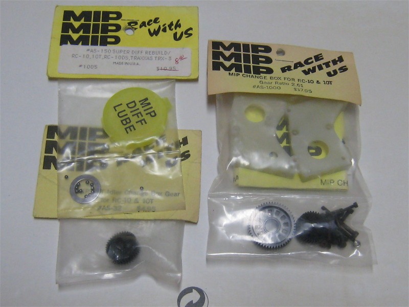

Re: MIP Transmission
first thing..... which mip trans do you have? the 2.00 sp1 or the 2.61 changebox? that would dictate which trans i'd use in a 10t.

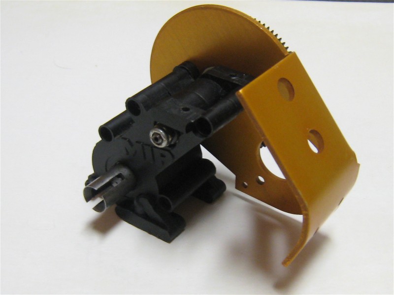

Snorman70
Posts: 49
Joined: Sat Apr 03, 2010 8:56 pm
Post by Snorman70 »
scr8p wrote:first thing..... which mip trans do you have? the 2.00 sp1 or the 2.61 changebox? that would dictate which trans i'd use in a 10t.
How do you tell the difference?
sp1
changebox
Snorman70
Posts: 49
Post by Snorman70 »
scr8p wrote:sp1
changebox
The one I have is identical to the SP1 picture.

adam lancia
Posts: 1116
Has thanked: 7 times
Been thanked: 42 times
Post by adam lancia »
RPM did 2 versions, a 1.96:1 (I think...?) and a 2.65:1. Did MIP do an even lower ratio version?
