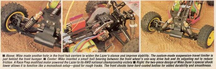

I don't remember anymore why, but at 1989 worlds at least US Yokomo drivers used monoshock at front.
Monoshock Yokomo from 1989WC.JPG (39.65 KiB) Viewed 1464 times
Similar system was also in use with Race Prep drivers cars, but it used two shocks. The front shock tower was able to swing. In pic below the two aluminium screw did lock that that system, so it was not in use. The car is from 1991 ROAR nats.

:lol: someone mounted a monoshock at the best car of its time? I would also love to know why ! Thanks for the photos by the way. I love these old articles, especially if unusual designs are shown.
