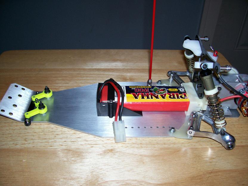

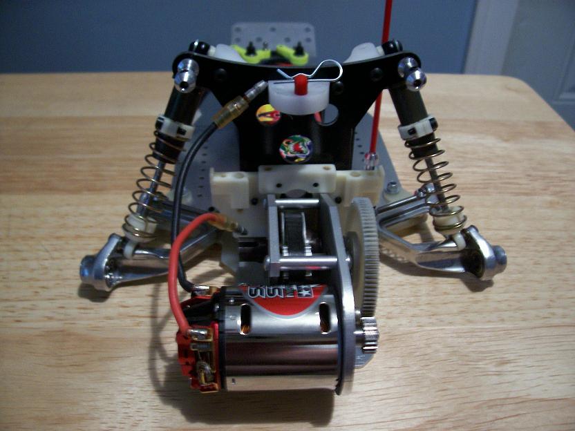

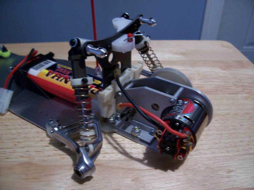

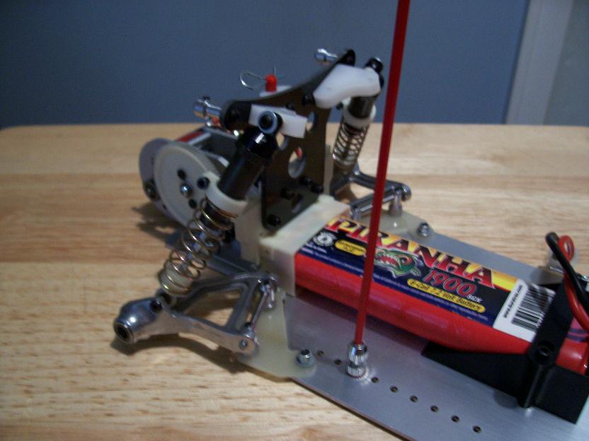

Sassy chassis with a new A&L swing arm kit. The A&L steering is used but in good shape . Have two new A&L steering kits but saving them for other projects. I have a stealth trans on hand but still undecided if I want to drill the chassis for it. So for now the trackmaster is mounted. Still waiting on parts to complete.

that trackmaster looks like it hangs the motor way out there! Should be a wheelie machine!

A dirt oval trans in a buggy. Don't plan on running it .Just a project for now.

Looking good so far. Though I have a question. Would that Track Master trans fit in a stock tub or would the motor come into contact with the motor guard?

Lowgear wrote:Looking good so far. Though I have a question. Would that Track Master trans fit in a stock tub or would the motor come into contact with the motor guard?
No they hit the rear guard. In the manual for the trans it shows one mounted with rear guard cut off and anther pic shows it with the rear guard in place . They must bent the rear guard bown on that one. Maybee that why you don't see any on a tub chassis. Trackmaster also made a direct drive trans witch is shorter in length and will bolt in to a tub chassis with no mods if my memory is correct.

I'm glad I found this out before buying one! I've been in the market for a new one for a long time now and assumed they were a direct fit with no mods. I was surprised to see from your pictures just how long they actually are.
With that being said, it looks my new focus is getting one of the direct drive ones then. Its for a DS so it works out. If I remember right the Track Master one is called the Xcaliber.
