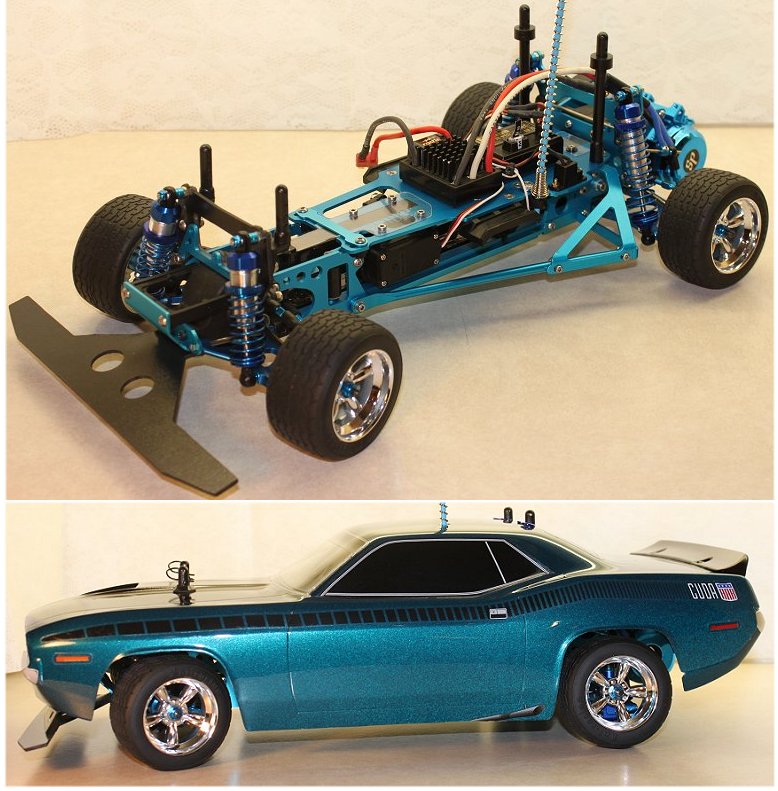

Coelacanth,I've got to ask,what is that cool beast pictured in your avatar?

That would be Project CYANide! A blue-anodized Turbo Optima fully converted and modded for on-road use.mopar marv wrote:Coelacanth,I've got to ask,what is that cool beast pictured in your avatar?
I'd originally intended it to work as both on-road and offroad, but after going through major pains to do a proper on-road setup, I decided to leave it as-is and build another car (Barney) for strictly offroad use.
