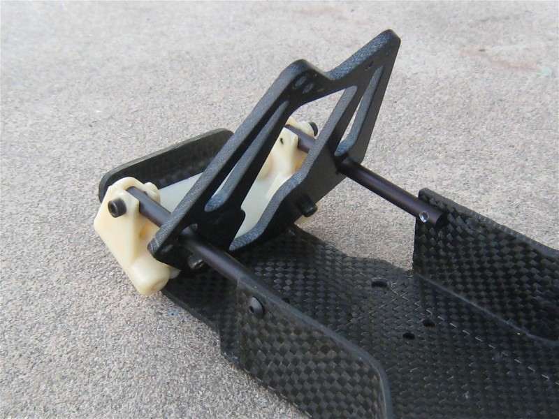

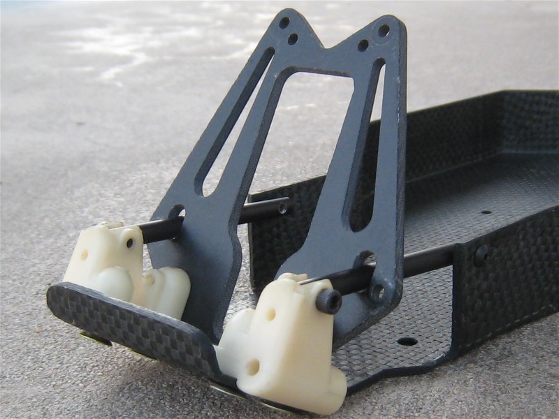

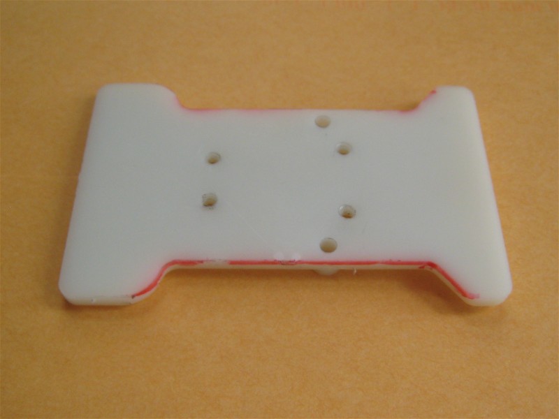

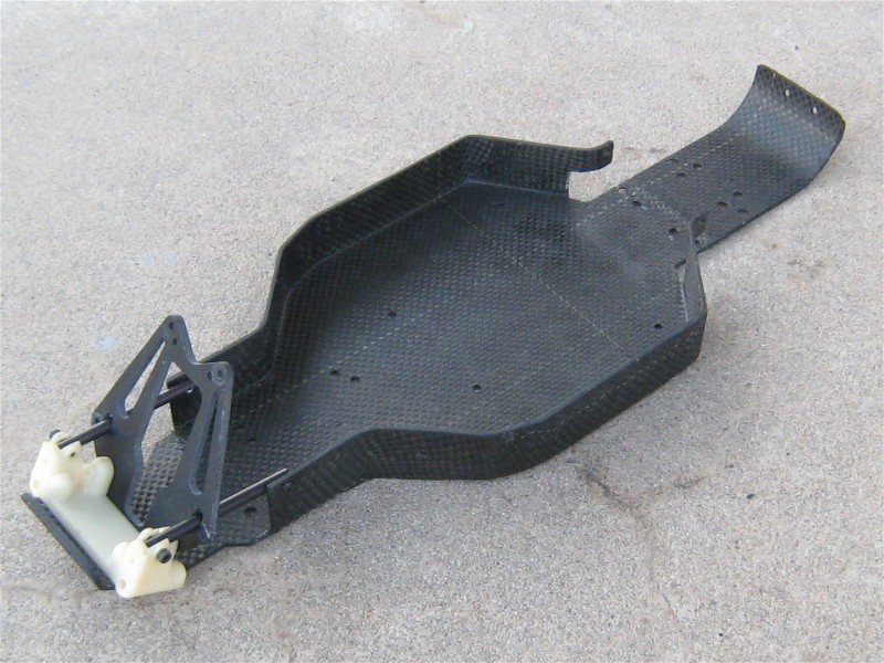

i grabbed this off ebay a couple months ago (stole it in my opinion :wink: ). the front kickup was pretty beat up. the 2 outer arm mount hole on the left side were ripped out, and the right side was close to being the same way. now, i probably could've fixed it, but the repairs would've been quite noticeable. so i decided to narrow it up to use a 10t bulkhead, eliminating the damaged areas. i also shortened up some 10t nose braces tubes. one thing i know i won't do is countersink the bulkhead mounting holes. these tubs are not very strong at the arm mount holes (front and rear). countersinking the holes will weaken it more than it already is. i plan on using an rpm front bumper on it anyway........ that is already countersunk, so no reason to do it to the chassis (imo).
now the back, i still have some work to do. i need to get a new bottle of ca glue though (all of mine is dried up).

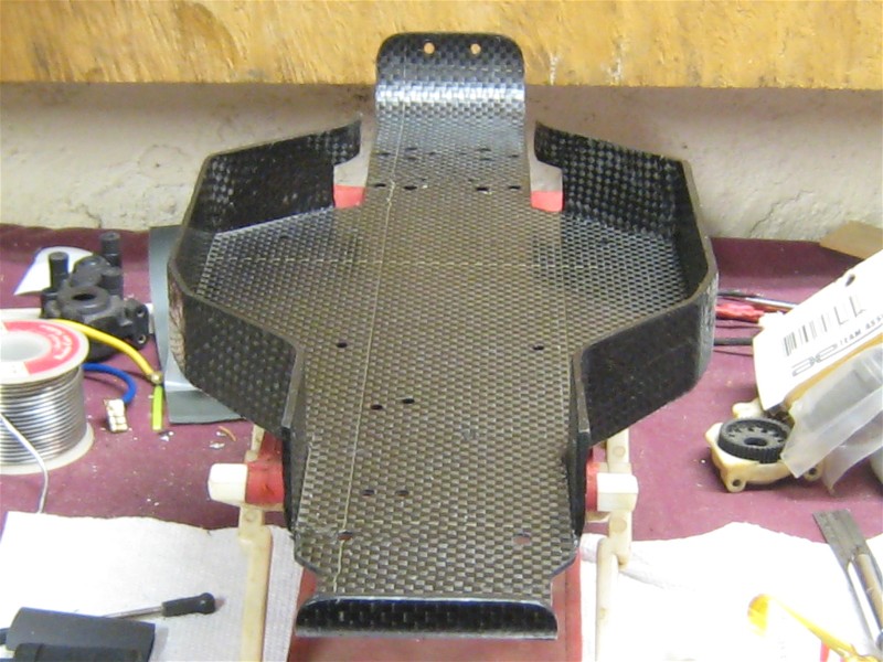

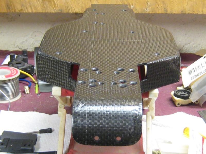

i had to run to hobbytown yesterday to get some paint, so i grabbed a bottle of ca glue to fix the rear kickup. a little sanding, reshaping, drilled holes for a stealth, a quick coat of sealer and it's done.
not exactly sure the dircetion the build will go, but atleast it'll be ready when i am.

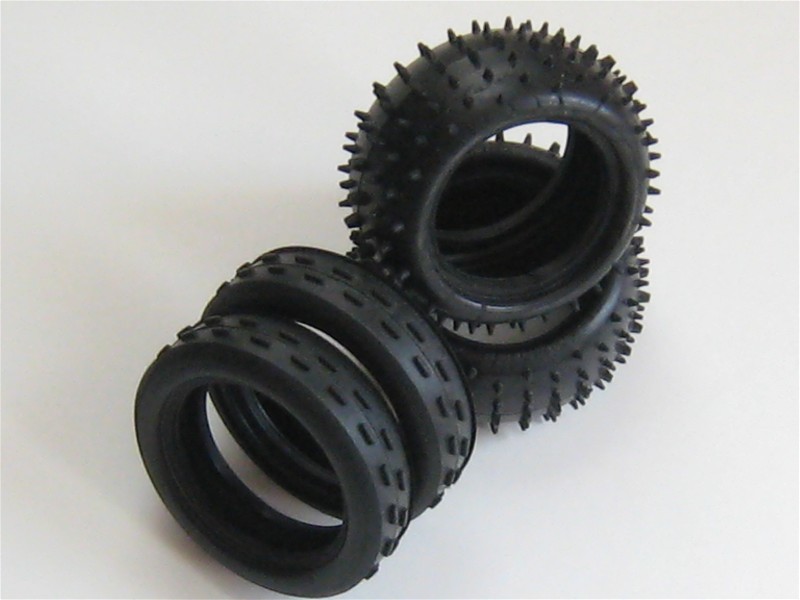

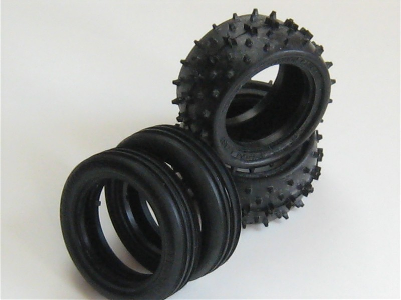

on to tires. in stock, i have a new set of losi rubber. HT fronts and x-pattern rears.
or, i have a new set of prolines. 7025 fronts and 7060 rears.

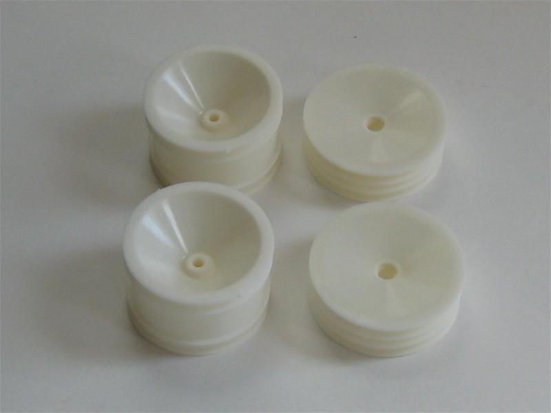

these would be used with a new set of white tq rims.
but, i also have a new pair of pink 2.2 30 series yoke rims i could use on the rear. the adapters i have for them don't give the correct offset though. the ones i need are on my masami replica so i'd have to get a pair of those, as well as figure out tire to use since i don't have any more new 2.15/2.2 tires. so what would you do? :wink:
