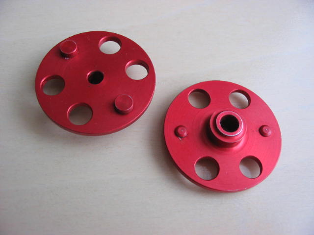

The hotshot axles will fit the kyosho bearings but the offset would make it very narrow and this might cause rubbing while steering. The adapters will give the wheel the right offset. Plus the spherical part of the hotshot dogbone is larger , and so is the cavity of the axle. So the optima dogbone would be rather loose inthere. Oh, and since the outer diameter of the cup is larger also, it might not fit the steering knuckle either.

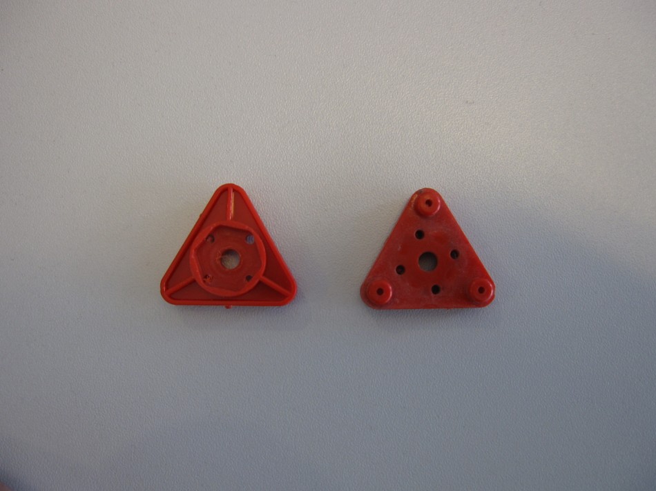

Mr ED, Yes You did recommend those red anodized aluminum wheel adapters, but they have only two brackets, I need something with three, see: CRP Does have plastic wheel adapters that have three brackets, but they are black. Did Jose for some reason paint those black CRP adapters bright red? No, I don't think so. So there must be something that is not known yet and that something might be those adapters that V12 somehow remembers.
Jirka

- Posts: 1282
- Location: EU
- Been thanked: 100 times
Re: Tamiya Hotshot wheel axel, adapter etc. to Optima?
Well I don´t just remember that adapters........ digging through my old offroad stuff I found one pair of them today.
This is what everybody was using for mounting Hotshot wheels on an Optima. I´m not really sure but I think they were made by Tamiya. No CRP or Hot Trick for sure. RW didn´t make these adapters as they made just specials gears and layshaft that time. Also their name was Nodis what changed to RW much later.
Here are the adapters (not for sale)

Thanks V12! Now I know what to search for. I did have a few tricks to try left, like pressing very hot Optima aluminium hexagon adapter against Hotshot wheel adapter to reshape it and use both adapter together, but now I don't have to guess more.
Mr. ED: I did already order a pair of CRP adapters to use them as plan B.
Mr Lexan: Yes CRP does even still have (see their www-site) adapters in various colour, but those that I need and have already ordered were black.
But now, case is closed, thank You all: Jirka
