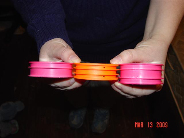

i did this to run some old losi staggered rib tires on my b4 when i had the track in my backyard. this prevented me from destroying the new soft compound tires just for some backyard practice. ll i did was cut off the inner ring off the b4 wheel and it became the perfect width.
in order from left to right
cut down b4 wheel
vintage losi wheel
stock width b4 wheel
never had any issues or problems with the wheels.
cut down b4 wheel
vintage losi wheel
