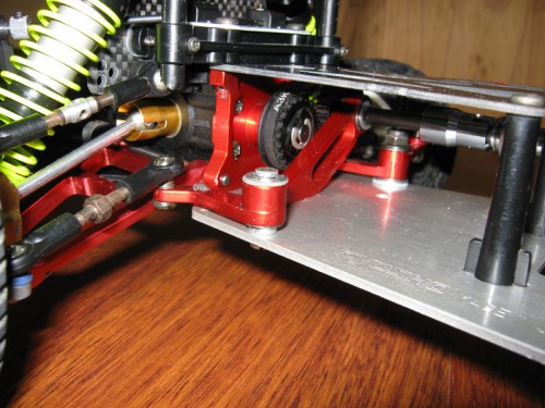

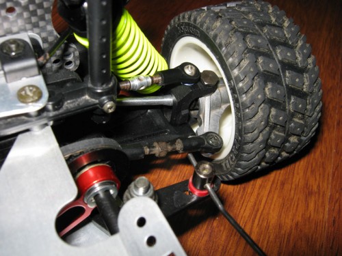

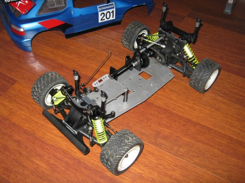

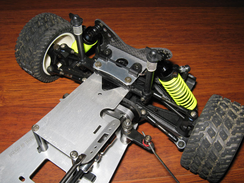

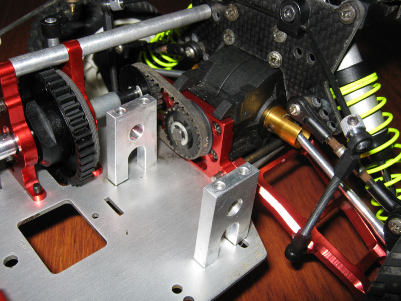

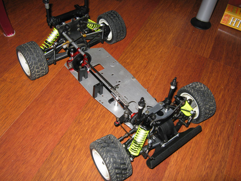

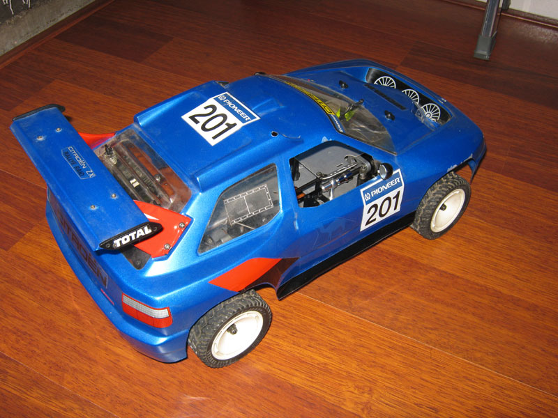

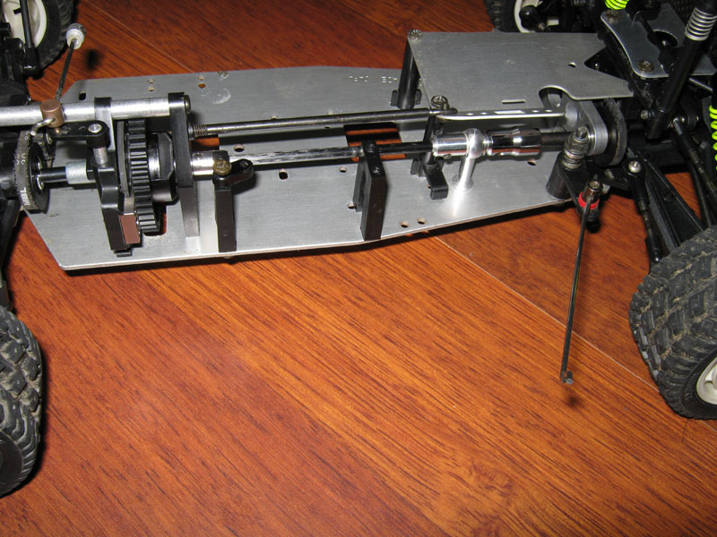

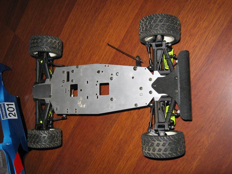

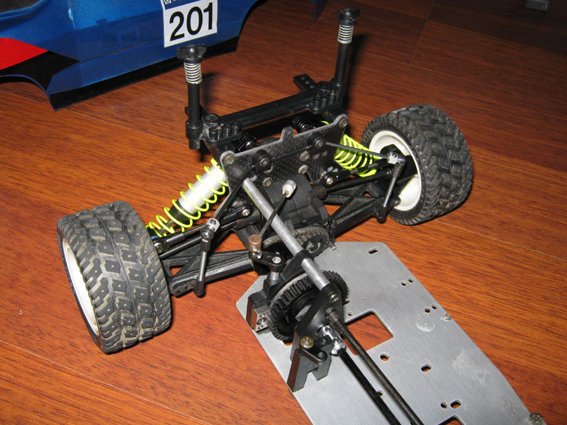

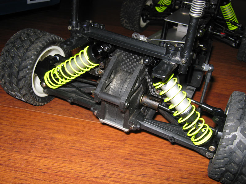

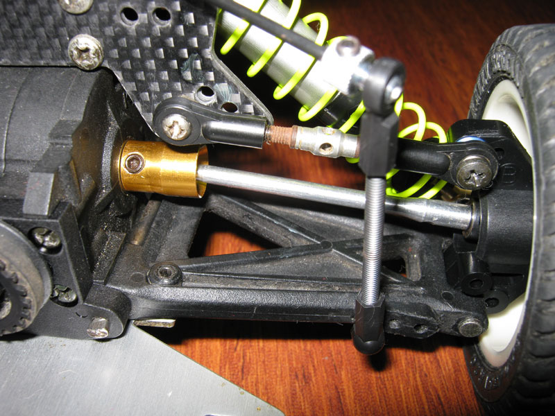

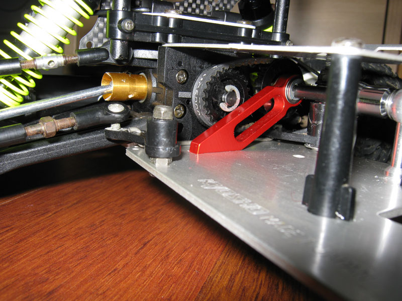

This is from the same generation of GP-10 cars as the Ford RS-200 and Peugeot 405. 4WD drive with an offset main shaft that is connected to the front and rear gearboxes using two tiny belts. Three gear diffs and Optima suspension arms. AFAIK the tires included with this car were only used on the Citroen ZX.
I actually started this project with a bunch of cool options that were included in a parts lot, and the complete car came later
Onto the chassis pics:
Upgrades installed:
- Kyosho Equalizer shocks front and rear, with Kose off-road springs meant for Tamiya Hi-Cap dampers.
- Kyosho universals front and rear.
- Full ball bearings from Avid.
- Cross hardened diff gear.
- Cross GP-10 sway bar set with Associated ballcups replacing the original so-soft-installing-them-cracks-them ballcups.
- Cross carbon fiber reinforcement tube.
- Central RC carbon fiber front and rear shock mounts.
- Central RC upgraded CF brake disc.
- Fivestars alloy/carbon main drive shaft with front one-way.
Getting the Cross sway bar set, Central RC CF front shock mount and Equalizer shocks to play nicely together required some unorthodox assembly, which is why the front shocks are attached the way they are and the front camber links are attached to the gearbox and not the shock tower.

That should be an easy electric conversion. Got alotta realestate to mount some electronics. Also gotta say its the first time I have ever seen an offset drivetrain like that. Kinda neat idea but can't say I'd put my life on the line with those belts that drive the front and rear.

Thanks. I believe the idea was to put the motor in the centerline. Unfortunately, it seems the belts were the weak point back in the day, so I'll have to see whether they can stand the power of brushless.klavy69 wrote:That should be an easy electric conversion. Got alotta realestate to mount some electronics. Also gotta say its the first time I have ever seen an offset drivetrain like that. Kinda neat idea but can't say I'd put my life on the line with those belts that drive the front and rear.

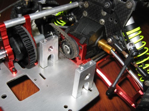

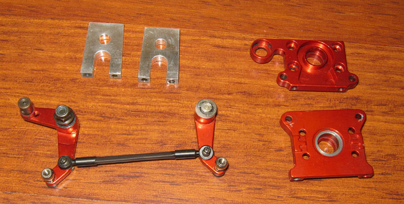

My most recent acquisition for this car:
Tons and tons of aftermarket and Kyosho parts for slightly less than what one of those hardened diff gears goes for on Ebay. Best. Buy. Ever. If my professional life only was this easy....
Ironically, it didn't include the one alloy upgrade that I thought I had spotted in the pictures (steering parts).

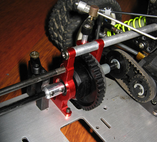

Outfitted the GP-10 with some choice bits: Alloy center diff mounts, uprights, front main axle mount, light-weight diff outdrives and universals, a hardened front diff and accompanying gears, and turnbuckles:

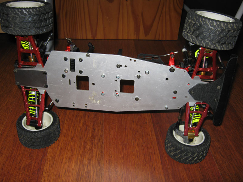

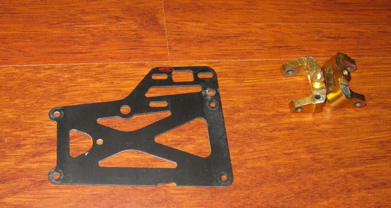

The red alloy center mounts are from a manufacturer called Racing Jack, and I managed to get almost all of their other parts (except pulleys). Also found a FRP top deck (HPI I think) and some gold alloy C-hubs by Cross.
(not shown are the alloy arms and motor mounts, see pics below)
I'm not entirely sure whether I'm actually going to convert this to brushless, since one of the donor chassis I used also came with the upgraded engine. Might make it a shelf queen instead.

Cross made all kinds of lovely gold parts for Kyosho cars, but the gold is fairly dark in general (darker than Kyosho's own gold anodizing). They had front uprights, c-hubs, rear uprights, steering bellcranks and wishbones (mostly for the Kyosho TF Spider series). There's also a set of gold alloy arms for the GP-10, which of course fit the Optima. I've seen one used set until nowCoelacanth wrote:Nice, I love the red aluminum arms & bellcrank, and of course you already know I like the gold front C-hubs & rear outdrives.
