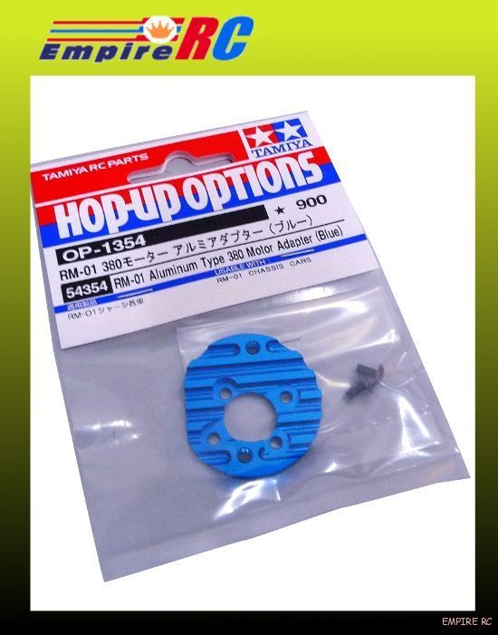

Tamiya seems to agree with JK.
This is the adapter plate they use on the rm-01 sporting a brushed 380.
Note that the moter does not go centered: unlike the 540 sized 380 brushless moters. I guess this is to allow a proper ratio adjustment for the differences between 380 and 540?
I 've found a new axle for my old plazma and am seriously considering tuning it down with a 380 and maybe even single cell lipo or a 1/16th pack. Any considerations?
Also: any ideas on where to get the sleeve to thicken the 380 moter axle for the standard 540 pinions?
- THEYTOOKMYTHUMB
- Posts: 7133
- Location: Evansville, IN
- Has thanked: 3699 times
- Been thanked: 1980 times
Re: 380 sized brushless motors
You could probably get away with using a small brass sleeve. Either drill a hole for the set screw to go through or just use the set screw to crimp the tubing on to the shaft. A pilot hole would be the better solution I think.Mr. ED wrote:Also: any ideas on where to get the sleeve to thicken the 380 moter axle for the standard 540 pinions?
