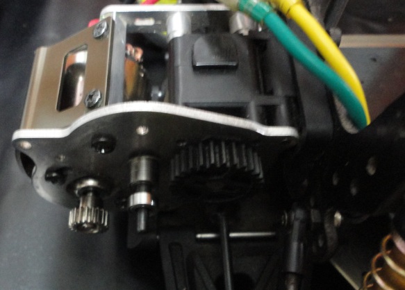

Hello, I appear to be missing the center gear collar pictured below. Does anyone know of any substitutes to part UPR-2?

I would just replace the bearings with some flanged ones. This way you don't need the center collar. You can use a thinner washer if you still want to use them.

I replaced it with flanged bearings but center gear keeps popping off, for a total of 3 flanged gears on the center gear axle

I'm very confused: how do you get 3 flanged bearings inthere? Please put up a picture.lebowski770 wrote:I replaced it with flanged bearings but center gear keeps popping off, for a total of 3 flanged gears on the center gear axle![]()
The only thing that collar does is to prevent the standard bearings to slide further into the centergear.
Get rid of the M4 washers and put 2 8X4 flanged bearings in the spur: 1 on either side and a smaller washer and o-ring at the cover side

There is no reason to use that spacer. If you have TWO flanged bearings, and the appropriate washers (for spacing on the shaft) then you will be fine. Don't waste your money on the spacer! -Jeff

Thanks Ed, can you please send me a link to the 8x4 fanged bearings you speak of?Mr. ED wrote:I'm very confused: how do you get 3 flanged bearings inthere? Please put up a picture.lebowski770 wrote:I replaced it with flanged bearings but center gear keeps popping off, for a total of 3 flanged gears on the center gear axle![]()
