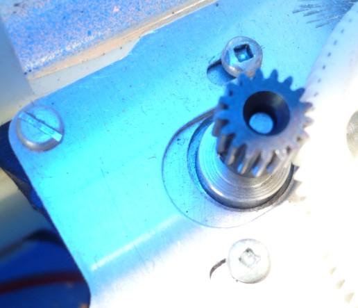

Are you talking about screws like this? I know someone who bought a car with these screws and is not able removing the motor because of the missing tool. We always wondered what sort of screws this is.
