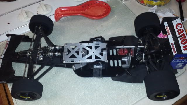

Heres a shot of the inside of the wheels...
They are actually very smooth around the edge. It doesnt sound too difficult to mount the foams, it just makes me nervous doing it for the first time with wheels that I'll probably never be able to replace if I mess up.

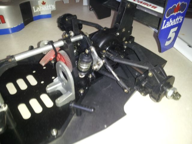

what are those extra forward links on the front suspension shock bellcranks? Looks like a really neat car. A sweet brushless system would rock!

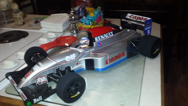

Well I finally found a set of NIP original tires. They cost me a small fortune, but man do they look great!!!
