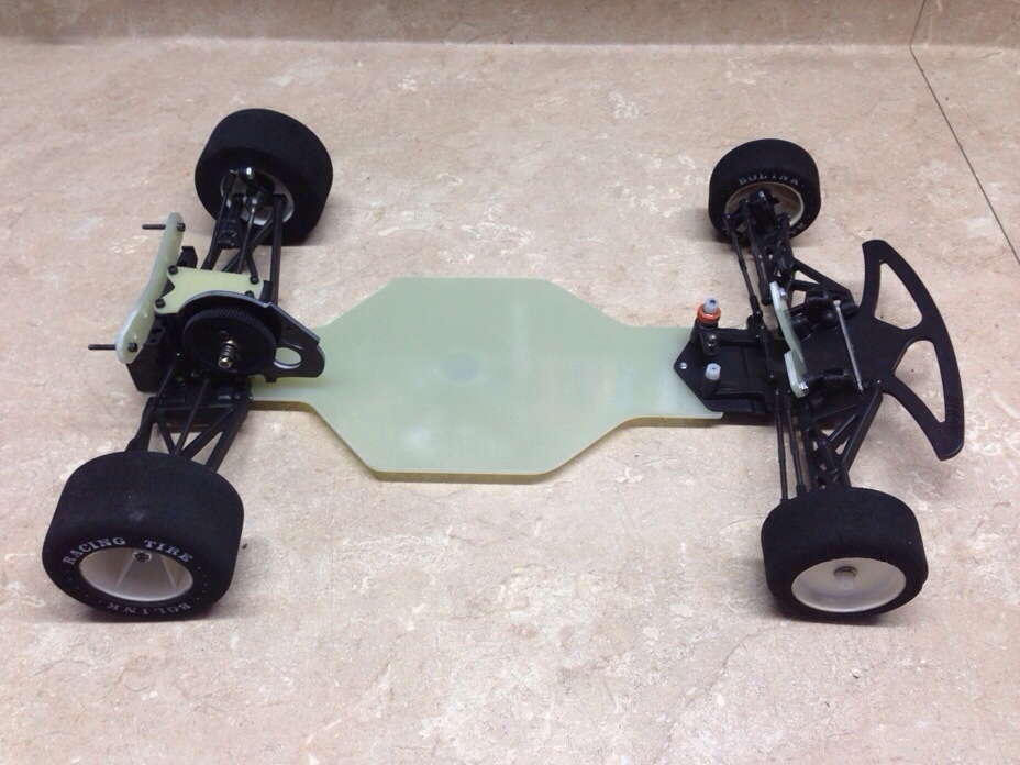

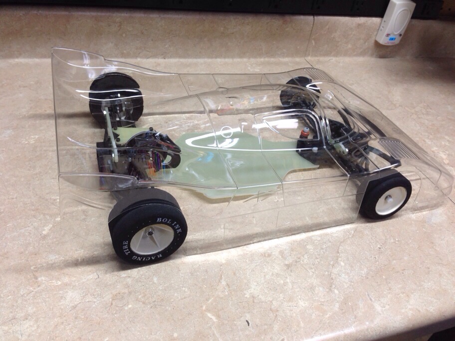

I cut a longer chassis- about an inch or so. It's only slightly wider than i would like, it would be far too narrow with buggy arms. I am building it mid motor too btw. In the rear I'm using a oval buggy tower and need to source some of the gt/t2 arm adapters for relocating the shocks. In the front I have not made a tower yet
I am not happy with the look, it's just not "right" so I haven't bothered with pics yet.

That looks great! front looks pretty good. Are those front wheels flipped around backwards to decrease the offset?gomachv wrote:Again, not happy with it so far- just mocked up

Nice! It took me far to long to realize why that's not possible in the back...
The B4's rear arms are about .5" shorter than the T. You would have to make some creative mounts though

If you ran the bbs adapters you may be able to but you also may run into clearance issues. Running them in the regular manner would make it way too wide
