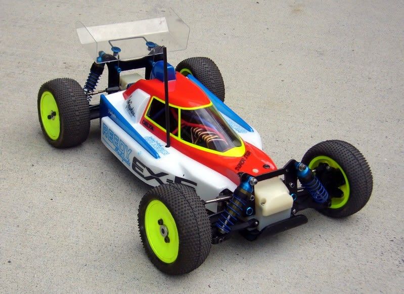

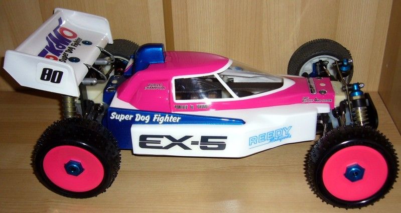

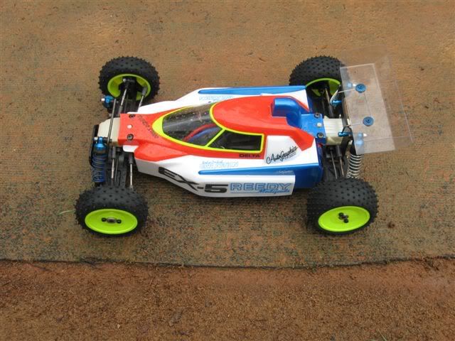

Sorry the pics aren't very clear but I am running 91 model arms and hubs on this 870c. This allows the commonly found 2.2" wheels to fit this car.
The offset was always going to be a problem when using the kit standard items. This mod has worked really well for me.

Very cool. Thanks for posting those pics and explaining your solution.
