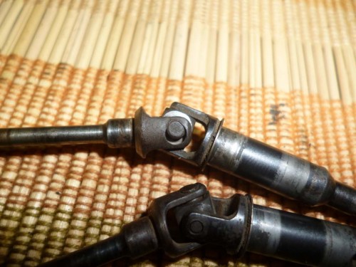

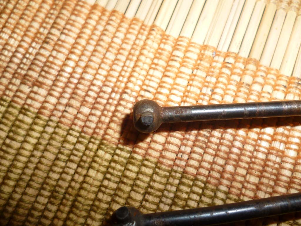

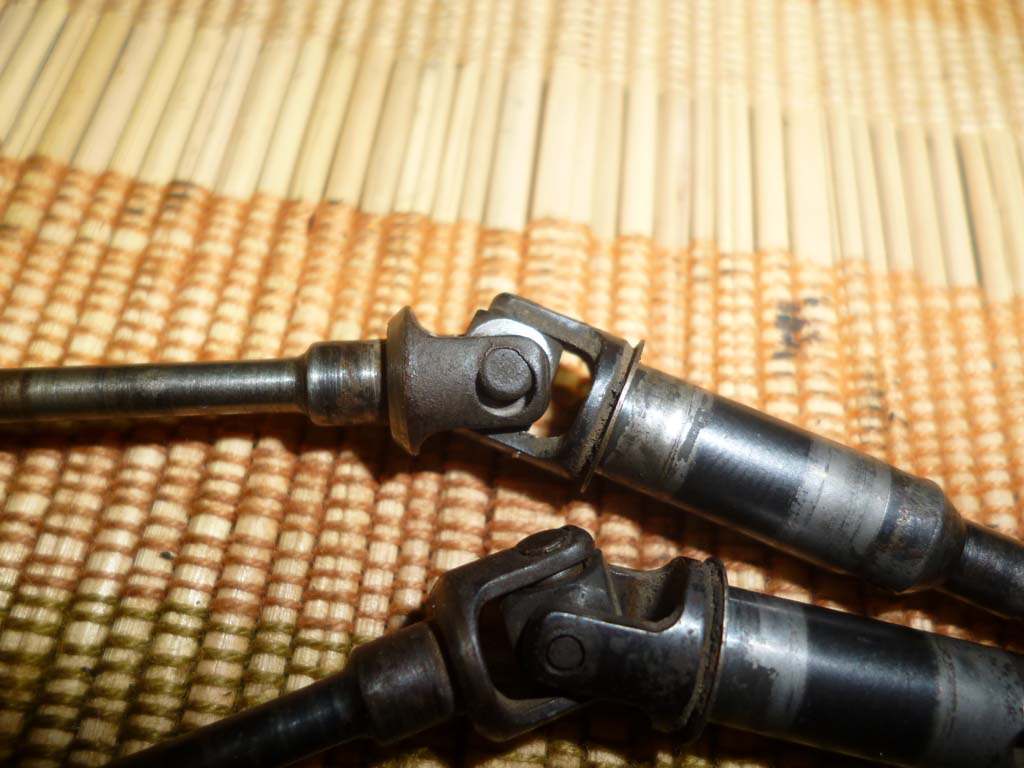

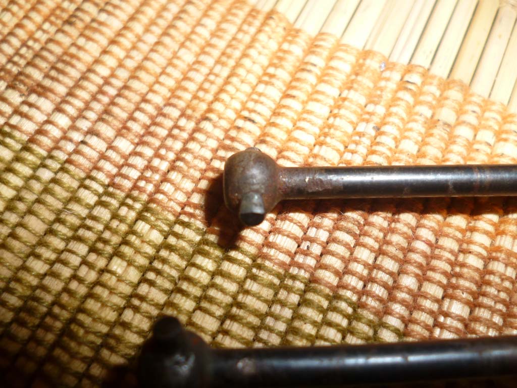

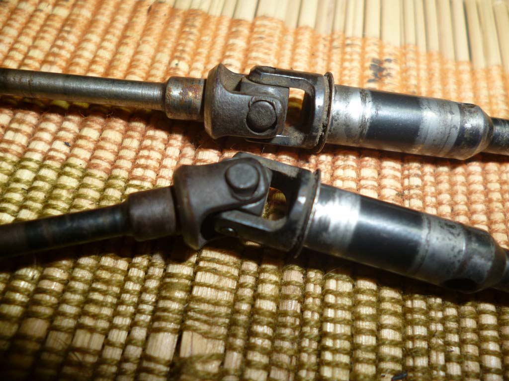

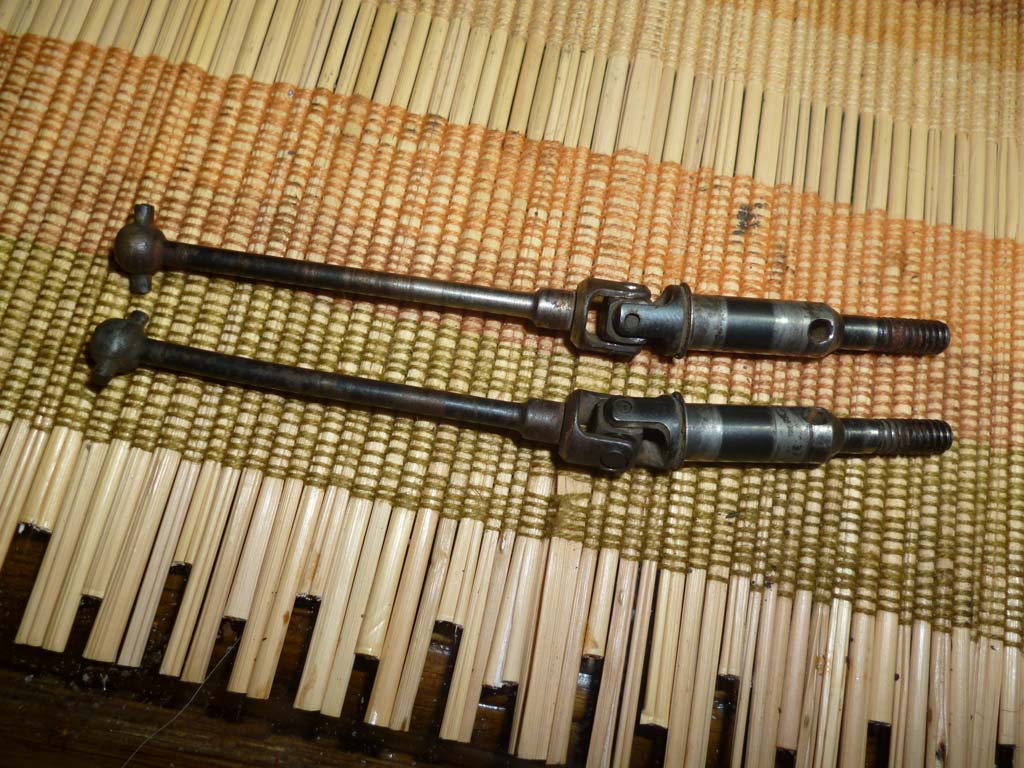

With you guys help I have been rebuilding a few RC10's. I have a graphite That I have been working on and I have a few questions. Take a look at the pictures below. As always any help is appreciated.
My first question is Are they totally shot?
Secondly If they are can they be rebuilt?
Third and most likely what is the best replacement that is readily available
Thanks, Stinger.

As long as they are straight you should be fine.

they will "work" (read: the wheel will turn when the diff outdrives turn)... but they are terribly worn out and the binding will cause some interesting sneaky handling traits. No they cannot be rebuilt.

you can find lots of replacement universals on ebay, in better condition that what you have. Used like the pair you have, or you can move to a CVD type. MIP still sells the 1/4" axle CVD version for around $25.00.
http://www3.towerhobbies.com/cgi-bin/WTI0001P?I=LXAV59&P=8
if aren't building a 100% correct car and plan to run it, I'd go with the CVD's. They are rebuildable to a point.(once the holes are ovaled out, they also get worn out, but you can replace the guts and those parts tend to wear faster then the axle and bone)

Thanks four all your help. This is going to be a basher. Went with the MIP 1007's.
