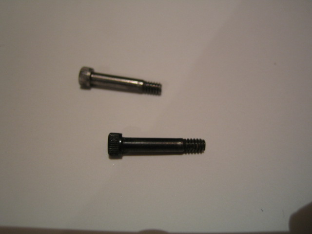

I was cleaning out one of my gun safes the other day and found my blueing touch-up pen for steel barrels. I had an idea to try it on some turnbuckles and screws I had stripped the rust off of. I went over the parts with my dremel with a soft wire brush. Then I degreased the parts with motor cleaner. After a couple of passes with the pen, viola. It takes a few seconds for the reaction and multiple passes deepens the color. After a few minutes, I lightly hand buffed the excess off and coated them in Break Free. The more you buff the more shine you will get. I went over one with the dremel again and it was almost a gloss black. I had a jar of "cold" blueing liquid at one time. I am going to get some more and see if it does the same thing so I can bulk dip some parts.

Before and after screws.
