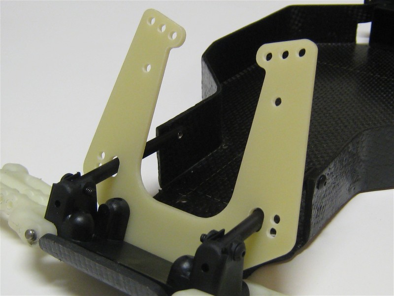

if you're using a graphite chassis, not that they are easy to find, but you can use an andy's pro race front tower and run .71's.

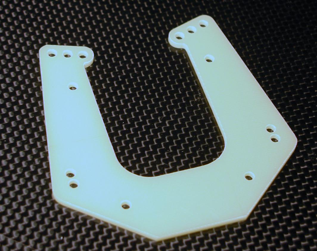

i drew this one up on paper awhile back, bscotti drew it up in CAD, and atlas cut it for me. this one is for .89's.

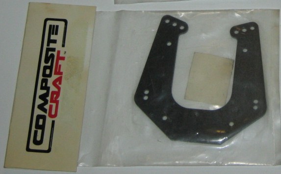

this here is the super rare composite craft worlds tower reggie was talking about.
i sent it to bscotti to have him draw it up in CAD so copies could be made. Jay Dub handled those duties. made 2 different versions, one with and one without nose brace tube holes (the way the rpm towers were offered).

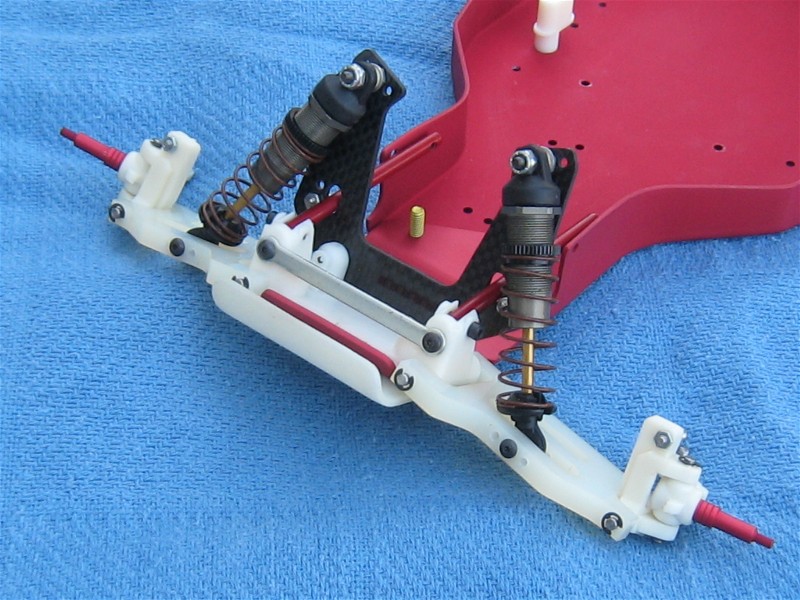

Yup, you got it. I tried a set of custom works arms which are shown in that pic above and although they fit with minor trimming (for travel) the shock mounts are too far out to get good suspension travel. Now, with a 1.02 shock and truck tower they would probably be fine. I have most everything to mock it up I just haven't gotten around to it.

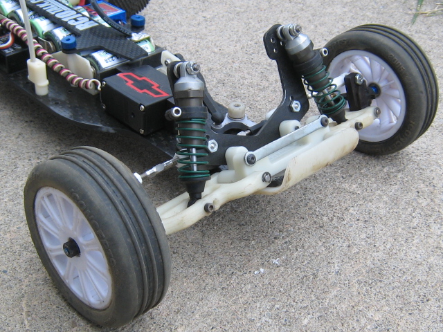

That was probably me talking about the truck tower. The RPM tower is wider across the top and solved most my issues with using truck shocks up front.gomachv wrote:I would swear that I read somewhere that the truck tower geometry is not great for a buggy, yet that's basically what rpm had. Did I read wrong or what is the deal with the towers geometry that isn't liked? I assume it has to do with the shock angle
RCCW front tower & 10T tower (yes, I cut the center out for a better buggy body fit)

I used both .89 shocks and 1.02 shocks - not at the same time, this was to "demo" the 2 sizes.
