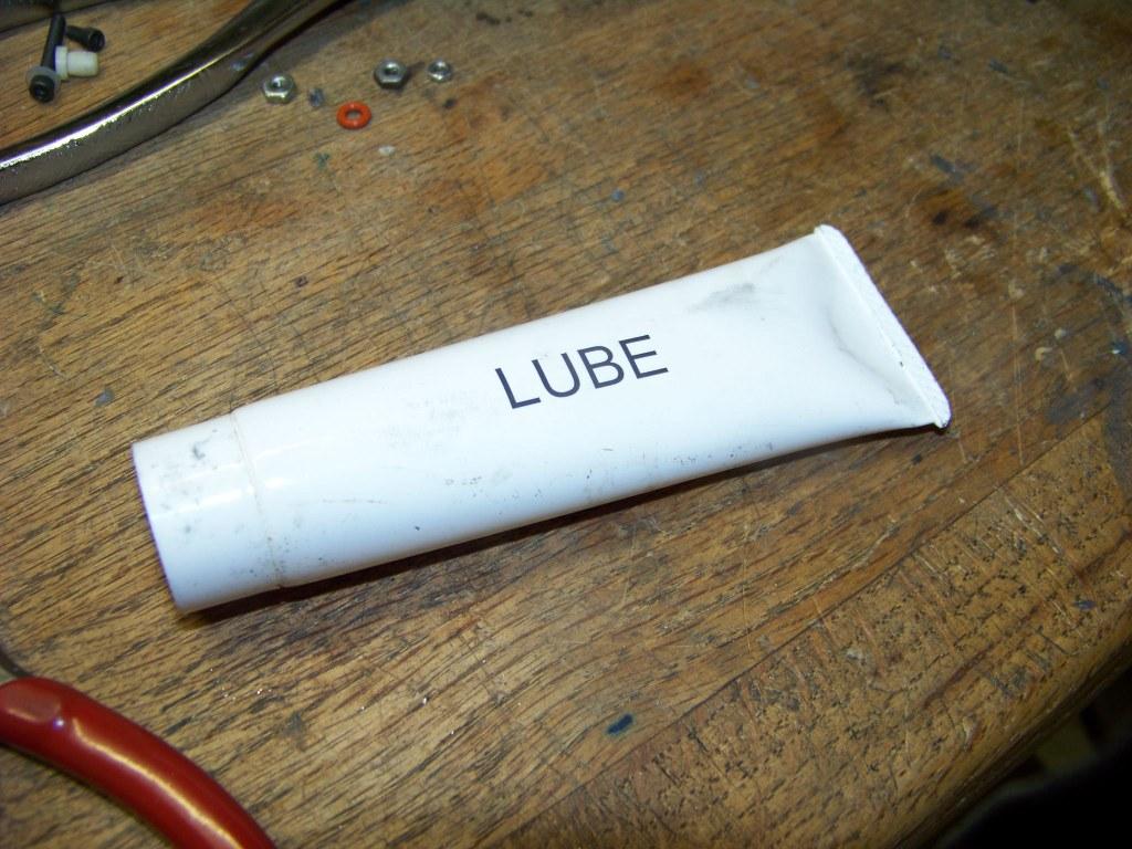

You ever buy a lot of ebay to get the car but end up with the tool box too? This came with a lot I got a while back. Who knows where it's been, or what it's lubed...
