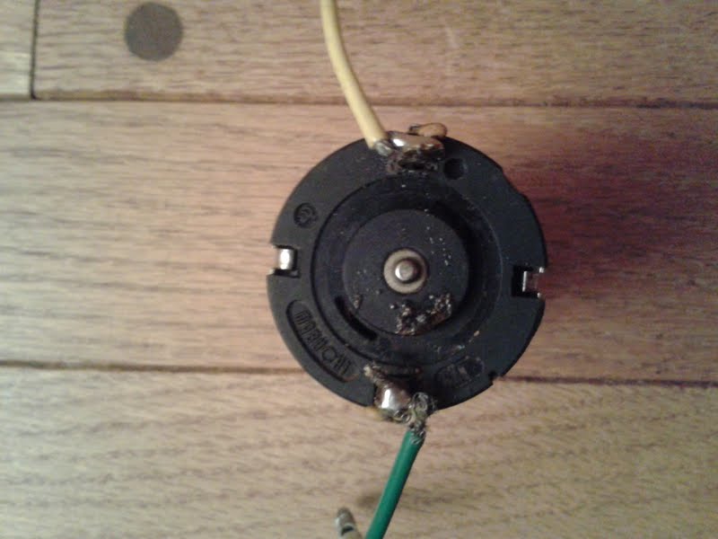

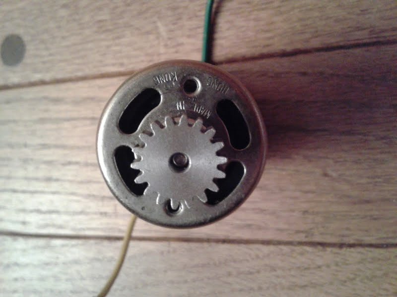

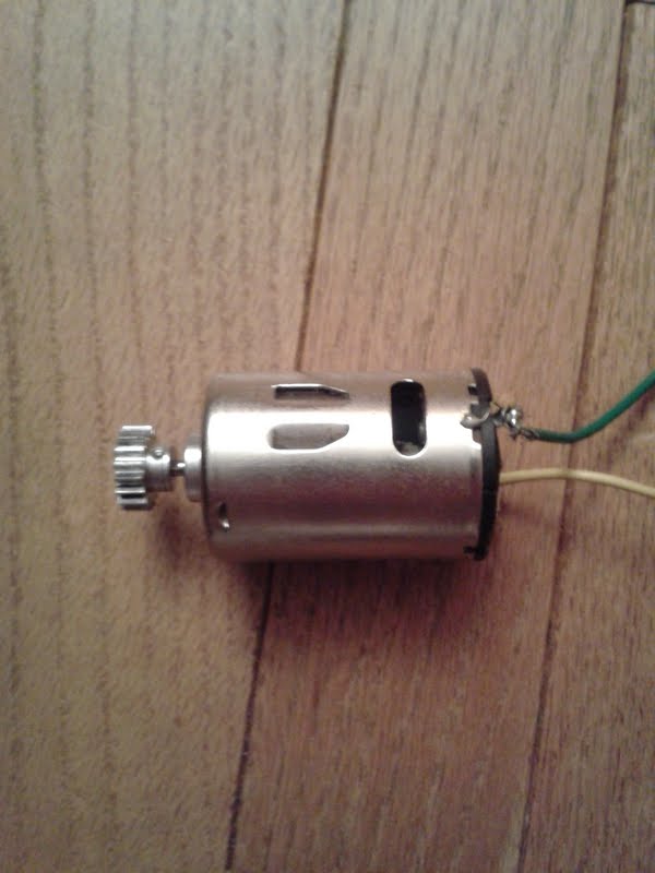

here is some pictures of the motor

Yep that's the stocker. 15 minute run time on old school batteries at moderate speeds. It would love a hot stock motor.

It's just called a 540 Mabuchi. Same kit motor most Tamiyas came with.

okay thanks. I noticed that that motor is a little more open then the one on it. will that matter in the sand??

We used foam filters or ace bandages wrapped around the motor to let it breath without getting dirt and sand in it. Any of those medical wraps that breath should be great, just one layer and a band or zip tie around it to hold it.

If you want to slow it down for your dad, look for the stock RS380 motor; it looks just like yours except about half the size, with a brass gear and a little plastic adapter plate. Should be easy enough to find one.
