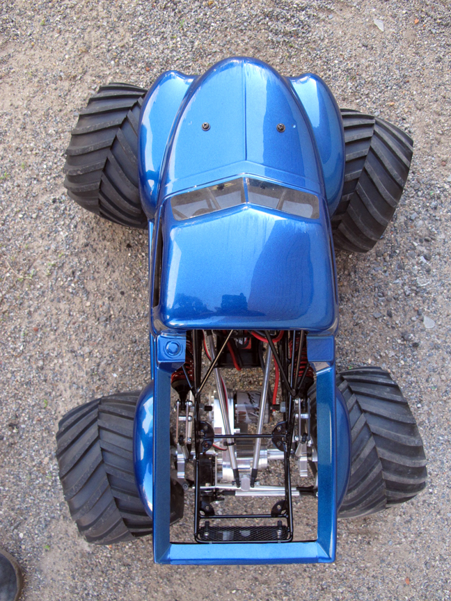

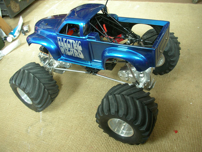

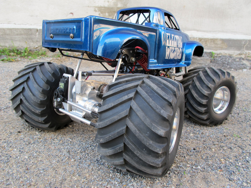

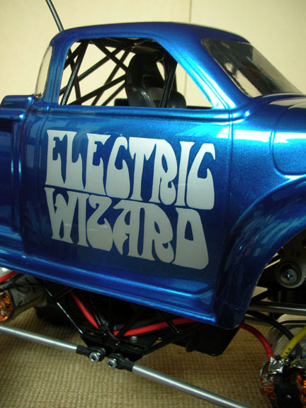

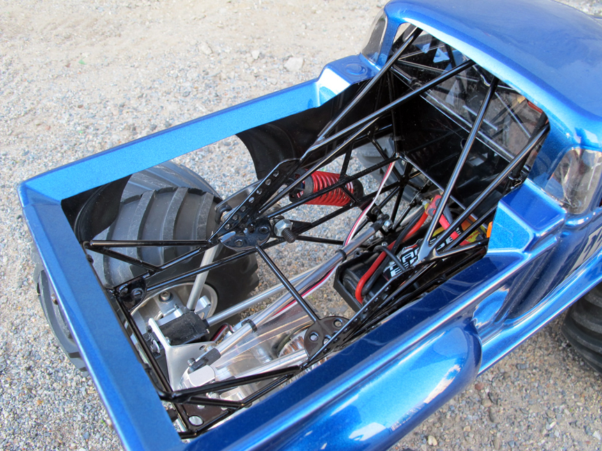

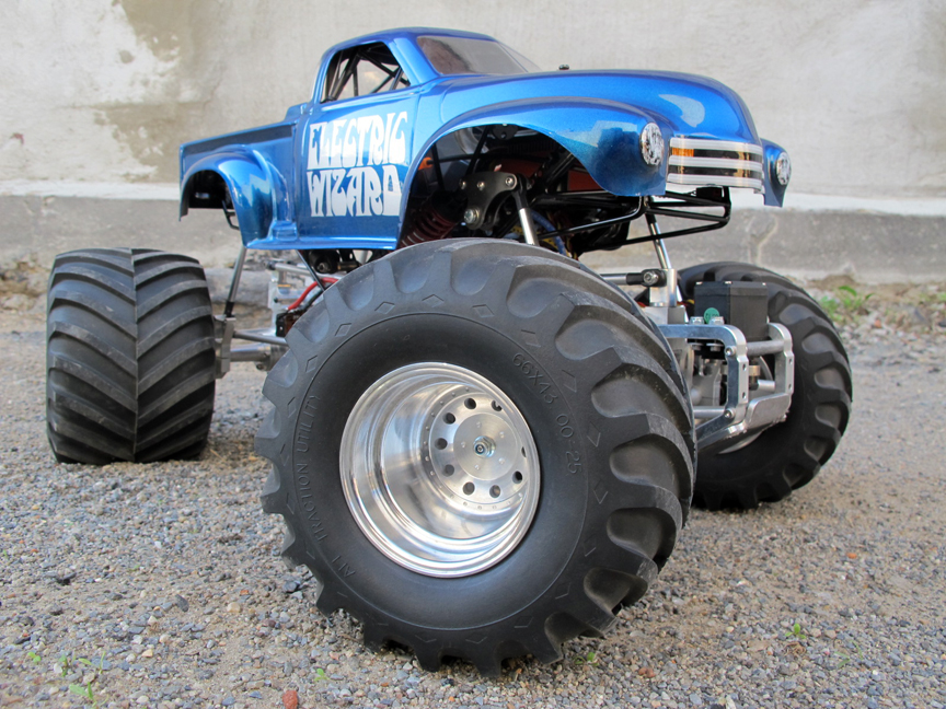

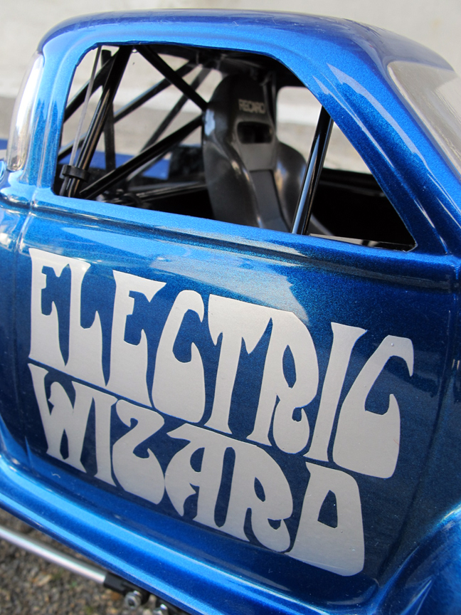

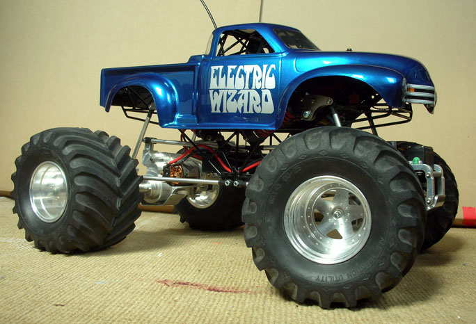

A little update. A couple weeks ago I made a runner body for this truck. The summer is gone and it's looking like I might not be able to actually run the thing till next spring now. So, I figured I'd post some pics of what I did, until I can finally get some action shots.
The Proline 50's Chevy pickup body fits this chassis like a glove. I cut the bed out to show off Boyer's tube work, and also that way I can change the battery without removing the body. So, the body is screwed on so you don't have to look at body clips. I painted the body Tamiya metallic blue, and backed it with black. It came out really cool looking. I decided to give it a name, I went with Electric Wizard. Electric Wizard is one of my favorite bands, they're really heavy, and really good, and I thought that would be a good title for a monster truck. The name is painted on. I took one of their logos off some album art and had it printed backwards onto bumper stickers on cafepress.com. Then I just stuck the bumper stickers to the inside of the body and cut the logos out with an x-acto knife. I'm really happy with the results. It made for a nice simple and clean body, just my style. 8)
I can't decide which body I like more now. This one will definitely be a runner when the time comes though. Now I'm even more happy I went with the 5 star wheels, the pentagram-like design goes well with the Electric Wizard theme.

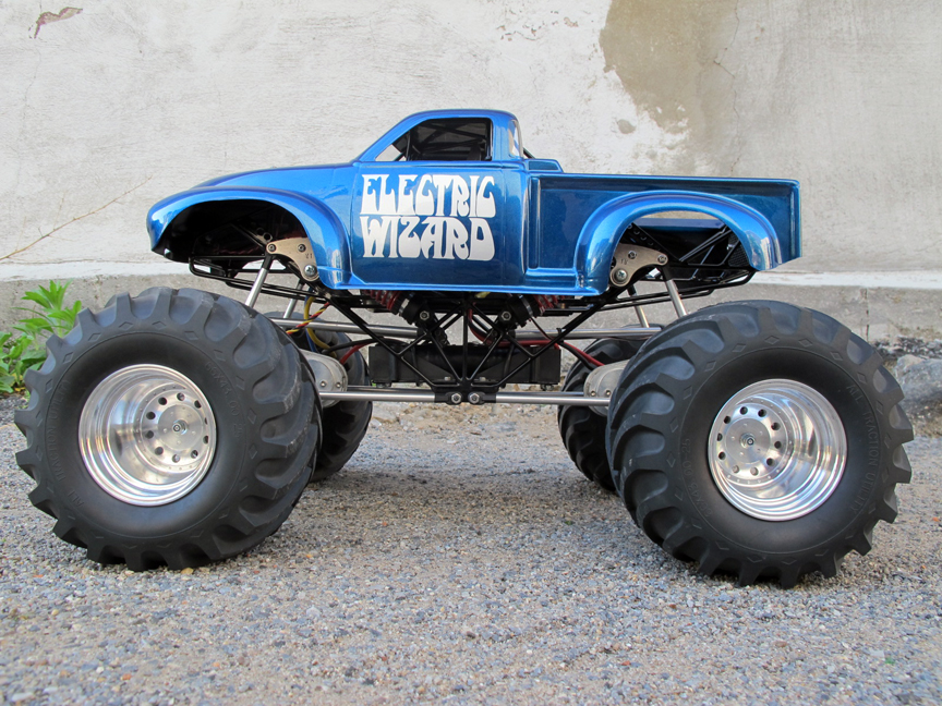

Re: 20th Anniversary CLODBUSTER, updated 05/09/11
Post by MelvinsArmy »

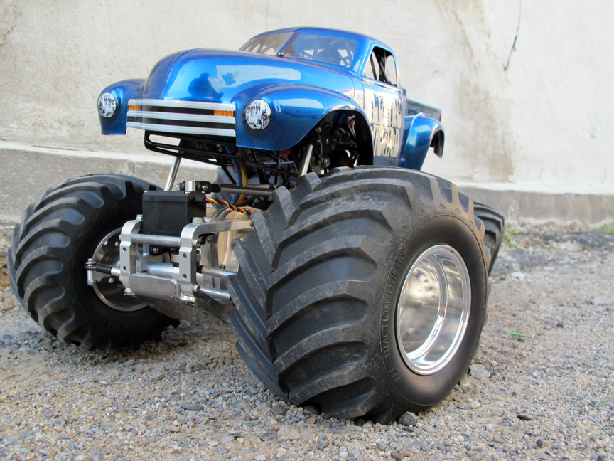

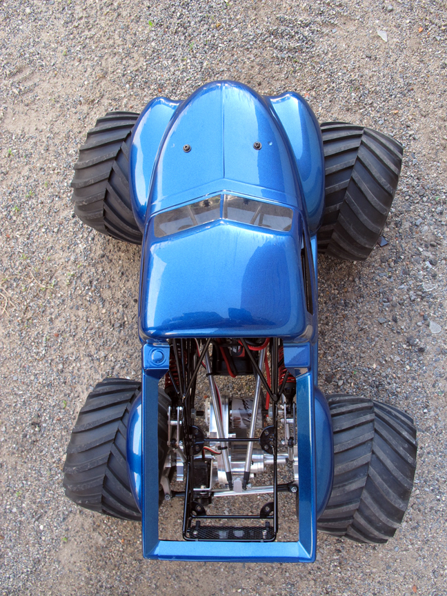

I made a few changes to the Clod over the past few months. I decided I wanted a monster with independent 4 wheel steering so I could have 4ws, 2ws or crab steering. That meant the TTR straight axle in the rear had to go, which meant the front CVDs also had to go because they widen the truck the same amount. I put the stock axles back in and fabricated a rear servo mount out of a junk RC10 chassis. Then I found some dead mint vintage Sees aluminum wheels. Those are my all time favorite Clod wheels, so I bought them and put them on my truck. Here's a few updated pics. Sorry no action pics. I can't take pics at the same time as using a 2 stick radio, only when using a pistol.
