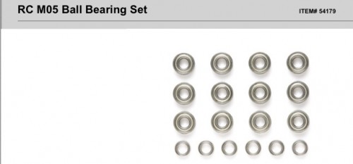

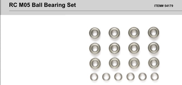

ya.. plastic bushigs from what i can see ... im a little confused on what bearings to get .. i looked on ebay but it lists a 14,16 and 18 pice kits for the m05 kits
the track in town races these if there is enough intrest this winter so we will see

Yeah, what M5 said......integra22t wrote:ya.. plastic bushigs from what i can see ... im a little confused on what bearings to get .. i looked on ebay but it lists a 14,16 and 18 pice kits for the m05 kits
Going from the manual, there's six for the gearbox (2 x 1150 in holders in the chassis, and 1 x 1150 and 1 x 850 in each of the spur and counter gears), four in the steering (4 x 850), and eight bearings in the front and rear hubs (8 x 1150).
So, you're looking at a total of 12 x 1150 and 6 x 850 bearings. That's your 18 piece kit right there.... I would imagine the 14 piece kit does not include the steering. Not sure what the 16 piece would be!

Possibly..... other thought I had was all the bearings except for the chassis side bearings that the front axles ride on. Seems a bit weird to provide an opening for a bearing, then change the size of it with a spacer..... must be some sort of option part that fits in place.gomachv wrote:Just the steering bearings you see? LolIncredible_Serious wrote: Not sure what the 16 piece would be!

thanks guys .. ill look into the 18 piece kit more .. it not tamyia better know what they are doing lol
