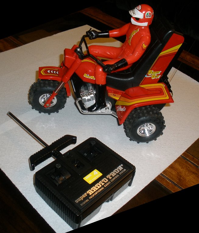

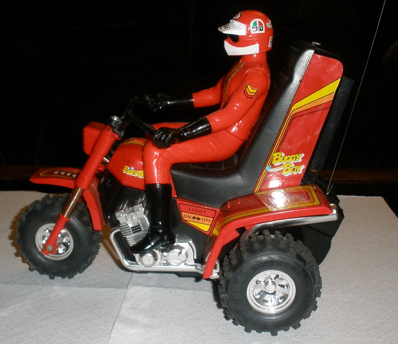

Here's mine, kept it all these years...my parents went to Japan and brought this back for me for Christmas. I'd had several toy-grade RC's before, but this was a different level entirely. Not quite hobby grade but probably what started to really get me serious about RC. The 6 C-batteries fit in a case inside the seat that could be positioned horizontally for fast driving, or moved vertically into the back of the seat to do wheelies. It has a wheelie bar, working lights, and you can sort of position the rider to do stunts. It's BUGGY BOY!

Reminds me of Wheelie and the Chopper BunchCoelacanth wrote:Here's mine, kept it all these years...my parents went to Japan and brought this back for me for Christmas. I'd had several toy-grade RC's before, but this was a different level entirely. Not quite hobby grade but probably what started to really get me serious about RC. The 6 C-batteries fit in a case inside the seat that could be positioned horizontally for fast driving, or moved vertically into the back of the seat to do wheelies. It has a wheelie bar, working lights, and you can sort of position the rider to do stunts. It's BUGGY BOY!
