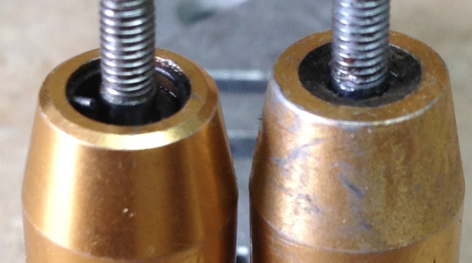

I was told they were Kyosho, but I won't know until I tear them apart and check the pistons/seals :)
They aren't leaking at ALL, even after all this time (still mostly full of oil), so I'm suspecting that they are actually Kyosho golds, which would be cool!

Just looking at the bottom spring keepers on the shocks, I'd say they were Kyosho. Of course somebody could have swapped them out.

Easiest way to tell without taking apart is to look for the bevel at the bottom of the shock. Kyoshos do not have a bevel

So... The fronts have a bevel
but the rears do not.
Looks like I got a mixed-set :p
It doesn't matter to me, either way. I'm going to use them on something that runs, because I love the look...
I just think it's sort of funny that I have both on the same vehicle...
