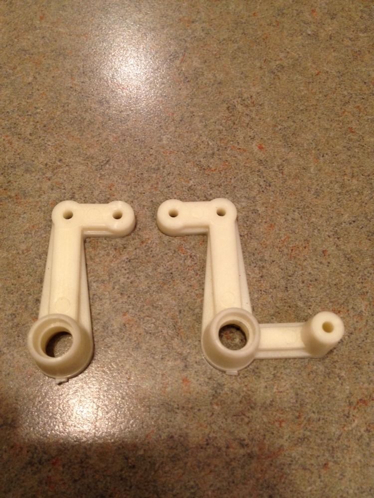

What RC10T steering arms are these?
I bought these off eBay hoping to use them with my WOIN racer and ballbearings. Not sure what arms they are or what size bearings to use. I think they may be Houge, not sure.
- Posts: 12336
- Has thanked: 1129 times
- Been thanked: 3919 times
Re: What RC10T steering arms are these?
MIP. Can't recall bearing size but I think it was 3/16x5/16. The aluminum shaft used a 4/40 fh screw instead of a 8/32
- Phin
- Posts: 2818
- Location: NY²
- Has thanked: 87 times
- Been thanked: 248 times
Yup MIP. Typical one's I've owned all have "MIP" molded into the arms.
Can confirm bearings are 3/16" x 5/16" (flangeless) and an aluminum standoff reduces the hole down to a 4-40 screw.
- Posts: 263
- Joined: Wed Nov 06, 2013 8:01 am
- Location: Schwenksville, PA
So am I missing the aluminum standoff? Where can I get one of them? I thought these screws had to thread through into the nose plate to help keep it sturdy.
- Posts: 12336
Most do, MIP is the exception. They have an area milled to fit into the hole to center it. It's a unique part that will have to be found or machined.....x2
- Attachments
- image.jpg (8.5 KiB) Viewed 1127 times
- Phin
- Posts: 2818
- Location: NY²
If you've got any, you can use a couple of the shorter screws that the GT/DS servo saver uses and then go with 1/8" x 5/16" bearings.
I don't know if the Thunder Tiger AT10 screws are the same diameter (could be metric) but the screws I'm talking about look like these:
http://www.ebay.com/itm/Thunder-Tiger-PD8180-Servo-Saver-Screws-AT10-Phoenix-GT-TTRC8180-/301218978041?pt=Radio_Control_Parts_Accessories&hash=item46220cd8f9
