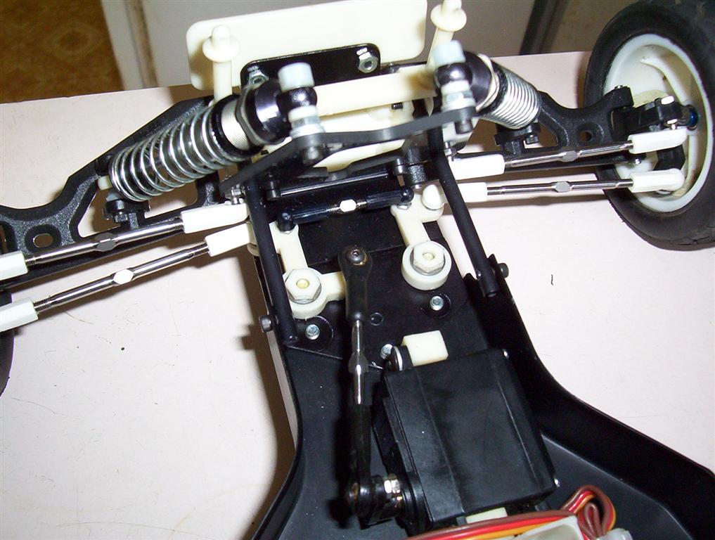

Hi Guys,
I finally got round to replacing the long stock steering bellcranks on my RC10T runner with a set
of re-re worlds bellcranks,
Parts used,
http://www3.towerhobbies.com/cgi-bin/wti0001p?&I=LXEDYT&P=7
3 of these, http://www3.towerhobbies.com/cgi-bin/wti0001p?&I=LX2842&P=7
2 of these, http://www3.towerhobbies.com/cgi-bin/wti0001p?&I=LX3314&P=7
And 4 of these,
http://www.avidrc.com/product/1/bearings/5/14-x-38-x-18-Flanged-Metal-FR168ZZ-bearings.html
Woohoo, It is steering much better no more wobbling and darting around while under power.
Cheers, Dave. :D

Hi Guys,
Here are some pics,
Cheers, Dave.

Whaaat?! how come that conversion worked for you? I had really bad bump-steer issues when I converted mine. Bump steer is when you compress the suspension, the steering changes. It was so bad I converted it back to stock 10T.
Posts: 12214
Has thanked: 1084 times
Been thanked: 3762 times
Re: RC10T with Worlds Steering
It's all about getting the height right. If you had them assembled improperly or didn't have the outer ball ends shimmed with washers those could have contributed, but otherwise it shouldn't have changed anything as far as ball joint height which is where the bump steer would come from

Hi yellowdatsun,
Jeffs right, I assembled the truck with 2 x ASC 6936 #4 aluminium washers per steering block under the ball
stud as per page 6 of the RC10 Worlds manual.
https://www.teamassociated.com/pdf/cars_and_trucks/RC10WC/Worlds_Car/RC10WC-Manual-updated.pdf
Cheers, Dave.
DaveM
Posts: 1254
Has thanked: 727 times
Been thanked: 26 times
Post by DaveM »
Here is Brian Kinwalds Worlds setup,
Under race and vehicle comments, bottom left,
I see he is using 3mm thickness of bump steer washers.
https://www.teamassociated.com/pdf/cars_and_trucks/RC10WC/setup_sheets/RC10_2014_Standard_Kinwald.pdf
Cheers, Dave. :)
