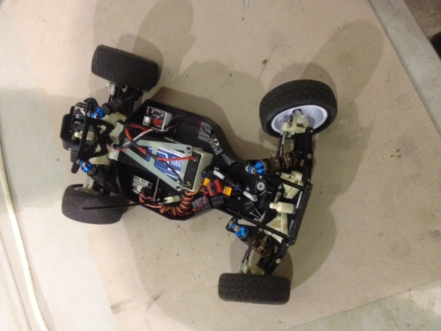

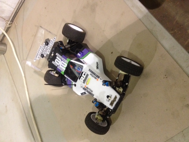

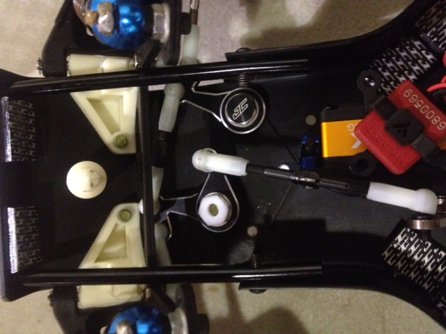

I never had a chance to upload a pic of my car. So this is my Worlds RE RE. It's a very stock and meant to be a car to race here and there and drive laps at the track. So after driving at the track 5 times I have managed to shear the left bell crank screw off due to some crashing and what not. I would not say that things have been significantly over tightened, and I have noticed the screw coming loose a bit after about 4 runs on the track. I was thinking of upgrading these screws to steel or titanium to gain some more strength.
I'm curious if you guys have experienced this problem and have a solutions to offer.

The manual calls for Loctite on them so that should resolve any backing out, bad as far as snapping them, I don't know.

I have had the same problem with shearing off of the screws, a good hit to either wheel while the servo is moving and it's over. I tried some Loctite and it worked a little while, btw how much play do you have in your steering?

As soon as they loosen up they are prone to shearing. The loctite should help keep them planted. Make sure you are using all three screws and check them after a few runs

i suspect since you are running aluminum bell cranks and likely a strong servo, with no servo saver, any impact will definitely increase the chances of damaging the screws. You can exchange them for steel screws, but be aware the damage will travel downstream, to either the servo horn, gears, or mounting tabs.

^agreed... put a servo saver on the servo.

Thanks guys. When I was a teenager I never owned loctite nor applied to to any of the screws. All the green screws seemed to have more "bite" when tightening. A loose screw is definitely going to under go some fatigue loading real quick and with the combo stated it will quickly fail. I will put a servo saver on it for now to try and mitigate this issue and some loctite on the screw as well.
