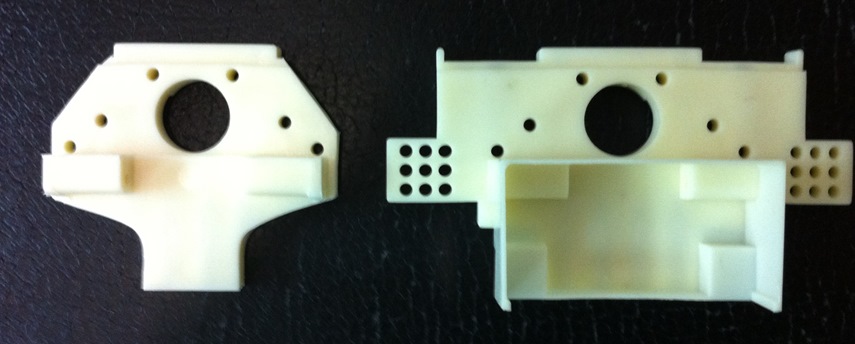

First picture is the trimmed rear bulkhead vs the original. both are NIB condition from AE.
Bottom is my first test using the little 'sprue' between the rear arm mount from Shapeway. See the top piece matched the color 99% perfect. Receipe below :)
Btw, note the 'sprue' at the bottom was crooked? I used that for my fatique test, simply bend it 90 degrees for 10, 20 times, and the darn thing did not break!! The material is TOUGH to break while slightly flexi :D

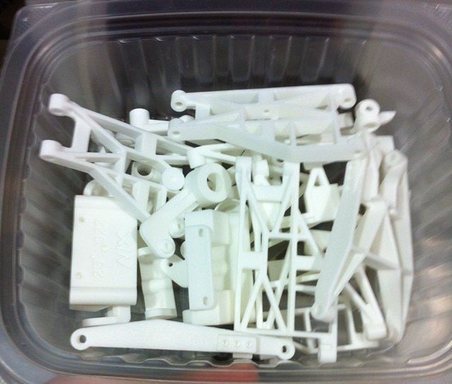

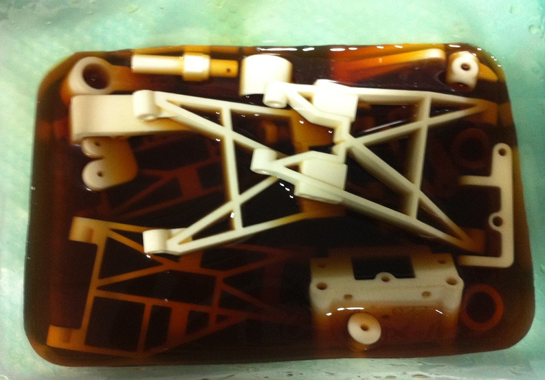

Here is the receipe, this is only cheapo Nescafe :P (not soy sauce :lol: ), the cheapest from any super market shelf.
I used about a teaspoon + a mug of boiling water, exactly the way how one would make a hot morning coffee (sugar and cream optional but I did not as I was not sure if the parts like sugar and cream.... and as the 91 car was meant to be lean and mean, I think they better stay on diet :mrgreen: )

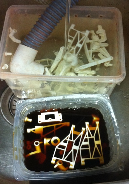

Then simply dip the parts in while it is hot. Leave them there may be all in all 3 minutes, I did not even care to look at the clock, just check about every 30 seconds. Dip them in tap water to check color or stop the process.
I dyed the parts in a small disposable lunch box. Small parts first then the arms and legs after. Reheated the coffee in a microwave when I found it get a little cold, no need to be pipping hot.
Then as a final silly touch, I put all the parts in the lunch box for may be a little more coloring. As you can see in the photo below, some parts are on top some are fully submerged, this way a slight variation in color is obtained and I think it is more 'natural'.
You can see in the last two photos, the original rc10 bulkhead was lost among the stained parts and the Shapeway arms stood out clearly from the dyed parts :)
Can't be easier and cheaper than this. Best of all, can drink the coffee after the job is done :)

My mass production started today :)
Original color
Original color
Mid way through a few mugs of coffee :)
Done!! All in 15 minutes from boiling water to rinse off. AE bulkhead almost lost among the colored 91 parts :)
