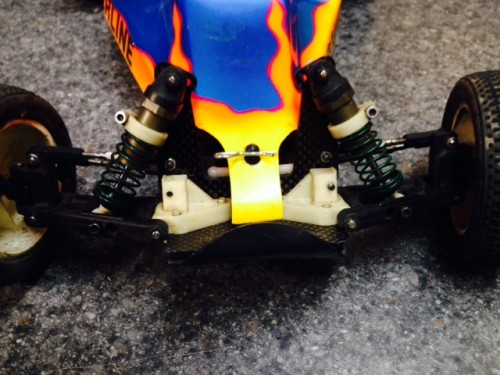

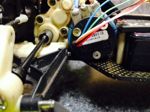

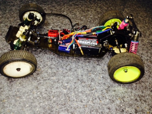

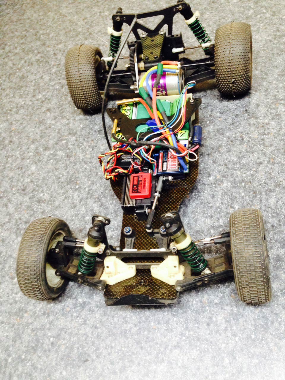

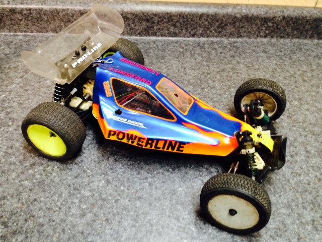

Here's a couple pics of my rc10 Graphite mid with lowered motor and 4th gear added and 69 tooth spur. :D

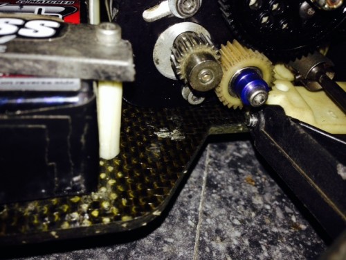

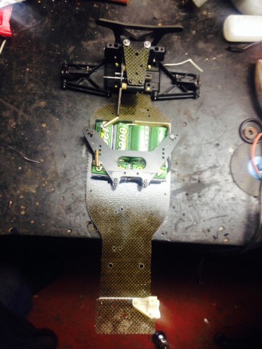

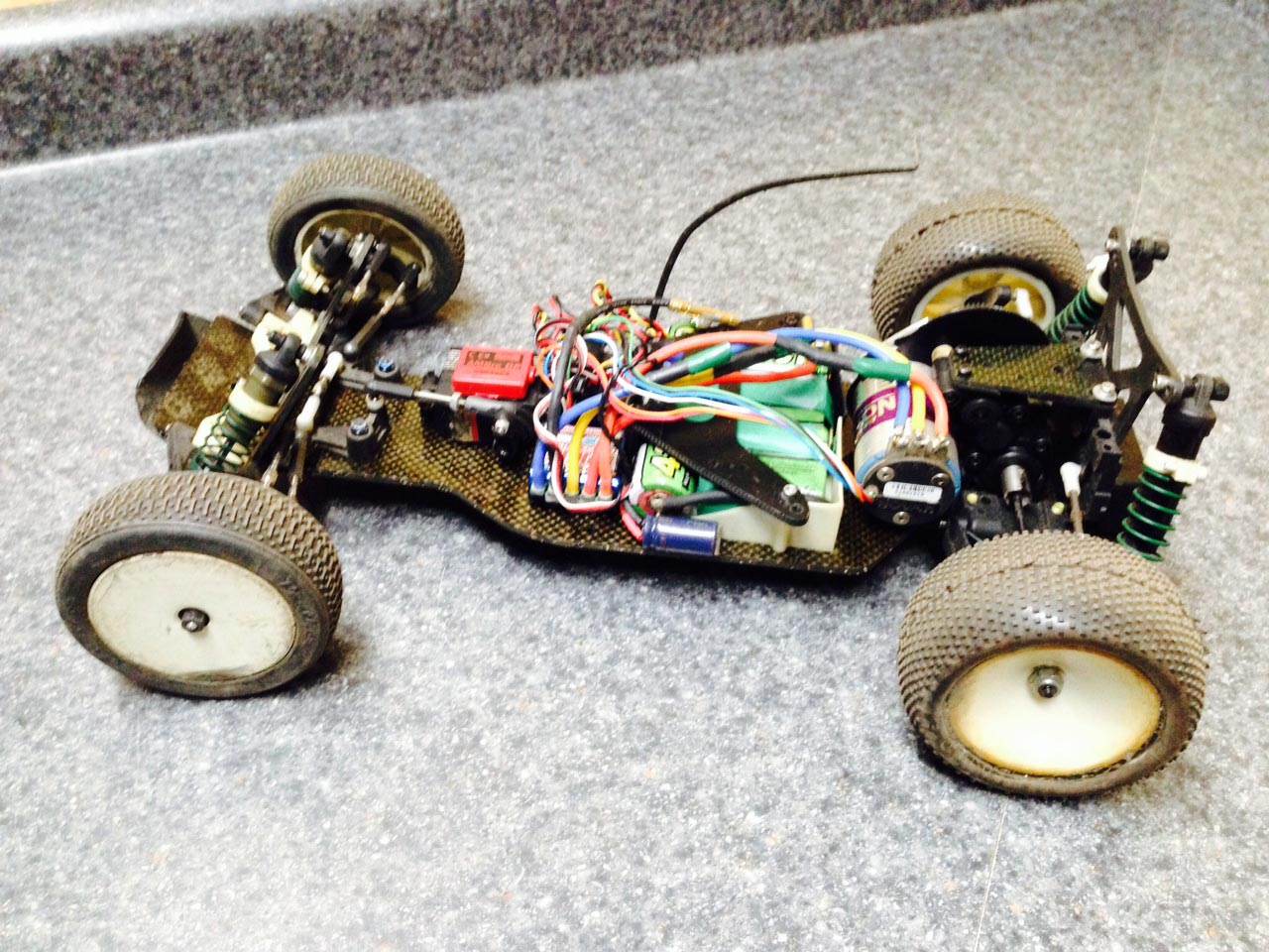

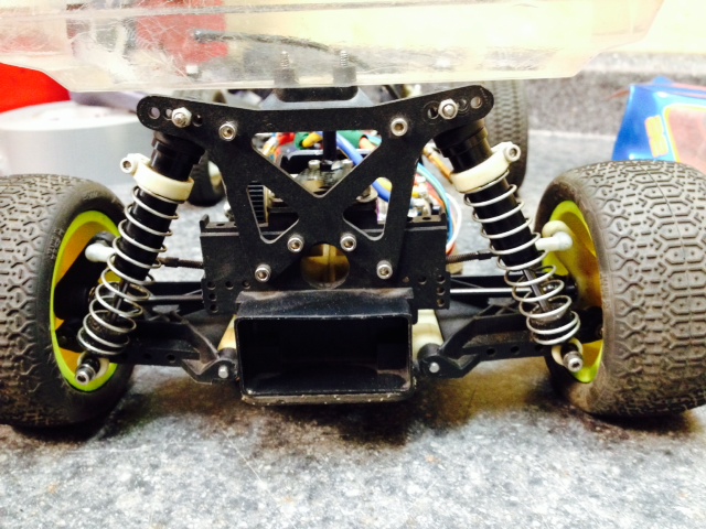

Here's some more pics I found the shock tower broken so I modified a b3 tower and installed it.

Please show some pics of the bottom and explain the layout of any holes you drilled. Thanks!

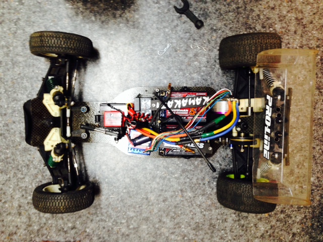

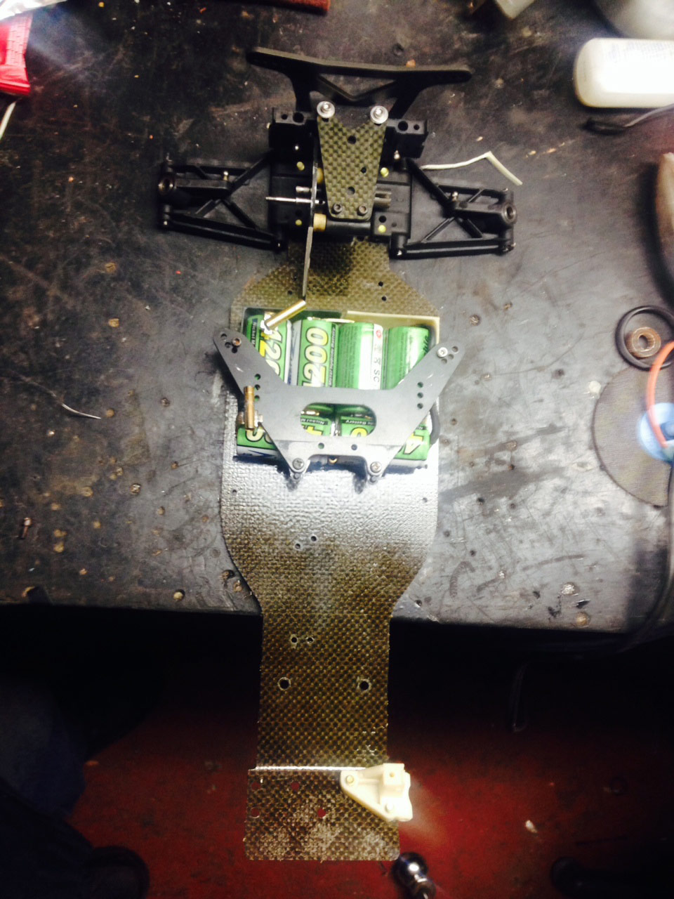

Some early version pics.
I will take pics of the bottom tomorrow.

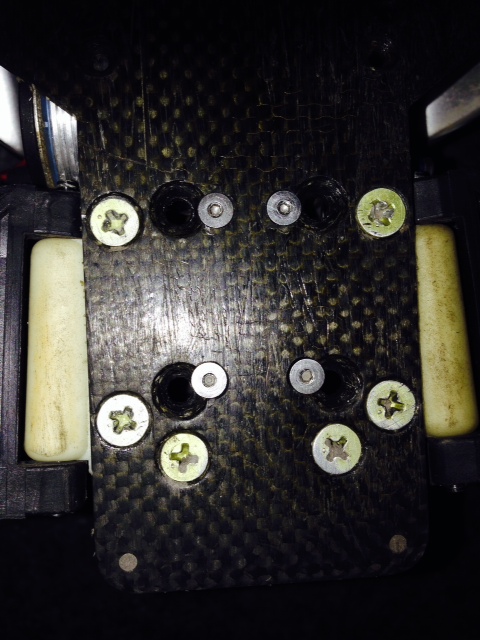

Minter wrote:Please show some pics of the bottom and explain the layout of any holes you drilled. Thanks!
I only had to drill 4 holes for the transmission I used another chassis the line up the holes.
The holes for the bulkhead are slightly off but because the bulkhead has some give it still works.

Post by Minter »
Thanks! Not as complicated as I thought. I was wondering if you had moved the suspension mounts back too in order to extend the wheelbase. Where did you source your transmission? I am still learning about all of the different types of Stealths and their compatibility.

Minter wrote:Thanks! Not as complicated as I thought. I was wondering if you had moved the suspension mounts back too in order to extend the wheelbase. Where did you source your transmission? I am still learning about all of the different types of Stealths and their compatibility.
Cheers
I've had the tranny since the 90's it came out of a gold tub rc10 it's a 2.25 tranny.
