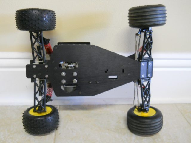

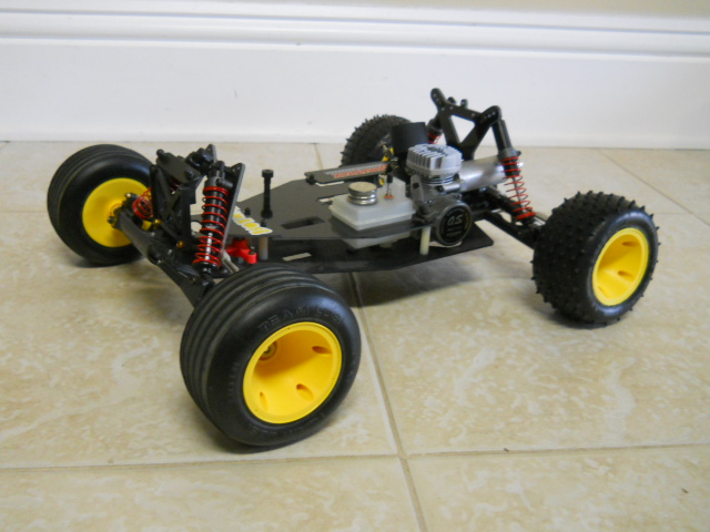

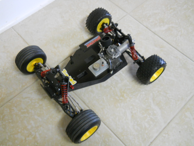

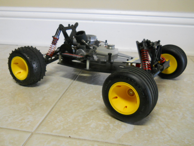

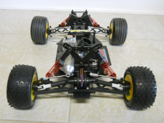

got this from dhood super clean just added the wheels/tires.

Holy hell that's wiiiiiiiiide with the offset wheels :shock:

only about 1 1/2" wider than a stock jrxt.

One issue you might notice...the wider your track gets in relation to your wheelbase, the more twitchy the steering will become. Wider track gives you improved steering, but too much is just as bad as too little. :)

What is that chain drive from?

fredswain wrote:What is that chain drive from?
That's what the kit was supplied with.

The associated Kit reused the stealth diff, everything but the gear which was swapped for the sprocket. I think the LXT version used the stock losi diff as well, with a different sprocket than the Associated.

Coelacanth wrote:One issue you might notice...the wider your track gets in relation to your wheelbase, the more twitchy the steering will become. Wider track gives you improved steering, but too much is just as bad as too little. :)
it steers great on my shelf lol :lol:
